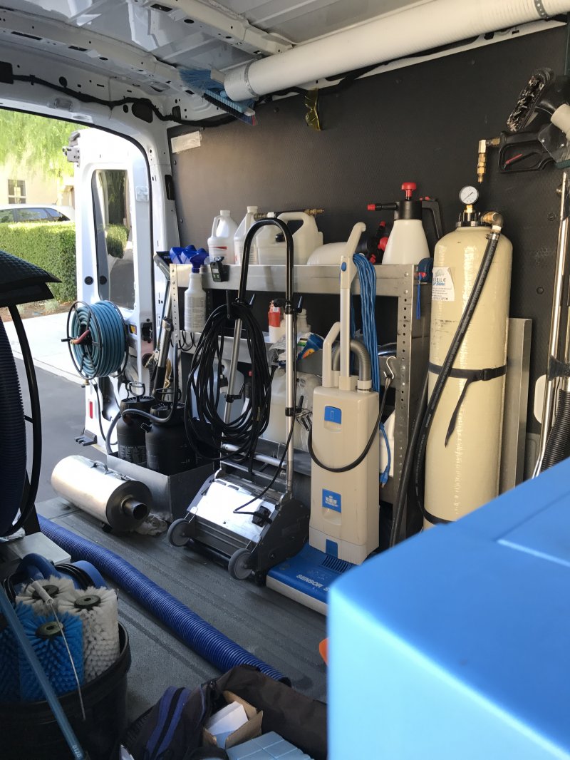

Just curious if anyone here has installed this into a long wheel base. I'm so tired of the old connect the hose to the house thing, and feel I could save some time. There are so many times when their spigot is stripped, or a plastic pvc type jimmy rig. I'm in sunny so cal so no need to worry about freezing.

Pro1200 se with a 120 gallon on board fresh water is awesome, I do run out during the day and still hook direct, but having the auto real for the vac hose is sweet.
I don't know how much time I'm saving we're taking one hose to hook up to start.
But it's still nice for those situations there's no water.

I wouldn't be without on board water. One van has a similar tank as the one your looking at and the other van has dual Prochem tanks. All that water on one side of the van makes for an uneven ride. The dual tanks make for a great ride but uses up a lot of room. Both of these vans are one ton GMs.

We had 2 vans on a large DNR job in Northern MN Friday....2 SS Super Spinner Zippers...each van with 110 fresh water tank...about 2250 sq feet of cleaning each...and each van still had over a quarter tank of fresh water left....Rockin and Rolling....makin the money! :rockon:

We are due for another new TM next year, needing onboard water is one of the reasons I don't think we are going to steer away from another new CDS 4.8 w/ the salsa. You just can't get the same amount of rear storage (we need the space, our guys bring rugs back like crazy and do daytime cimexing on cgd weekly) and carry 125gal of fresh water in almost any other setup.
