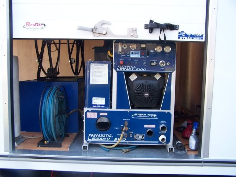

For us with only one 50' 2.5 it's a piece of cake. The 2.5 goes on the reel last, so it comes off first. We grab the 2.5, walk out 50 hook it back up to the TM then just pull the rest of the reel, kinda backwards but really fast and efficient.
Definately a noticeable improvement.
For those with a Power Matic it's an easy upgrade, already plumbed for the 2.5
AL

Ok guys lets see some pictures of all this big hose, and the inside of the trucks. Thanks.
