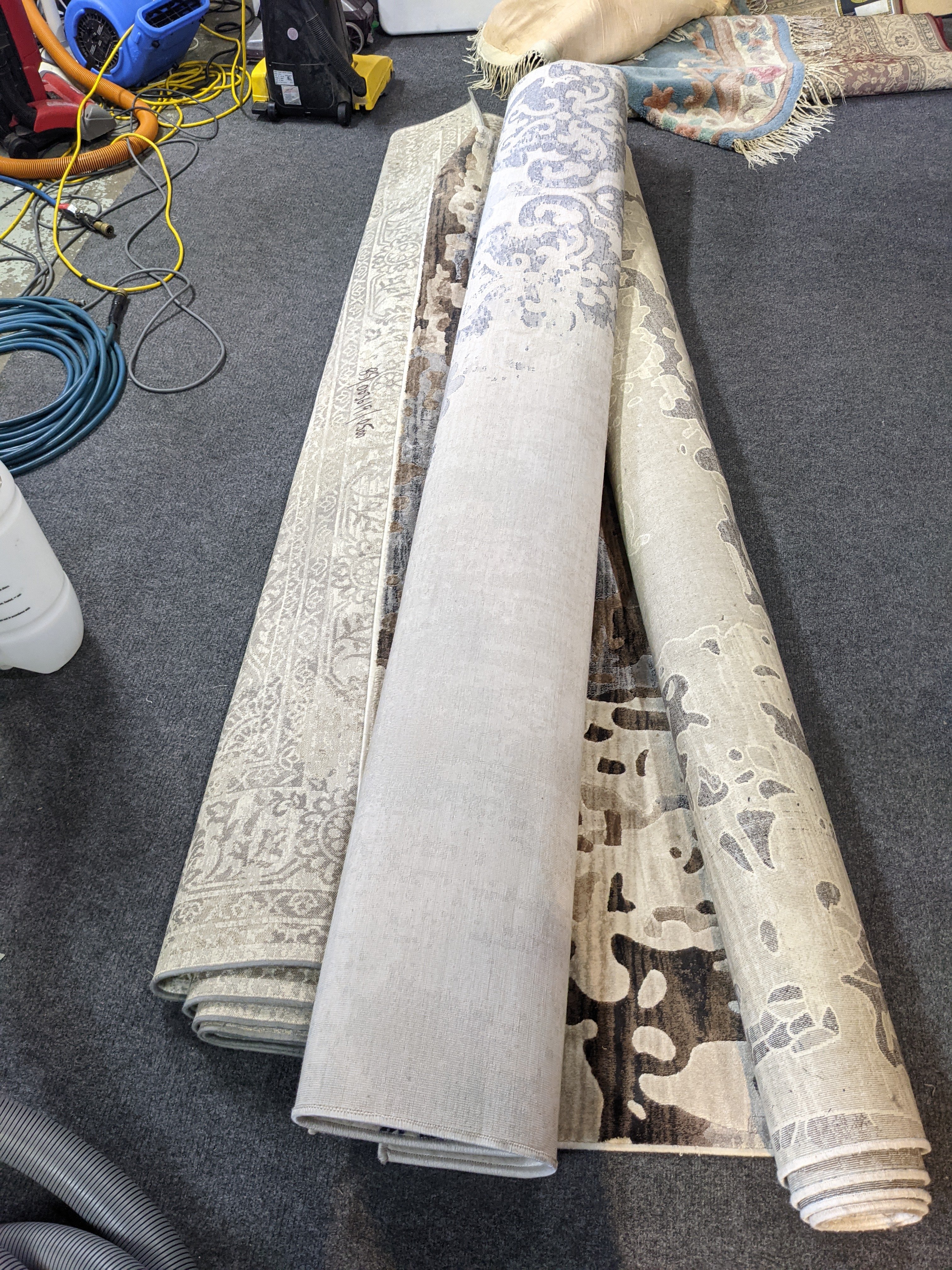

Just picked up 3-8x10 rugs. 1 is polypropylene the other 2 are viscose. Either have to learn to clean them or do without.

The poly poses on problem. Use cold water on the viscose and No scrubbing.
Are you pit washing them or surface cleaning them? Do you it wash poly?

Replacement on the polypropylene is around $400-$450. The viscose is sometimes a little more depending on the quality. These are cheaper ones but some comparable size viscose rugs can range upwards of $6000.

We do a little more than that. Might not be doing full immersion but I dust and vacuum both sides, prespray and shampoo with a 175, rinse and extract, then hang to dry. Treat any special problems such as urine or other stains. It's not a simple spray and suck.

Full flush, Cimex the poly. Viscose -Slowly extract with few passes as possible. Might use rug sucker to flush it more. Or DryEze Rover to extract.
Hang poly- dry flat Viscose.

I use the 175 on viscose now. Using Chemax Rayon rug shampoo. Prespray it first, then hit it with a higher concentration in the shampoo tank. Provides enough lubrication so it doesn't damage the fiber. I foam it all up then rinse and extract and hang to dry. Doesn't hurt the viscose as long as you do a good job extracting. I speed dry with flood fans and a dehumidifier.
