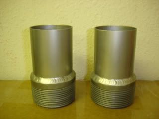

I don't know anything about welding but I was under the impression that you should weld the same metals together. My local plumbing doesn't have anything that large. I did find a supplier for aluminum pipe and fittings but I figured that somebody would actually have the different plumbing for each of the blower sizes making it a little easier.
Gene

Larry they are just standard but I wanted aluminum because it would be easier to weld to aluminum.They are 4" npt. I found what I wanted I just though a carpet cleaning supplier would have the parts and I would give them my money. My local did so I tried here.
Gene

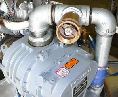

I could have sworn all the Thermalwaves I've seen had reduced plumbing, form 4" to 3", are you sure your plumbing is 4" NPT?

You are almost right. Mine goes from 4 to 3.5. Why not just leave it a straight 4". I'm not an engineer ,( I don't have any napkins) just a student of common sense.
Larry I noticed the picture you posted showed the same thing. Why not just use the larger pipe all the way thru. The cost difference would be small but I would think the benefiyts would be significent. Like I said before I'm not an engineer just a student of common sense

Actually that SHARP 90 going from blower to tank at the releif valve is just as bad as the hose restriction.

If you look close on the TNT pictured, you will see that exact straight 2.5 nipple coming out of the blower, some TM mfgs. think they cost a bit much, but I wanted it super thin walled for maximum airflow.
You are right about the hard 90 on my machine. I can see it would be a little restrictive. I going to change the connection at the tank so I can clean my filters easier. It's starting to hurt my wrists twisting that hose back to get at them. That hard 90 will be gone.

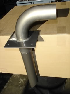

The bottom of your 3" Stack inside the box, look at how close it is to the bottom of the box, it's too close, cut a 45 deg angle in the pipe like the bottom of this custom piece:

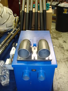

Greenie,
Here is the new filter box design.I'll post it in X-ray so you can see the inside. I went straight 4 and 2 .2.5's It should be an improvement.
