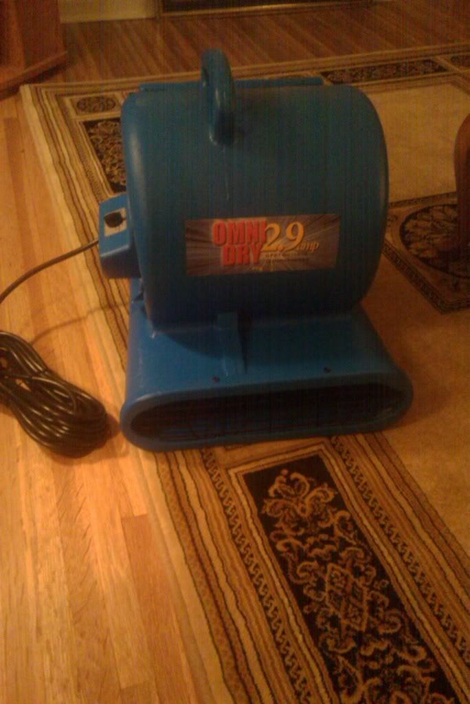

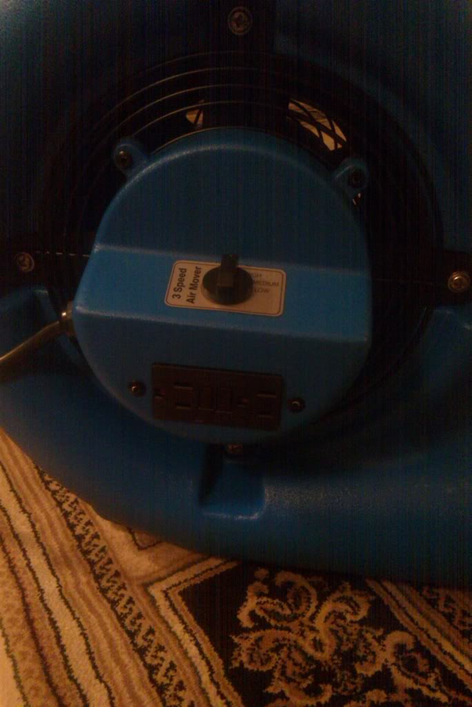

I just got 10 new air movers in today. I am very impressed with the new Hydro Force air mover. It draws 2.3 amps and can be chained together. The first thing I noticed was it is much lighter and a little smaller. The performance is good as well for a three speed 1/3 hp. I will post a pic in a minute.

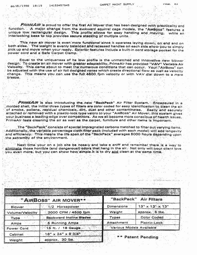

I have pictures of these "new" air movers and a product that was unsuccessfully introduced 12 years ago that was just like it. Nothing new here folks more smoke and mirrors. Once I figure out how to post pictures again (Mike ran me through this one time but I can't remember the details) I'll let people see. If someone wants to help send me a email at billb@legendbrands.net and I'll send the pictures so all can see both.

Here's some pics of my new air movers. I picked up 10 of them. They only weigh 27 pounds. My other air movers weigh probably 50-60 pounds. Since they are smaller and weigh less I will take them in the home on more jobs. They put out 1150 cfm. It's not the strongest fan, but will serve great for rug cleaning.
Sep 7, 2008
3,797
I was in a bind and literally could not find air movers anywhere. Three local suppliers told me they had some after market or not really what I was looking for units coming in the next day etc. With tax they wanted 225-250 each. I called interlink supply and got these for 169 with free shipping. :D Well 1800 for fans is not great, but I can use them for all sorts of things.

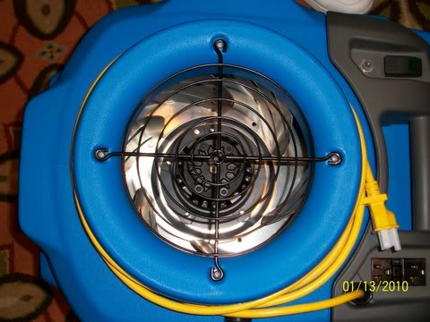

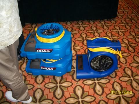

I'm sure they'll cost $1000 a piece and I'm sure there will be a handful that will buy them and tell us price doesn't matter and we are all hacks for not having them. Then they'll be on ebay for sale.
Seriously, if that is truly the airmover in the pics above, ??.
He said three something, I can't remember, under $400.00 dollars.
Man those are weird!
116,999
Looks dangerous to fingers.
That top grill needs to be much tighter

No the one with the heater is the older version. The reason that there isn't an airmover/heater combo like you’re looking for is because of the electrical wattage/amperage requirements. Since you can calculate the amp requirements of an electrically powered product by dividing the wattage by the voltage and you either have 15 amp (12 amp continuous duty) or 20 amp (16 amp continuous duty) circuits.
So let’s take a simple 1500 watt heater like you use in your van during the winter that moves about 150 CFM. 1500 watts ÷ 120 volts =12.5 Amps or all the available electricity on a typical house circuit. Because the more air you move across a heater the more electricity required exponentially you just can’t produce an air mover like our industry needs to dry carpets etc. While heating a building component will help it release moisture faster you still need a volume of air at a significant velocity to dry fast.
Hope I made this clear and didn't confuse everyone. Thats one of the reasons the PrimeAir product didn't work well but not the only one. More on that some other time.

R&D steve. The Triad is 1.48 amps 2700cfm a distributor with no moral compass sent bill those pics. The Triad will be coming out in 1-2 weeks. There is way more to the triad and how it integrates with the rest of the restoration line but until everything is right they won't be realeased. The Triad has been in development for many years. Anyone can make a snail airmover Prochem choose to start from scratch and spent the money to create something better.
Steve You'll be able to take a couple out on a couple jobs once they come in and you can decide for yourself.

that sounds very exciting thanks for piping in john, that sounds like a ton of performance for the amps used I can't wait to check one out. It looks like a totally different type of fan unit that what I have seen, so maybe it does offer something that bill is overlooking.
one concern I have is the units look a little small, I have a slight worry it could be like the little small box ozone machines, they put out more ozone than the much larger machines that in some case take 2 guys to carry in the home, however to the customer that big machine is really doing somethng, kinda like the vortex mentality a few guys on here have. if the machine is too small looking the customer might question the value in how much they are paying for something. any ways that may be a mute point anyways.

2700cfm?
Given what appears to be a 4" x 12" snout opening it would need to flow air at the rate of 8100fpm to yield that.
Has anyone measured?
Thanks,
Lee
ps. I guessing a gross overstatement of flow?
