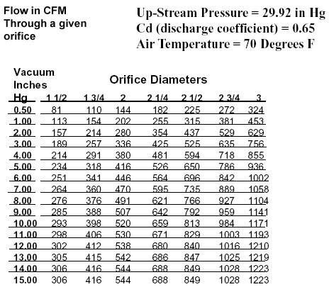

It is a little worse than that....
Look what actually happens at about 13" of lift. The CFM rise flattens out. At anything over 15", the CFM rises insignificantly.
The hose length will act as further restriction, potentially lowering the available CFM for the smaller wand orifice.
Source: Gast Manufacturing
