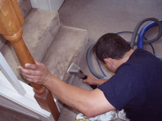

Tell me how you handle filthy staircases.

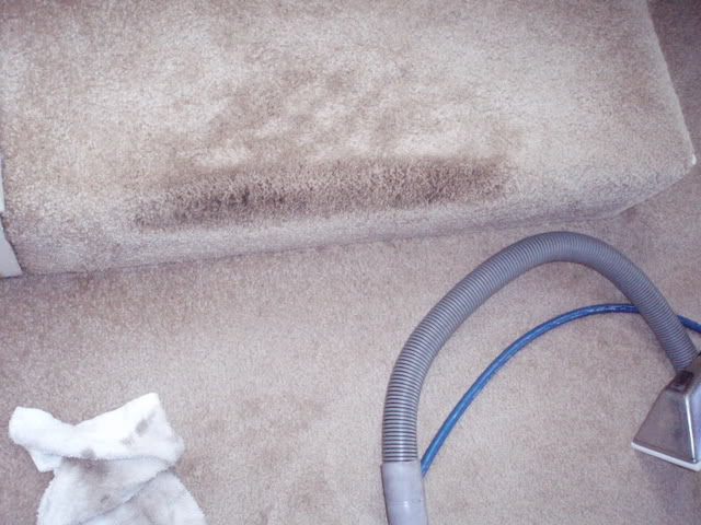

I had one today that pitched pretty bad.
Cleaned only a few times in 20 years.
We vacuumed, pre sprayed, granditated and V rinsed but the bull nose still looked bad.

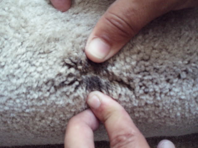

I parted the fibers to find thick gooey crud surrounding clumps of fibers. No real pattern to the cruddy areas but each step had a few goo gobs.
Mrs Piftleton nor I had any idea how this happened.

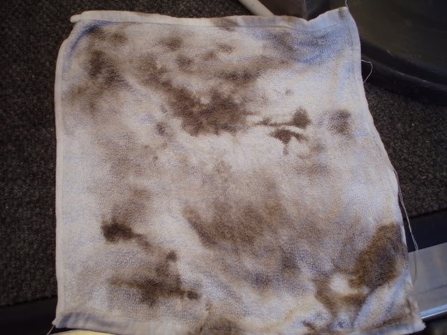

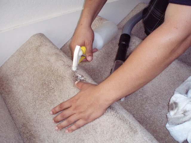

I tried spraying ENC and toweling it off. I stuck my fingers in there real
good and scrubbed like hell but all that did was spread it around. We are talking thick sticky mud here.
So I attached the PC hand tool and cranked up the pressure a bit and basically pressure washed out the goo.
I tired to imagine using one of the mini pad machines to do this and had to laugh. No way.
Flush baby FLUSH!!!!!
Took way too long but we got it looking pretty good.
Twenty years of wear but she was stoked.
