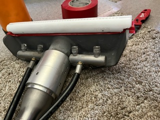

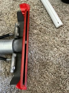

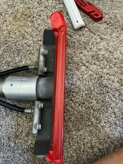

Here's a packed up Bonzer ready to ship to Canada or worldwide .

Is this available?

Thanks for response. Is this swivel, or not?
Cheers
No, it's not swivel. It's the one with seven jets( you can close two opposing jets)everything else is similar; 2" tube, front and rear glide. I just want to point out that specs state 17 lbs., my wand weighs 27 lb.
I assume ( by greeting)that you're located in Australia. I shipped to Australia; it's doable, but not as simple.
