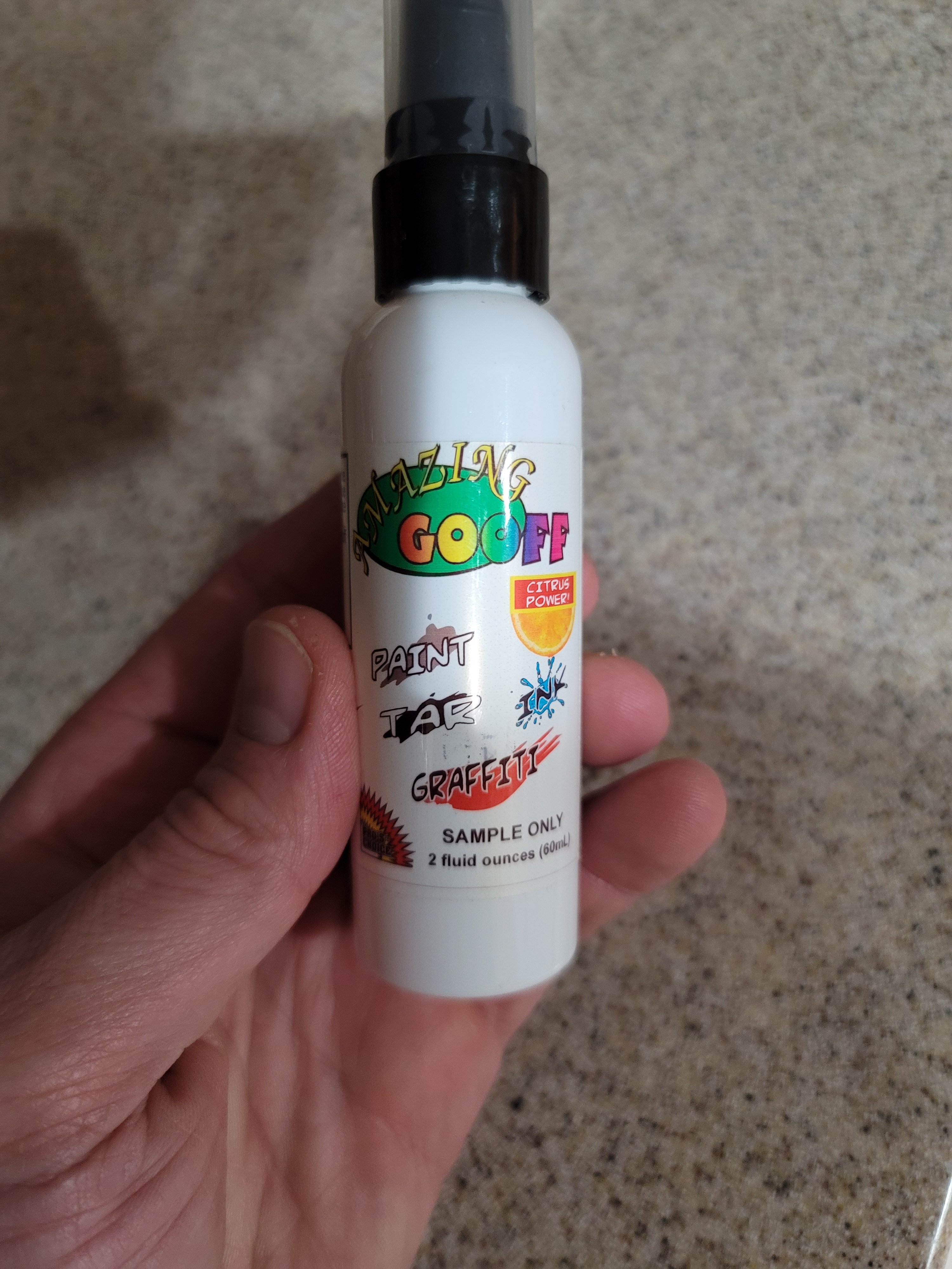

Have you tried this Goof Off? May be an option if you don't want to invest in soda blaster. I believe they make larger sizes. This is just a sample I received.

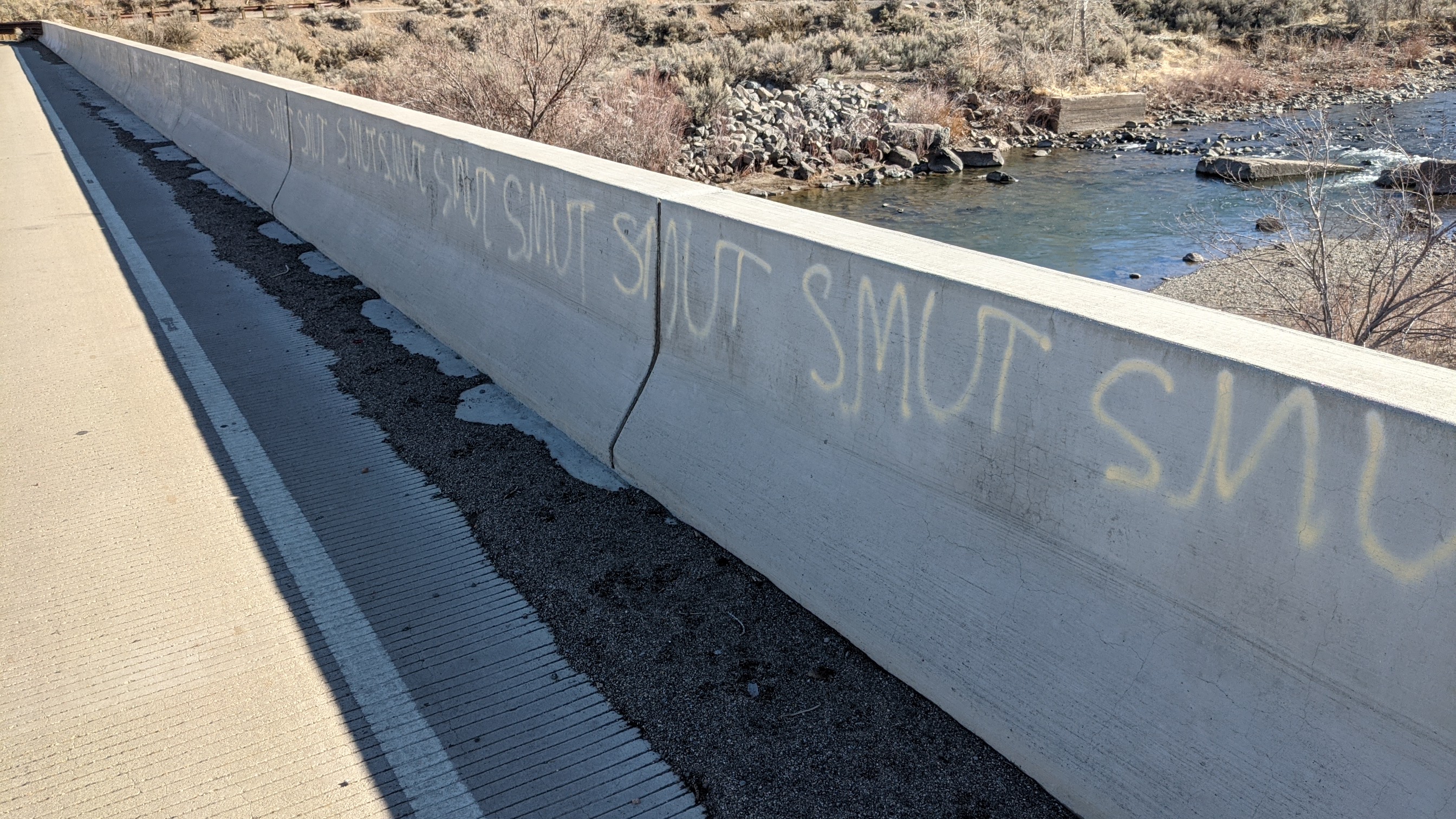

There is a stream under that bridge, no soda blasting or sand blasting. Trout waters are guarded like the border used to be.

There are loads of "natural" and "biodegradable" products that will melt graffiti off of bare concrete or brick so you can pressure wash it away - some of them have DOT approval.
Set up a sock dam and pump the waste water into a tank. Lots of guys make a living doing this AND already work with government agencies.

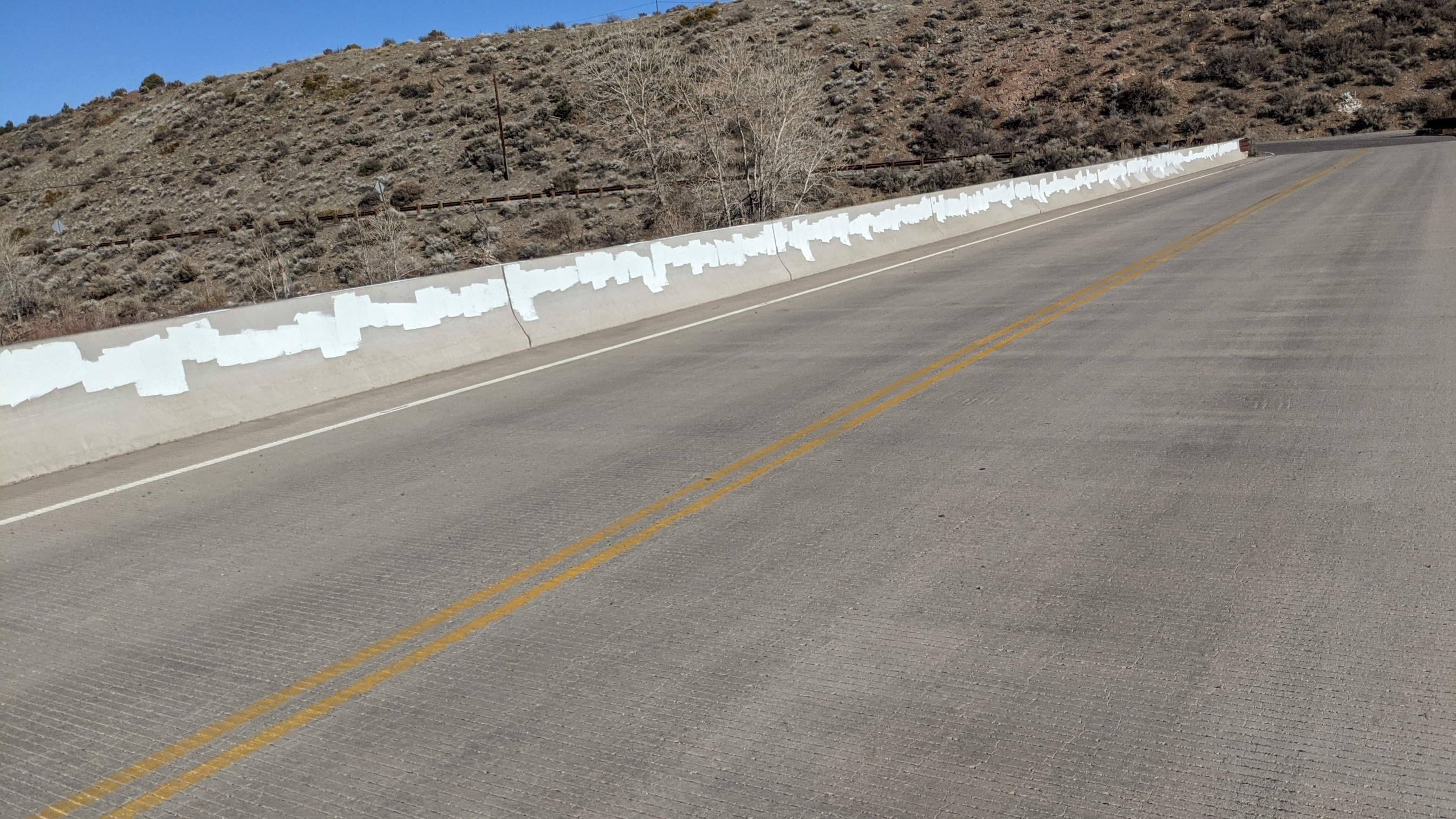

Imagine how quick and inexpensive it would be to spray a yellow line across the barriers
if it is destined to happen again by the local ’artists’ there is virtually no permanent solution
so why not choose the least damaging to the concrete and the surrounding habitat and wallet
this poorly execuTed paint job looks like it is covering “ Marty is an asshole” multiple times
