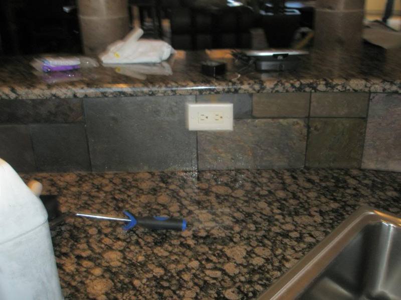

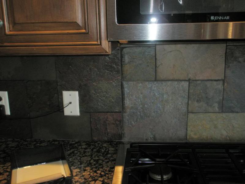

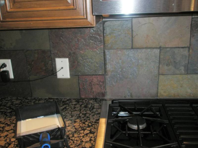

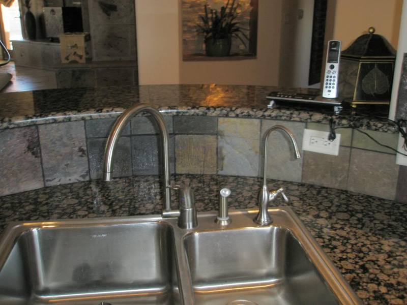

Are you enhancing much?
116,999
Stone or grout?
If so, due yourself a fave and keep a can of Acetone on your truck to use to remove the enhancer from where it doesn't belong.
Just get it quick before it sets up.

yes
116,999
I can't think of a stone that responds better to enhancing than Slate.
