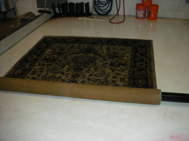

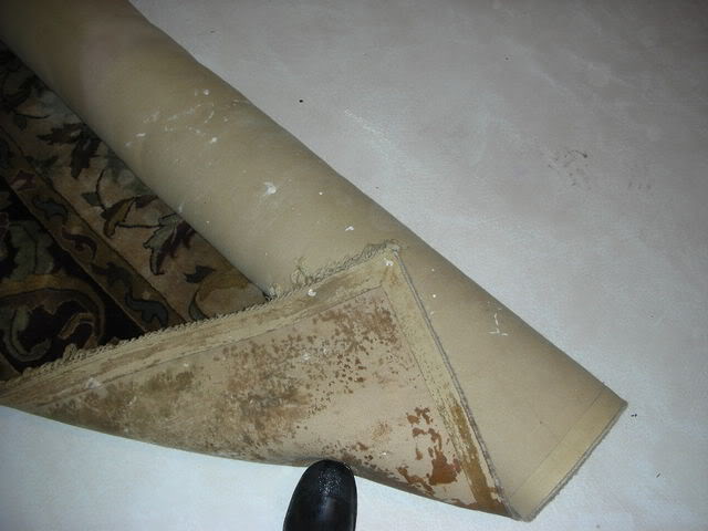

most can be washed without problems if the backing is dry brittle and falling apart that’s a problem you need to make the owner aware mikey BEFORE you clean it!
they need to be rolled on a tube and stood on end to evacuate as much moisture as possible for 3-4 hours and then rolled out flat at the end of the day face up NO FANS next moring hang to dry the rest of the way

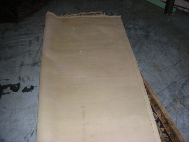

Finished rug backing is fine a little water spotting it's not falling apart or seperating ..she didn’t pay for me to remove the paint off the back so i didn’t

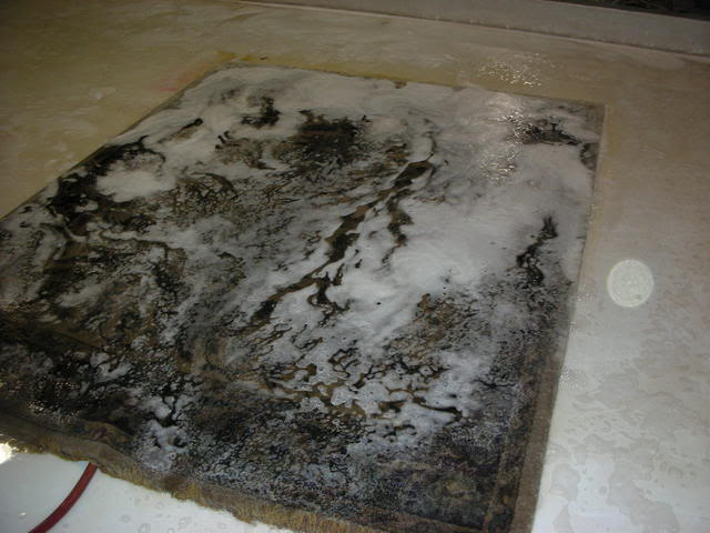

I lay those on the driveway and hose them down. Soap it up, scrub and hose it down again. Extract and put a fan or two under and on it and let it dry.
If the birds don't poop on it, it's good to go.
