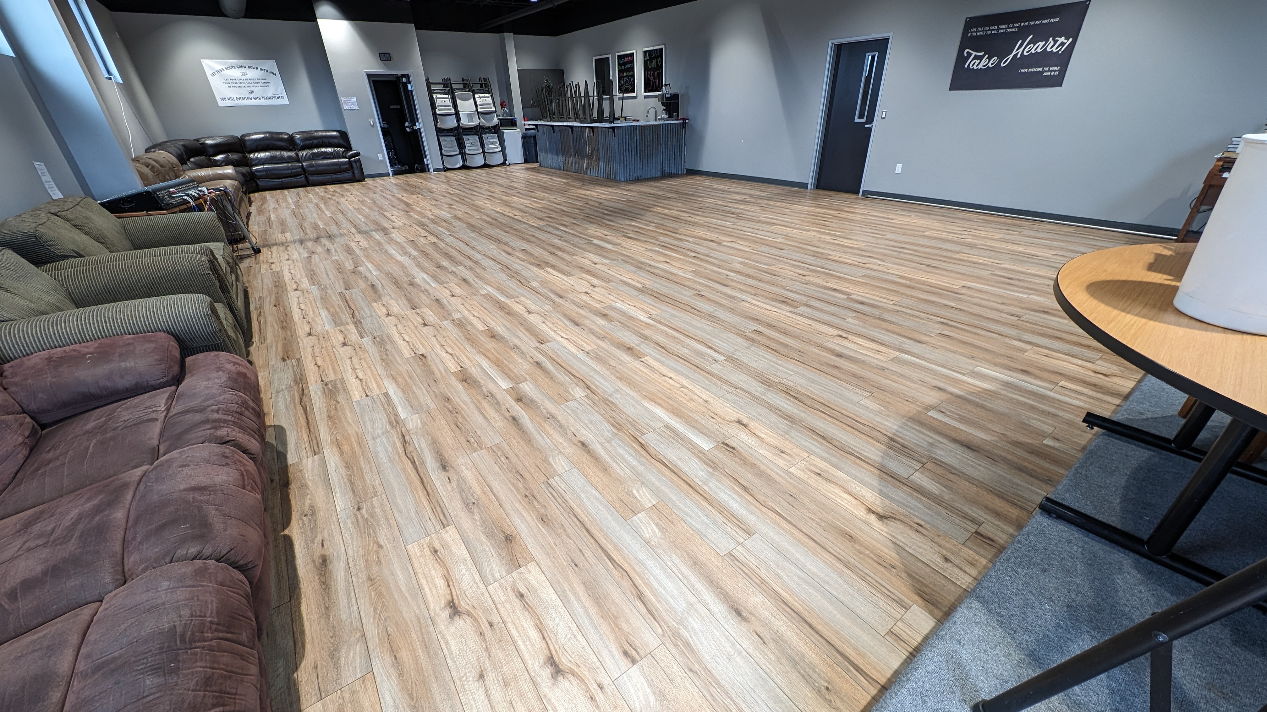

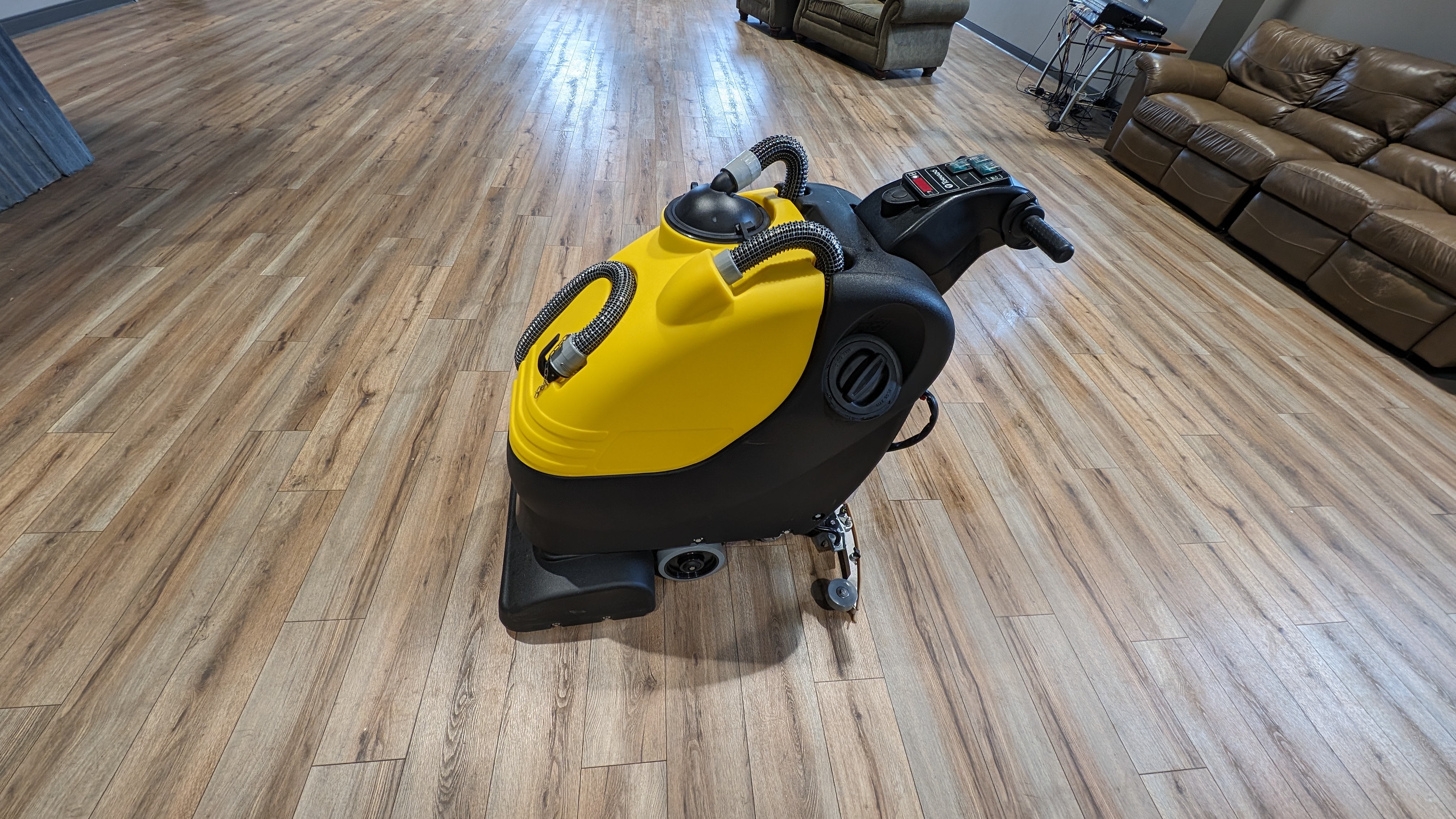

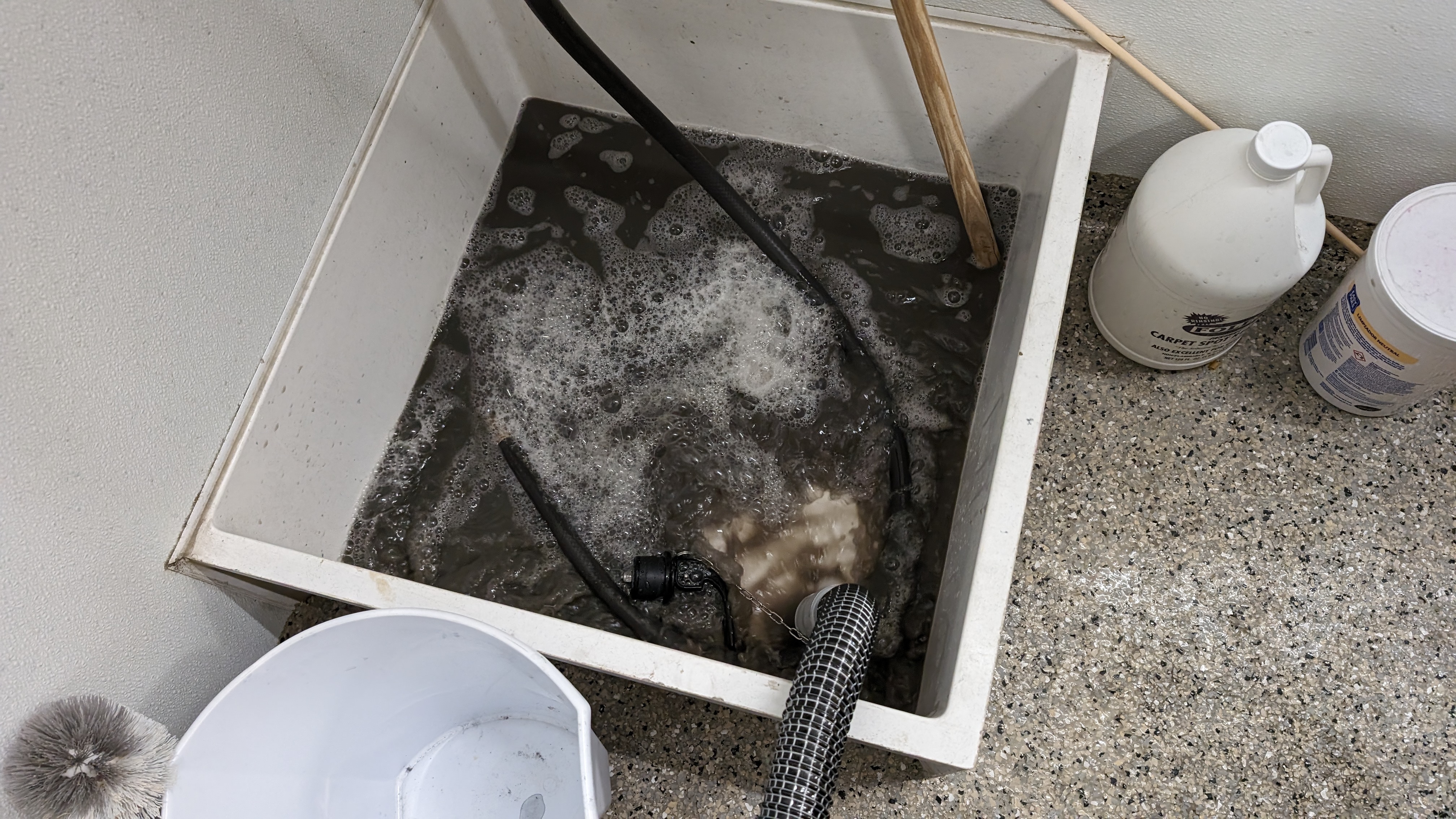

This LVP floor at my church could have been "wanded" but I chose to try their walk behind for the sake of evaluating the process.
Edges, nooks, around furniture, corners all needed cleaning by hand and the whole project took PXL_20240122_175642256.jpgPXL_20240122_182712987.jpgPXL_20240122_195553106.jpgtwice as long as I if had used my truck out and HS wand..

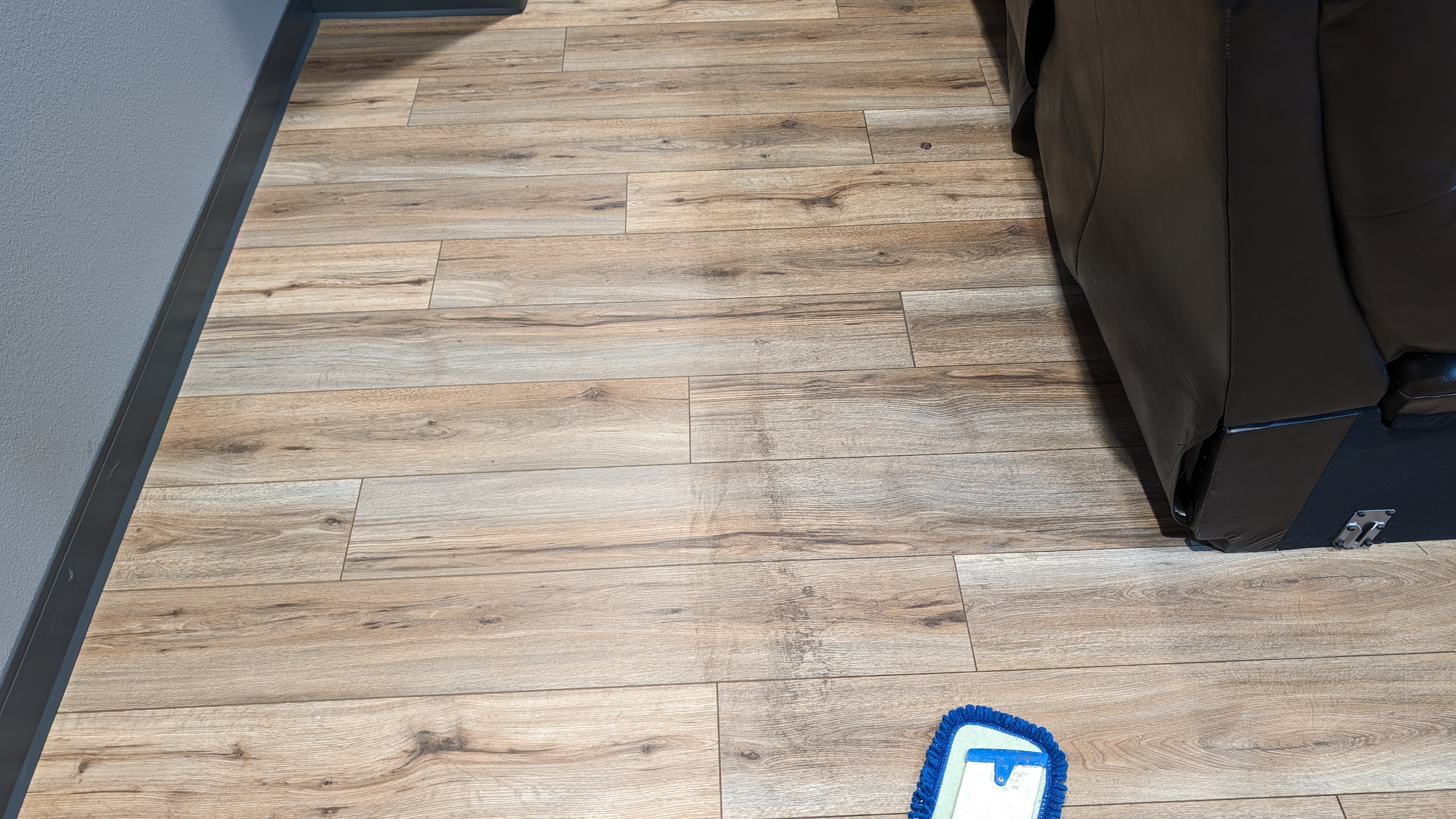

But as you can see, it worked well when I pre-moped an area with a heavy alkaline.. PXL_20240122_200547804.jpg

You need more practice! A foot on your mop will get the corners just fine. Along the edges as well if needed. Your scrubber looks to be a cylindrical brush model as well. They usually don’t have the head pressure to do as well as regular auto scrubber.
