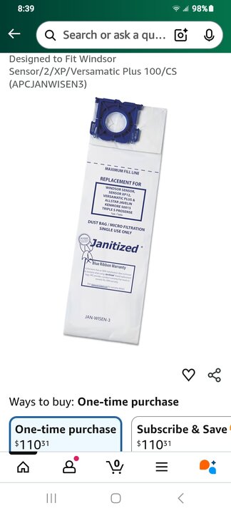

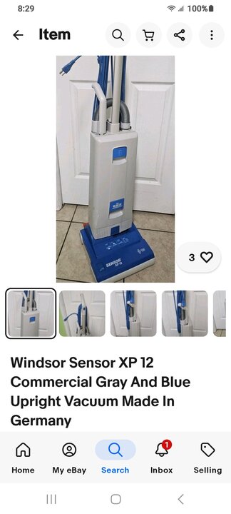

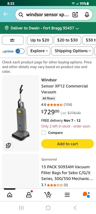

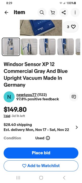

The windsor's xp12 like i have are around 700.00 new now they are very very well built. Bags run between .99 on the low end and 2.29 each for the best . I use janitized and buy by the case 1/2 off @ 1.10 each. If you look on ebay there's some great deals on used windsors. I've found that like a lot of commercial equipment its eighter totally worn out or like new Barely Used. I only bid on things like that if theres pictures of exact item im bidding on and have had really good luck. An added note: on this vacuum, the brush itself does not move rather a wheel raises and lowers to set the brush height based on the amp draw of the brush motor.
View attachment 133023 View attachment 133024 View attachment 133025 View attachment 133026
