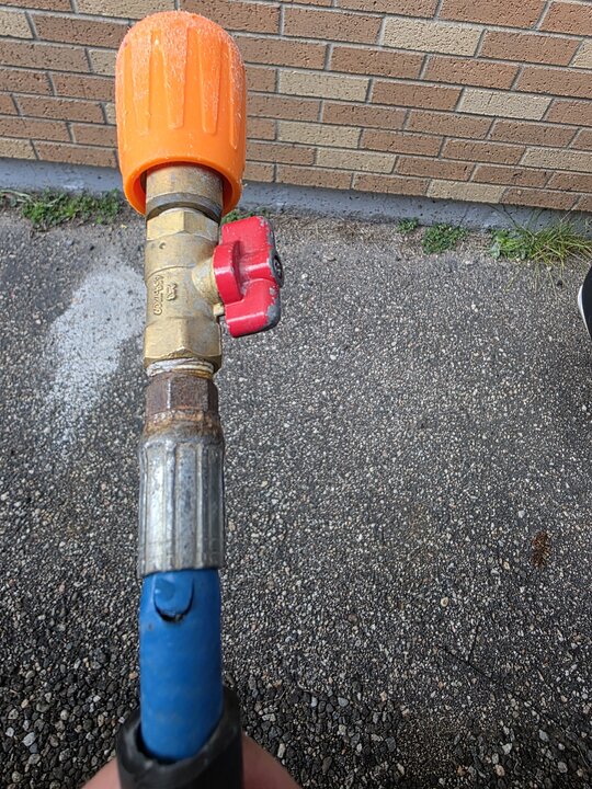

What is the best solution line these days? I'm not worried about cost. I just want something with the least amount of memory, doesn't bleed on the carpet, and can take high heat.
Friday I was doing a post construction clean at a historical building that was being remodeled and my line blew right at my QC on/off valve. I'm glad I wasn't using high heat because it sprayed me right in the face, which was still actually pretty dang hot.

I see ya got a wanders valve on that hose. My advice is, STAY AWAY FROM THEIR HOSES!!! Goodyear neptune 3000 has been my go to for decades

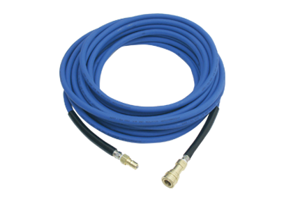

30142 Carpet Cleaning Hose for Hot and Cold Water Use, 3000 PSI, 1/4 Inch by 100 Feet, Blue​
Bought this cheep hose on Amazon 4 years ago. Best hose I ever used. I bought 2 more for when it finally crapped out but its still going strong. had it cut down from 100 to 50.

Hand coiled Parkers is my favorite..
I currently use that OEM hose blue in color and I believe Cobb's sold it at one point.. I bought it off amazon.. Decent hose for the price but it's grabby as in doesn't slide well..

Zero complaints so far
Westpak has sold it for decades with no chronic issues.

I've used it for years as long as your machine isn't a flame thrower, I get 2 years on avg, and then a small pin hole leak and I replace it.
Never had one explode like good year
Ps 100 ft for under a $100 on Amazon.
Same stuff Cobbs and bristor sold blue OEM.
It is a little stiff at first but when on use will relax.

You guys must be using piss warm water because my titan575 was too hot for that drinking straw of a hose. I went through several of them when I experimented with it. Waste of money

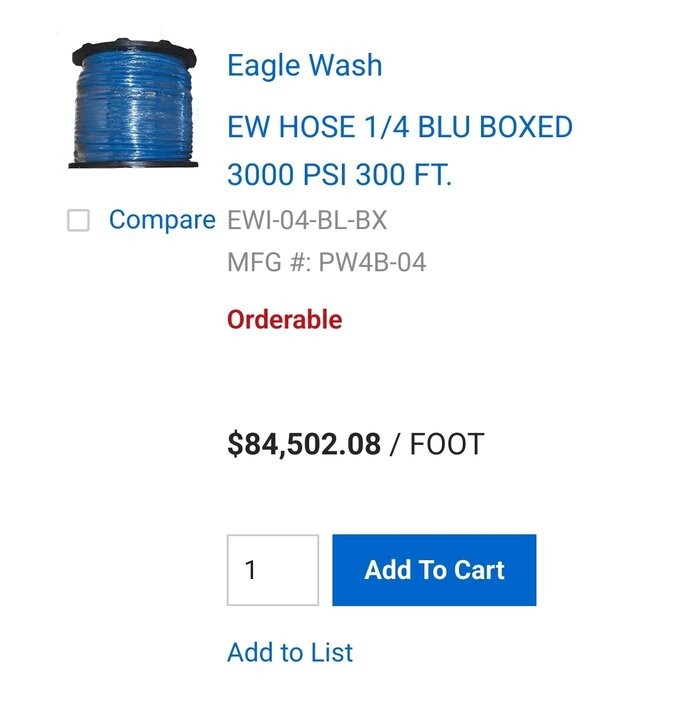

I just learned mine is made by Eagle Wash. Wow, this thing really must be the best solution hose ever. It's over $80k/foot 🫨 I'll need to pull out a loan when it's time to replace it.

Any issues with bleeding on these? When is your upholstery tool going to be for sale?

no bleeding
