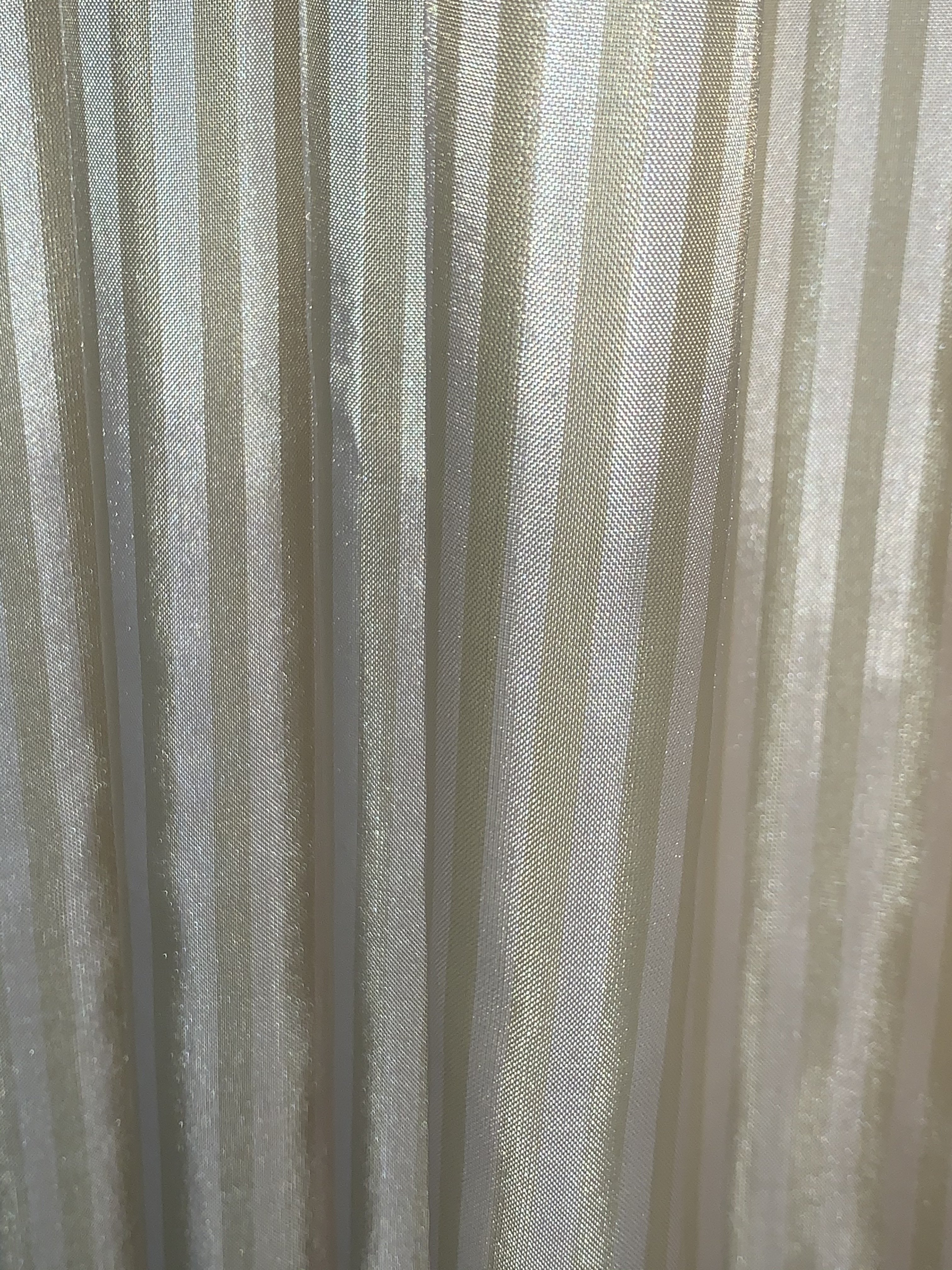

I was thinking of just vacuuming these drapes on low suction. I might lightly spray with a rinse spray then suck up. Their not that dirty. How would you do it? And do you have any tips?

Vacuum first then odorless mineral spirits on spots. OMS are cheap, $17 at home depot. lightly wipe with white towel.
Vacuum with a tool wrapped with plastic screen and then go home. Draperies often contain fibers no one would use in upholstery fabric
Well, you could check the tag to see if they're washable, since they have the look of hotel draperies. If you're dying to be a hero, take them to a drapery cleaner and charge for your pick up and delivery time. < This is so you don't end up buying them.

Any spotsyou clean will look different than the area you only vacuum.
I would only vacuum.
Drapes have years of pollution collected on them like carpet but the materials are not as durable. You can't just wipe them off and get them clean.
