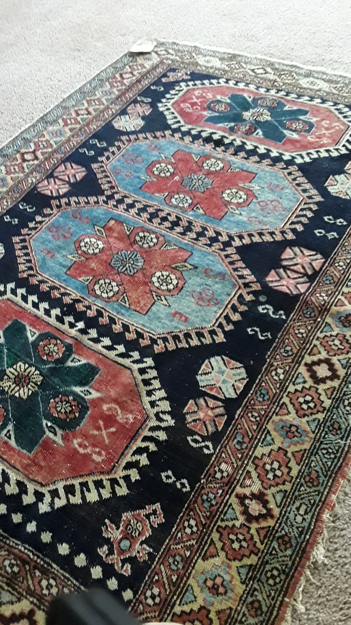

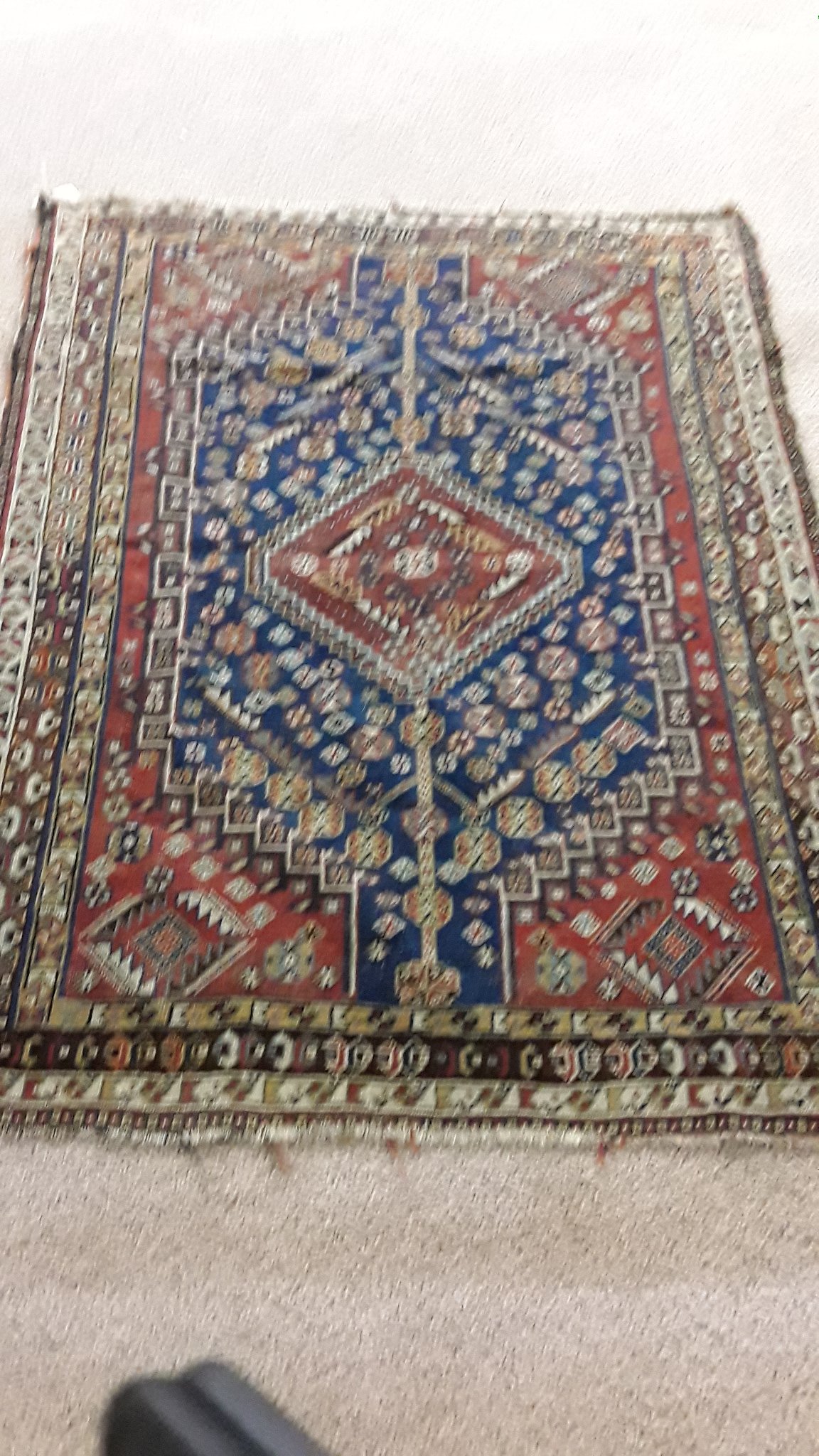

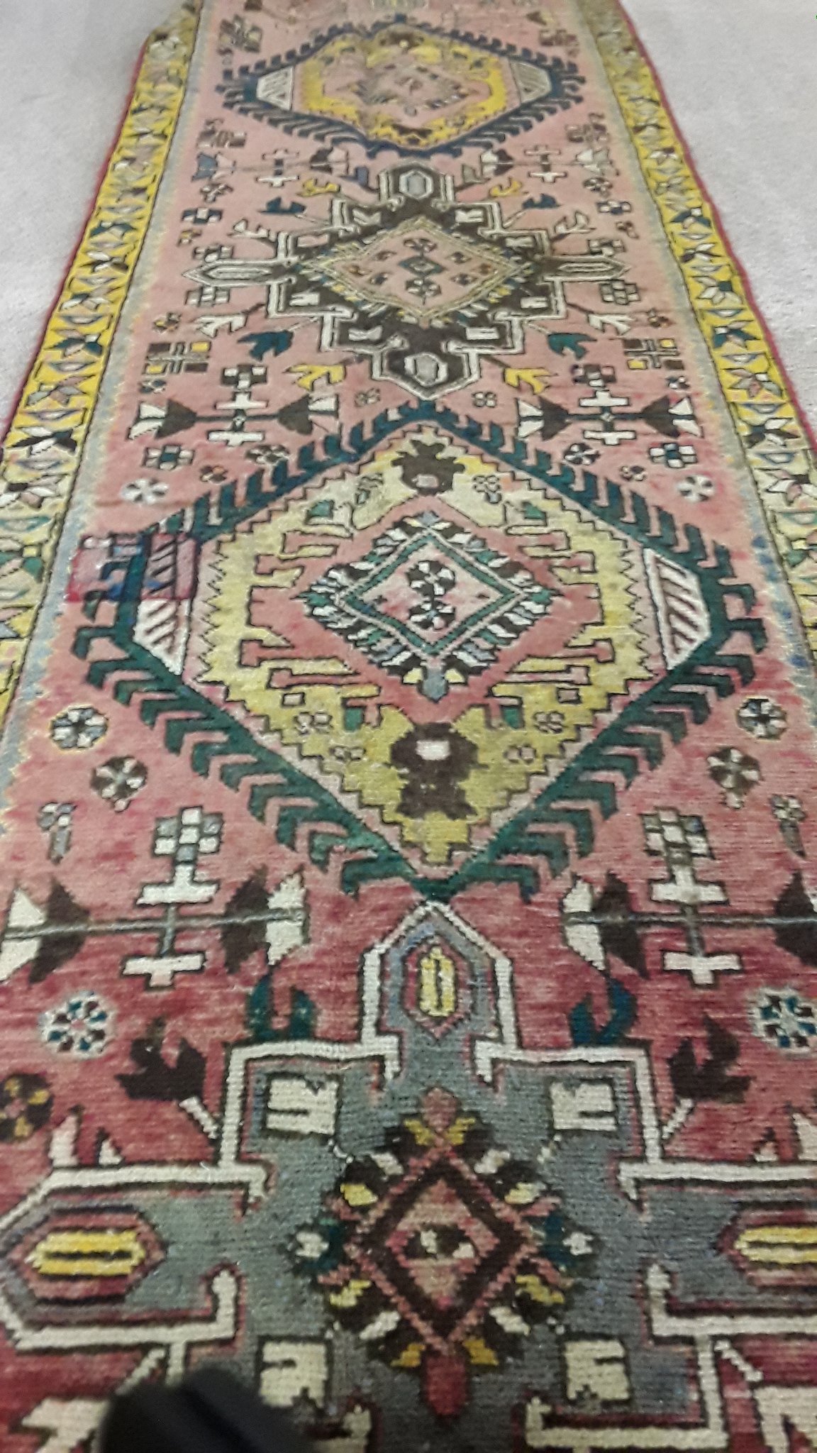

A majority of the rugs we clean come from overseas. We have a customer who buys hand woven rugs from England (most are antiques) and sells them. We clean around 40-70 of those. They are all wool rugs. We do get some machine made rugs in but not as often. I'm wondering if the tumber would be too rough for the rugs we clean. Here are some pictues of examples of the rugs we clean.
