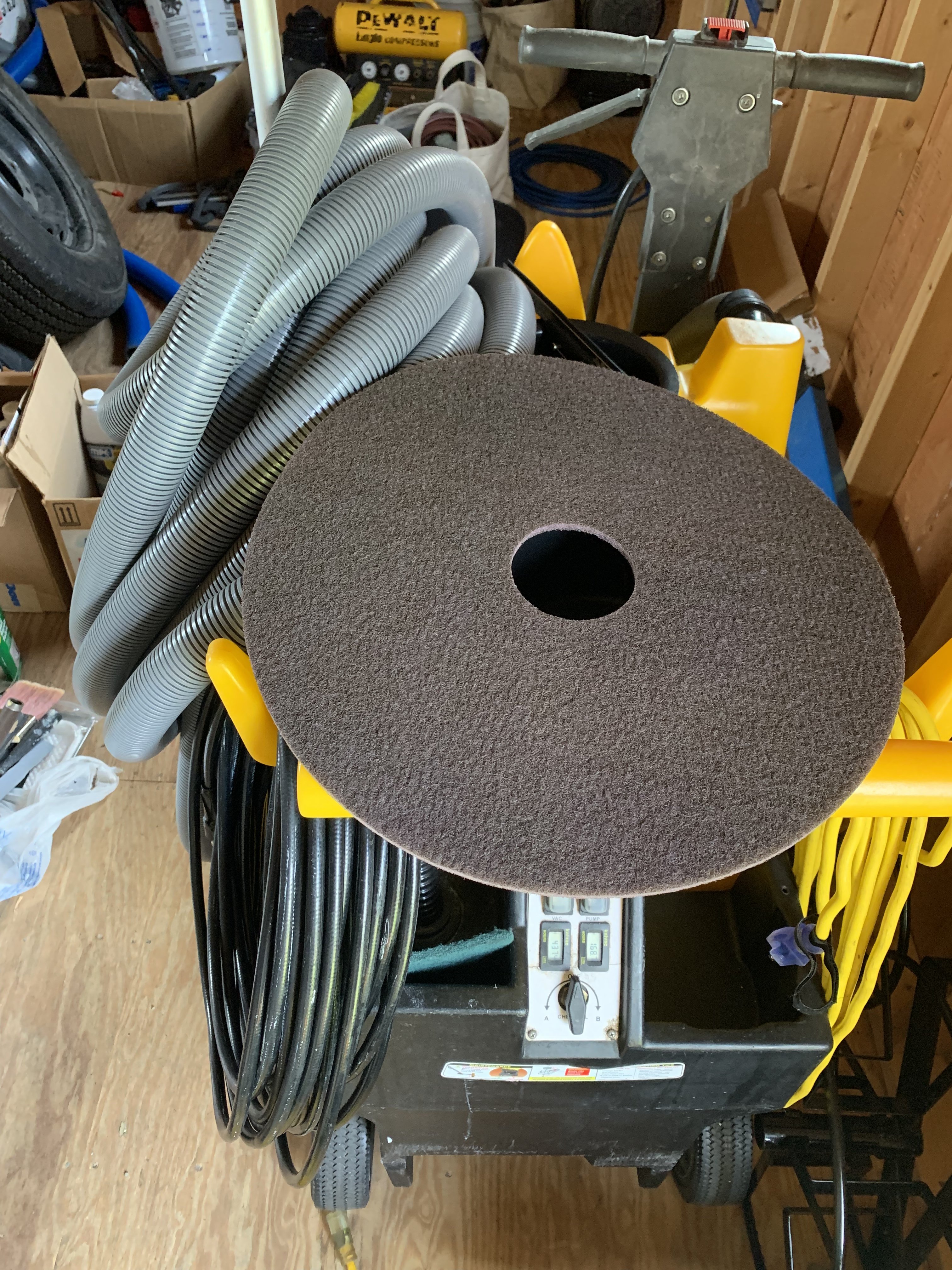

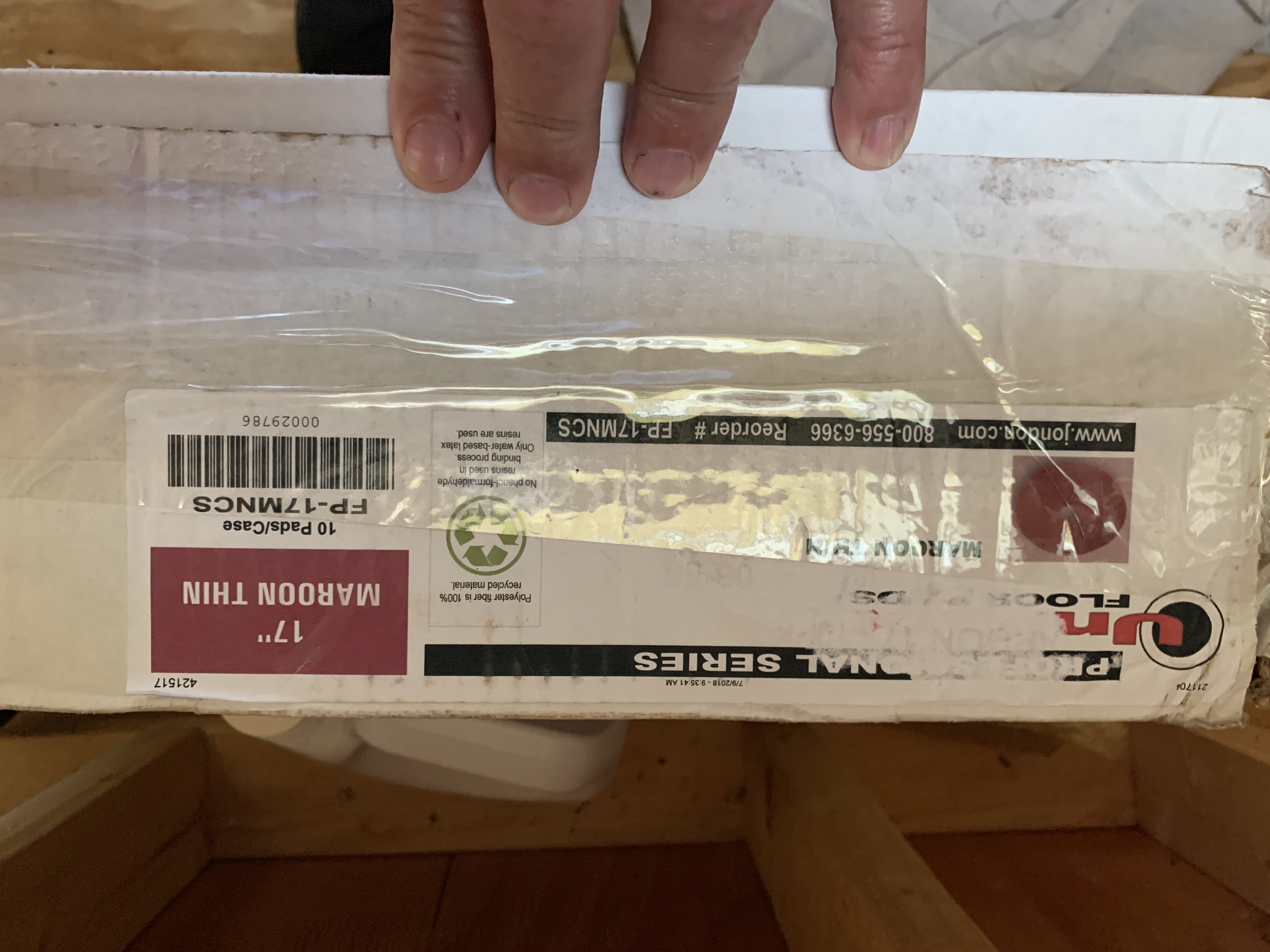

what if I don't use stripper and just scrub with water and a black pad
With the floor that bad it will end up blotchy, the pads will scalp the high spots and leave the low spots.

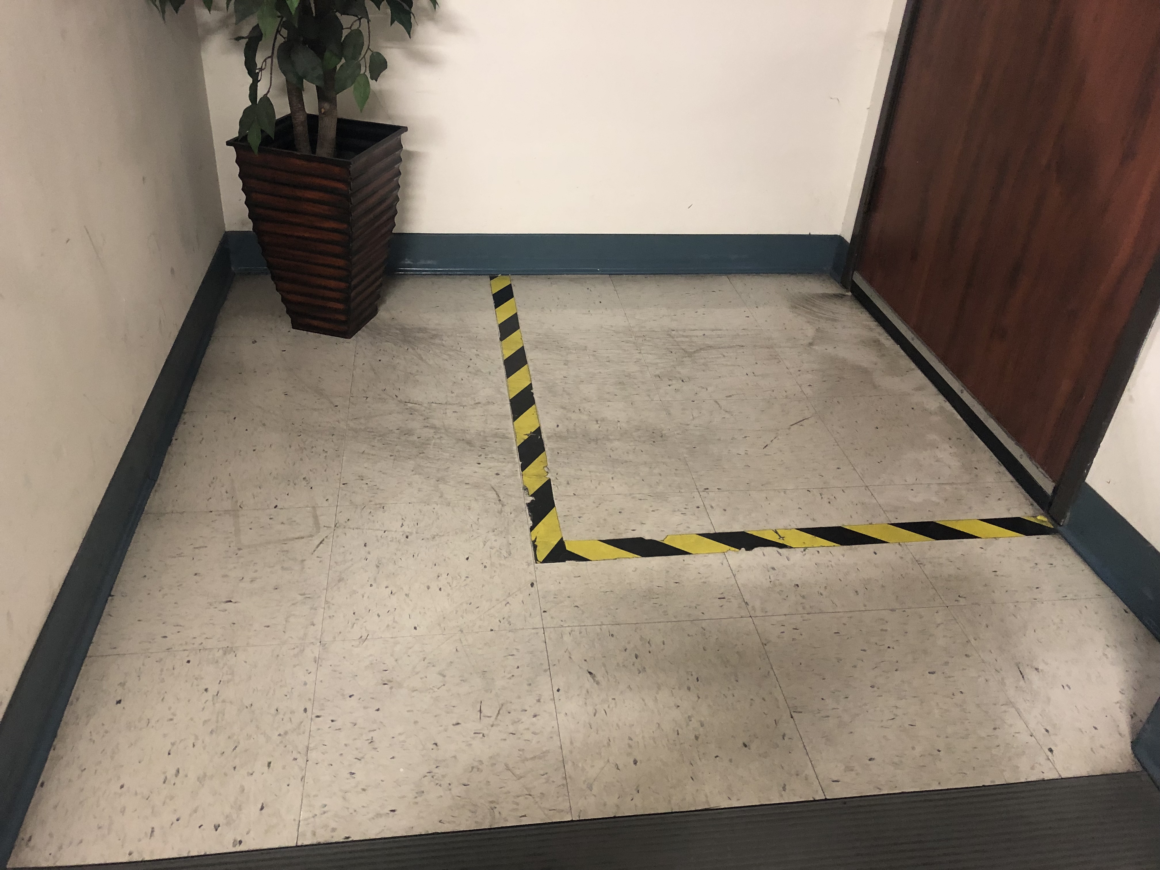

Three bukz a ft to top scrub
Unless it’s a little 150sf room and your min charge works out to 3-0-ft, i’d Sure keep that account happy

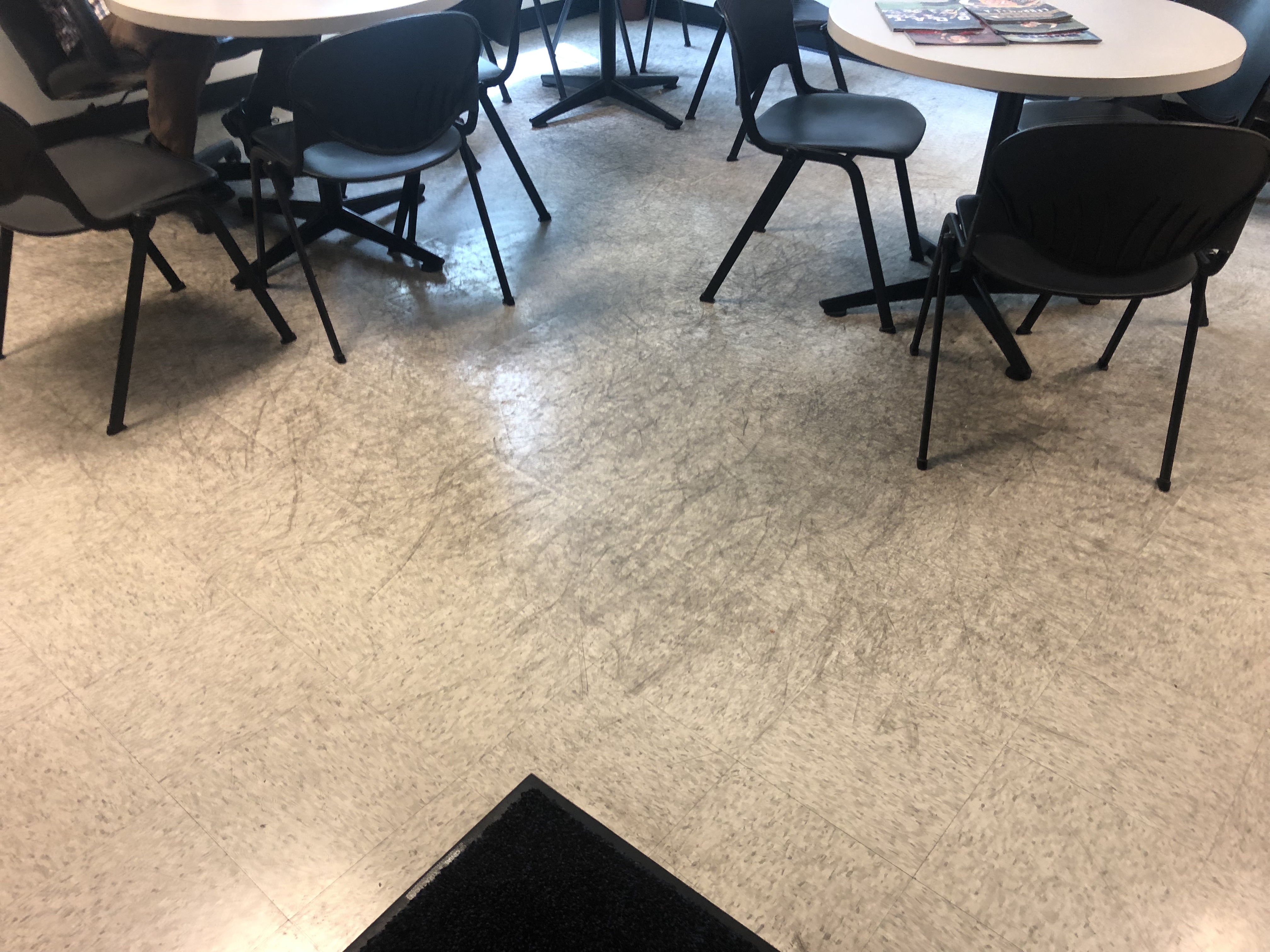

Do what Wade Moore said!!!!! If your 175 has a tank even better. I couldn’t even read all that, they’re carpet cleaners not vct techs. The chair marks will be the hardest, but can be done.

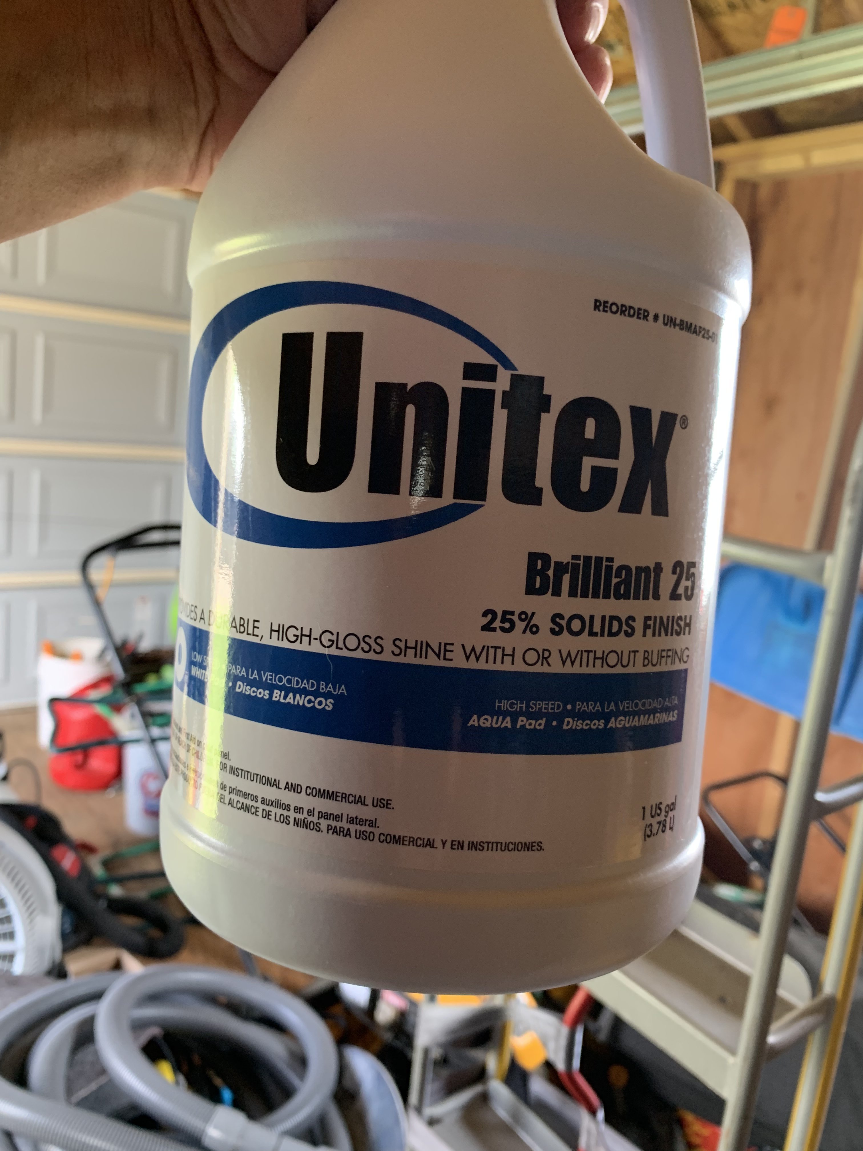

I’m going to apply the stripper let dwell scrub with my buffer and black pad
Vacuum up slurry with shop vac and Malay mop from edges first a thin layer of wax let dry and the. Scrub with white pad

Most finishes don't need polishing with white pad. Just mop on, let dry. Mop on, let dry. Mop on, let dry. Don't forget to mop rinse with neutral cleaner after stripping.
