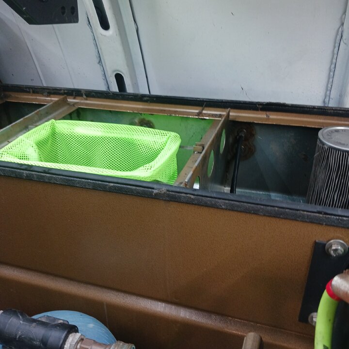

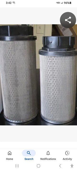

If there was a harder way i think you found it i just use the hose blow the debris off and to and wash um off finish bygoing inside and bloweni out . I have cylinder style filters but i can't imagine the flate ones any different
View attachment 131179 View attachment 131180
My Cleanco has 2. I’ve upped the girth and length of both filters. They are simply hydraulic oil filters. You can get them at any industrial supply store that caterers to the heavy equipment supplier. Eg; tractor supply, or excavator supply store. I also increased the micron by 5k n’s…. WAY better suction.
Zero detriment to the machine.
Finally you’ve given me some useful information! If it turns out to be true I might give you a break on a future DAP.

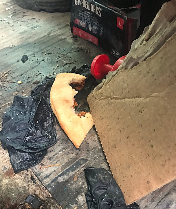

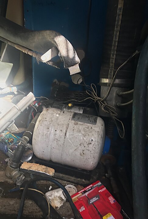

This is what sets Dan off.
I remind him:
"Guys that have messy trucks are the ones that have the most trouble. Guys that don't care about the inside of the truck are also the ones who don't change oil, repair things before they get bad, let their machines freeze, etc. Most of your income comes from guys who have messy trucks"
(Food for thought isn't it?)
I remind him:
View attachment 131183 View attachment 131184
I suppose the operator of that truck may not be ready for a conversation about shoe covers.
Reactions: Jim Pemberton

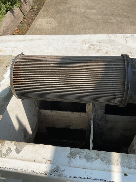

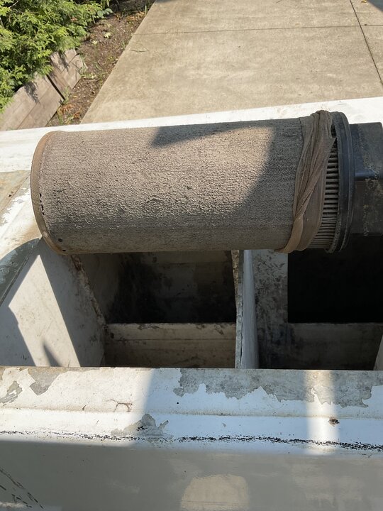

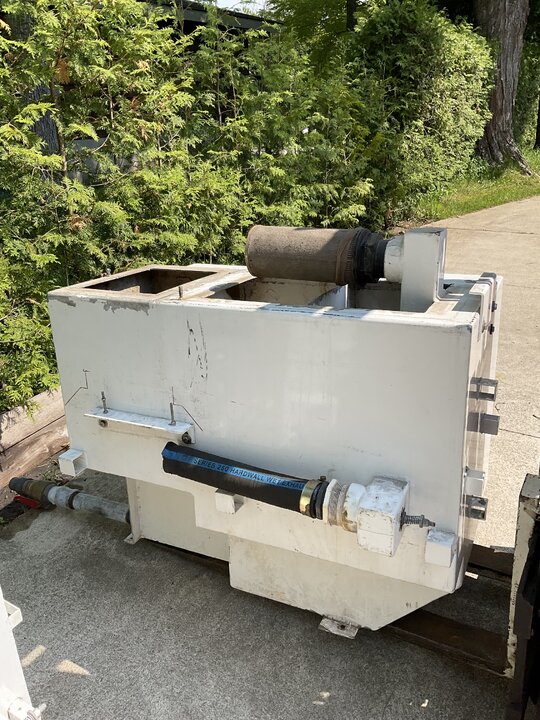

I run a kneehigh nylon stocking over my filters, but as you can see debris still gets into the ss mesh
