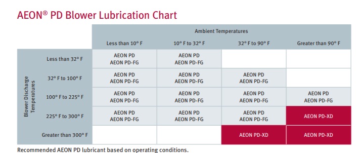

I have an older Hydramaster CDS . What is the best blower oil for that machine? I have been using Aeon PD, but I also see there is a PD-XD version of that oil. Is that better?

For me it is not about the cost. My machine takes care of me so I just want to make sure it get's the best from me. What is the difference between PD and PD-XD? Butler recommends the XD for their machines.

FWIW, I was informed that in the winter, a guy should run lower viscosity, and in the summer, a higher one.
I guess it depends on hrs put in, and ambient air temperature.
Makes sense.
