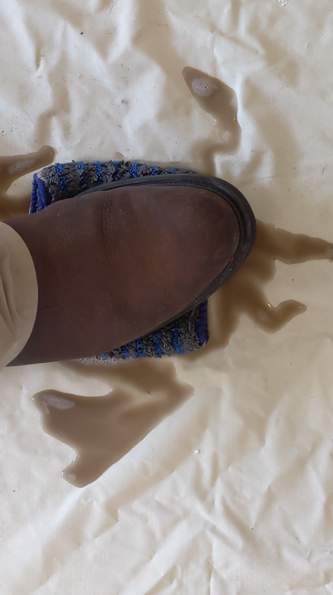

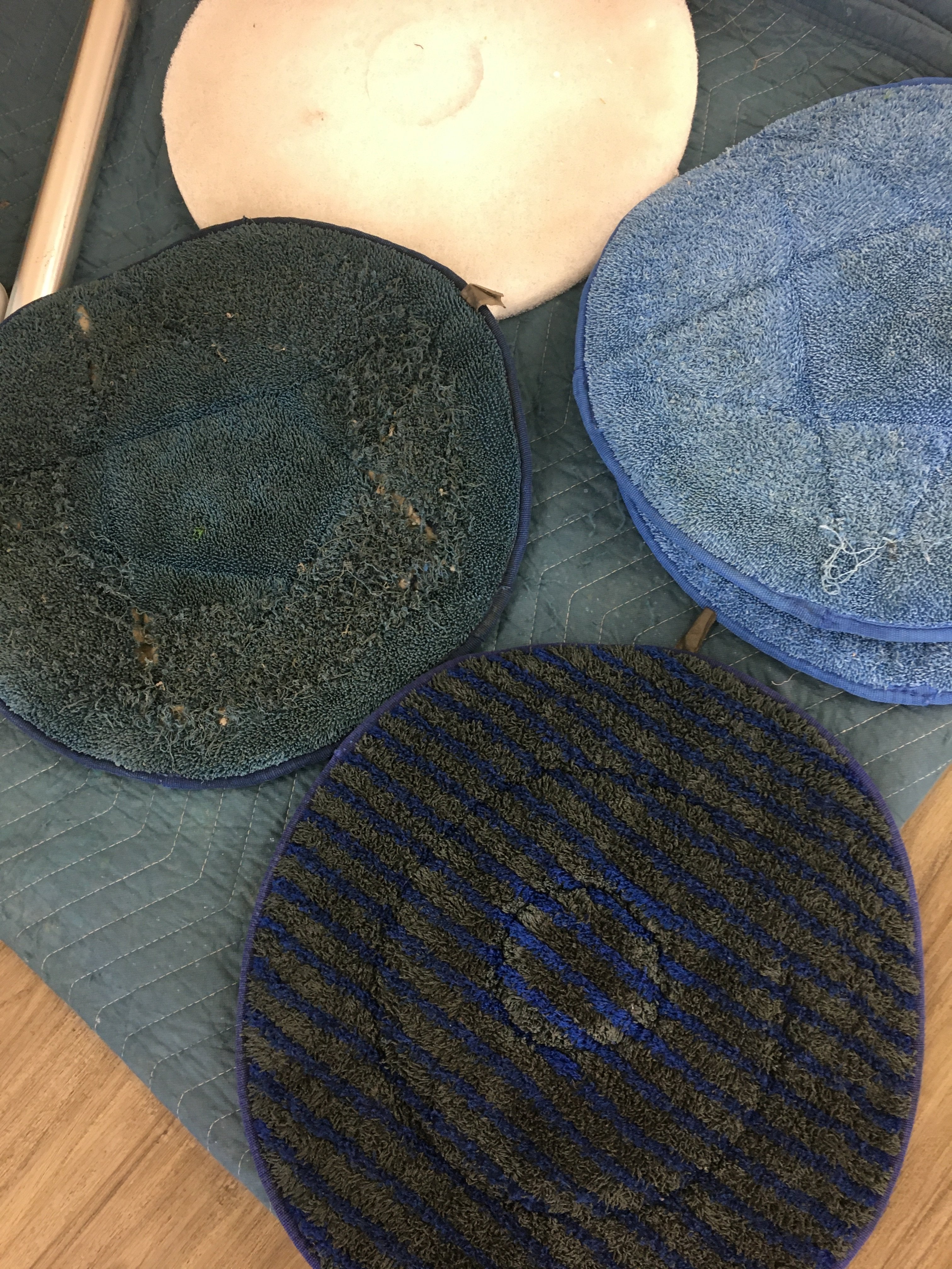

The fiber pad was used on VCT. Held together fine. The blue star-sewn pad tore all to h*ll on LVP. It was brand new like the two clean ones.
The circle-sewn striped scrub strip pad sailed through the remainder of the LVP with NO damage to the pad. I washed it and used it to do our bedrooms today.
@encapman do you have any more of these tough guys? Does the sewing pattern affect the durability?
BTW the soil those things absorb is unreal. I had to rinse and wring frequently and the water looked like driveway sealer.

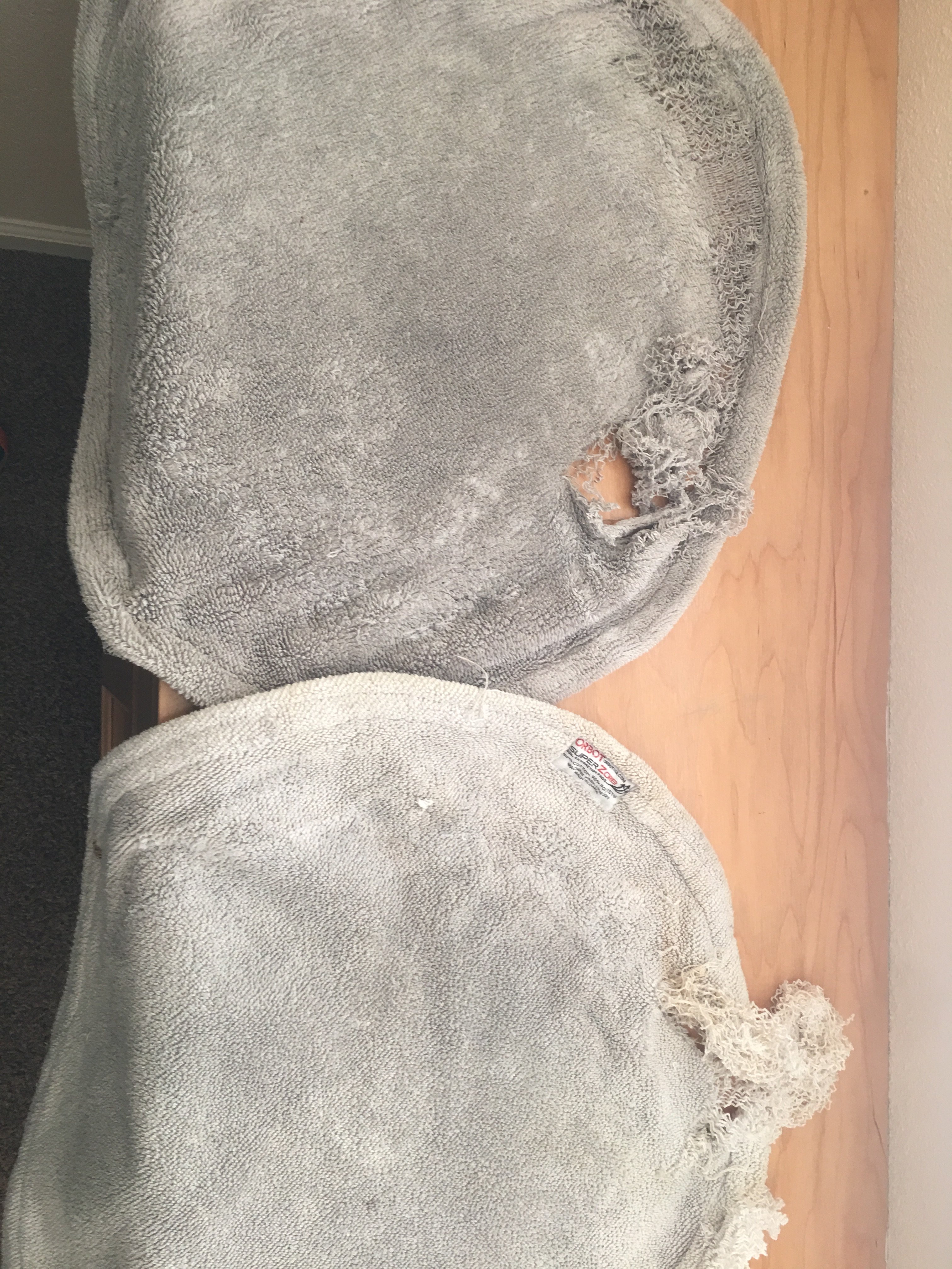

Rick I would suggest you make a deal with the Debil to sell the TRS pads
I might buy a few. The star types get torn up by the driver of the Mytee ECO. On cgd, not so bad. But they should last longer than a couple of jobs, imho.

To be totally upfront about microfiber bonnets - they're all manufactured in China. And their quality from batch to batch varies. I wouldn't want to take a stand and say that one design has superior longevity or scrubs better than another. We've simply seen too many variables to make any categorical statements about microfiber bonnets. Bottom line; all of them scrub pretty well, they all absorb soil effectively, they all hold up reasonably well under a rotary, and they wear out faster on an orbital. Consider them as consumables. They'll wear-out/disintegrate faster on an orbital (because an orbital machine can be pretty aggressive). But they'll also generate a good amount of profit in the process.

Had a super Zorb bonnet com apart on me. Quite the mess.
