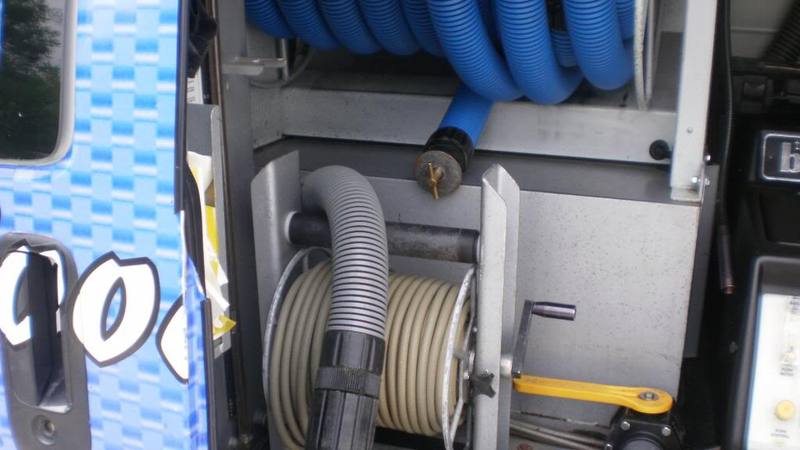

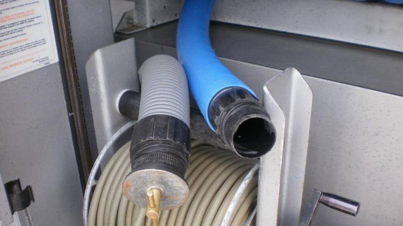

And this is my first Youtube video....

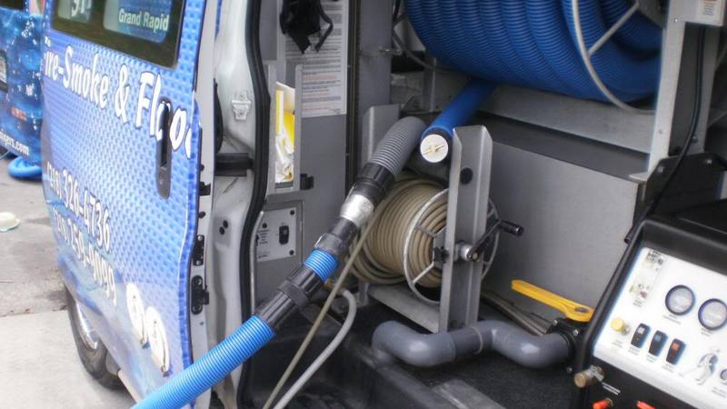

Just wanted to show people who have been asking how we set up our live reels (since we don't use a live reel stock).
Posted this also on my Facebook accounts in case the link doesn't work properly.
http://www.youtube.com/watch?v=Cg6LkkmYwsM
https://www.facebook.com/Saigers
Will try to post some stand alone pics of this set up too.
And Marty...here is that video I told you I would eventually get to. Hope it makes some sense now.

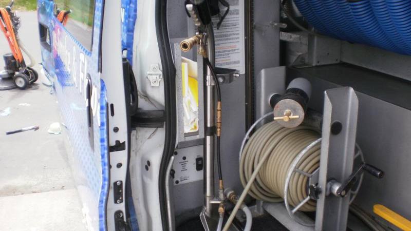

davegillfishing
2,229
dave gill

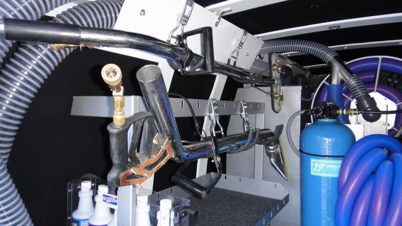

Looks good..
Where did u get those hooks holding your tools? Those are sick!!
Mark Saiger
Mr Happy!
Dec 26, 2006
11,200
Mark Saiger
Looks good..

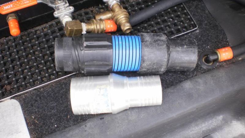

Home Depot...they were part of the Rubbermaid track hanging system. Just had to add a bit of support you will see with a small homemade "L" bracket out of diamond plate to help support the top ones. The are working slick for us right now.

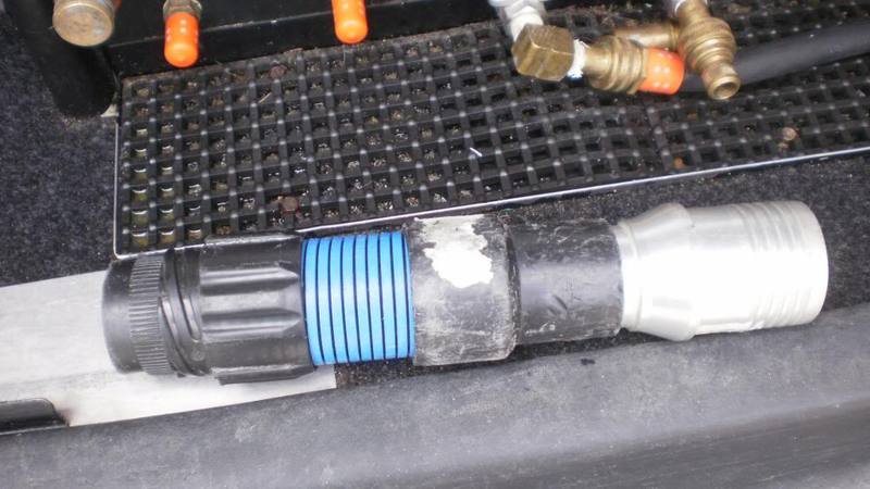

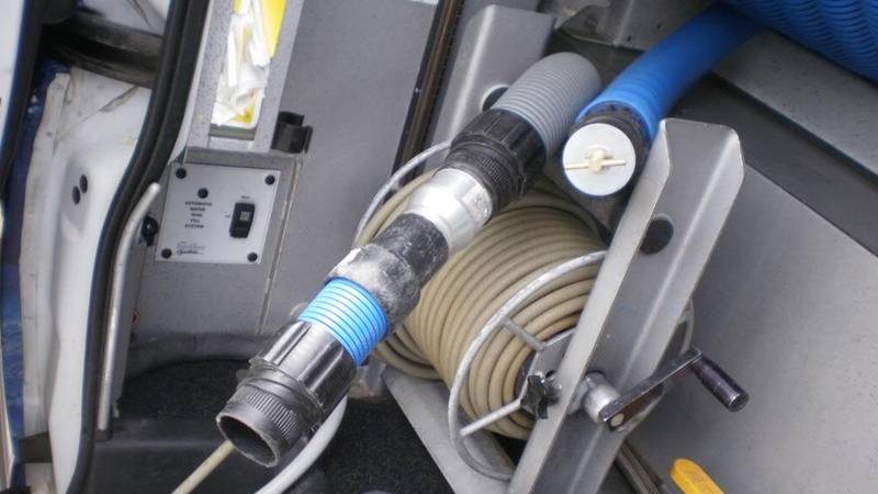

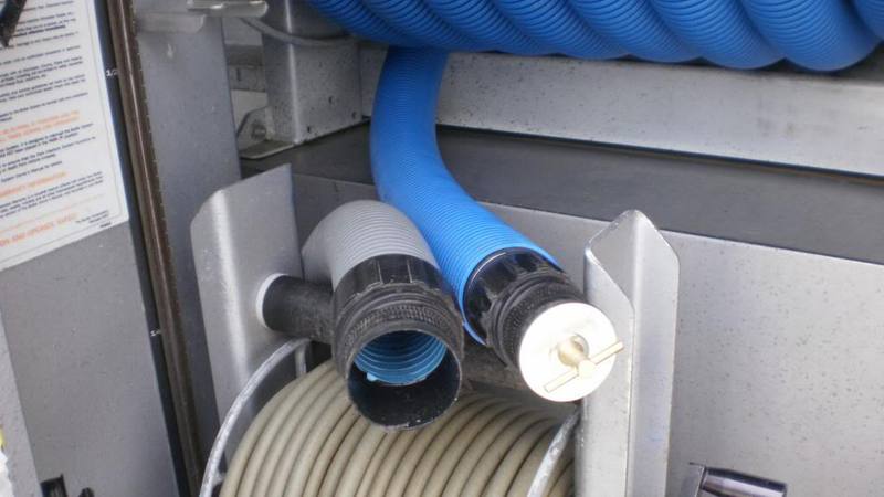

I set up one of my friends with less hose on the reel and he had his 50 foot section of 2 inch attached to the 2.5 inch and reeled off either one 25 foot section (so now he has 50 feet 2 inch and 25 feet of 2.5) or if he needed 100 feet, he just kept pulling more 2.5 in the 25 foot sections.
Just gave him more options. For us, I like to have as mush 2.5 on the truck and available to me for maximum air flow.
Hopefully the video can give some ideas for using the "Live reel" option and make a faster set up for each individual.

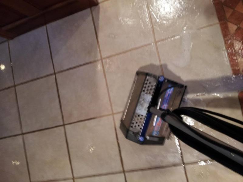

Do you like your 4jet tile tool better than a SX12
Yes it is a spotting salesman kit....but I don't ever use the kit, but I do sell a lot of the product. Don't even need the kit much since my clients have come to know I have the product and ask for it.
I do use Turboforce spinners for tile and grout, but the hard surface wand is for other general hard surface cleaning and edging out jobs where the spinner cannot get. I have a couple that I got from Steambrite. http://www.***************/clean-st...nless-valve-brush-internal-spray-p-10541.html

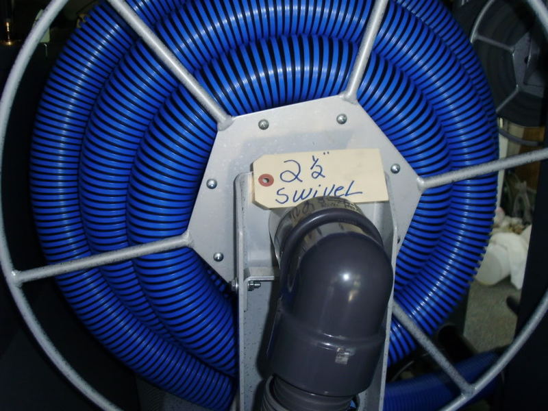

In the case where your pulling off all the 2.5" to use, why not just connect to the by-pass instead of the live reel? That 2.5" swivel is a restriction anyway. Why not forget the wye and just bypass the live reel altogether?
Mark Saiger
Mr Happy!
Dec 26, 2006
11,200
Mark Saiger
In the case where your pulling off all the 2.5" to use, why not just connect to the by-pass instead of the live reel? That 2.5" swivel is a restriction anyway. Why not forget the wye and just bypass the love reel altogether?
This reel is a true 2.5 inch and it is there...so we figured lets try and use it. Not enough restriction that we have found and removing it off the reel is just one more step to hook up. It is also more difficult to get that last section of 2.5 off the reel. We just found this was an easier way to use the feature of the live reel with the Butler and just keep trying to find ways to up our production rate and keep good air flow and cleaning quality.
I got tired of pulling and rigging and bypass this and that and came up with this for us to be quicker.
Just what we have found that works for us....and still get good cfm.

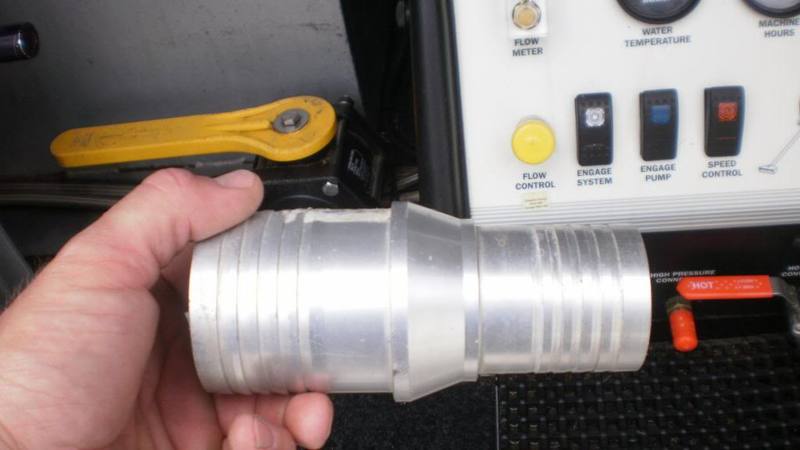

If I may make a easier suggestion.....it may work for you...it may not....
get something like this....(or even a piece of 2.5 inch hose that runs from your waste tank and down to the front of the vacuum reel would work also)...
put a 2.5 to 2 inch reducer on your hose and just hook it in...
and if you need any of the 2.5 hose just hook the reducer to the 2.5....
and then just hook the 2.5 to a type of connection...or the 2.5 hose whip....
you might find it a bit easier to set up....no more plugs to mess around with and a lot less restrictive...with out the "Y" or the elbow.......

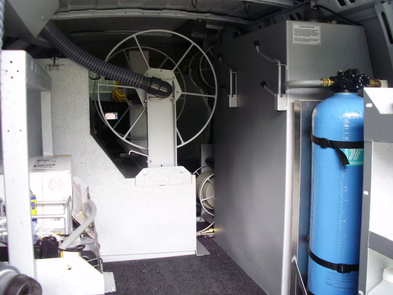

FB7777
Thanks for the ideas and videos. Mark
If I decide to go with butler on my next TM , I have some thoughts on how. I would like it arranged in back
Thinking about ditching their shelves , moving the filter box to the rear right and leaving the entire middle and left side open for tools chemicals fans etc
Reactions: hogjowl

There are a lot of options a person can do. Butler will do things for you if you ask. I have found them to try their best to help. From their, I just personalize the units to how we like them too.

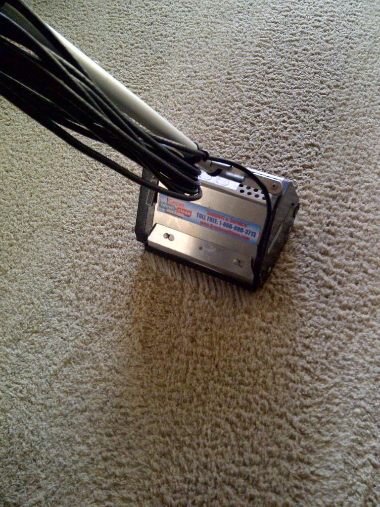

10 inch Brush and Clean. Came with the white brushes and we did not switch out to anything else. Seems to do the job and not seeing tip blooming with the softer white brushes, so we kept them as is.
We also like them on the steps and bullnose of steps. The machines have some weight to them and I went with the smaller units because my daughters were working for me at the time, and just were smaller for more room on the van.
We also use them on hard surface scrubbing. We have had them over 3 years now and not one problem with them. They get used everyday.
