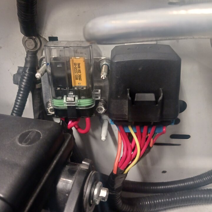

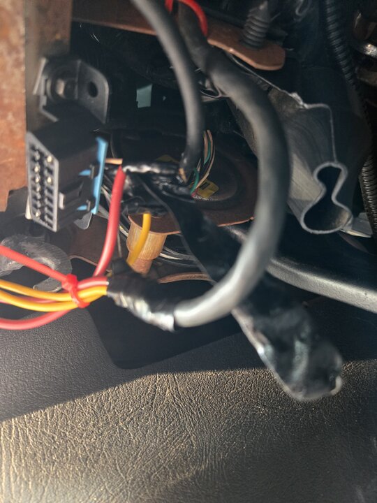

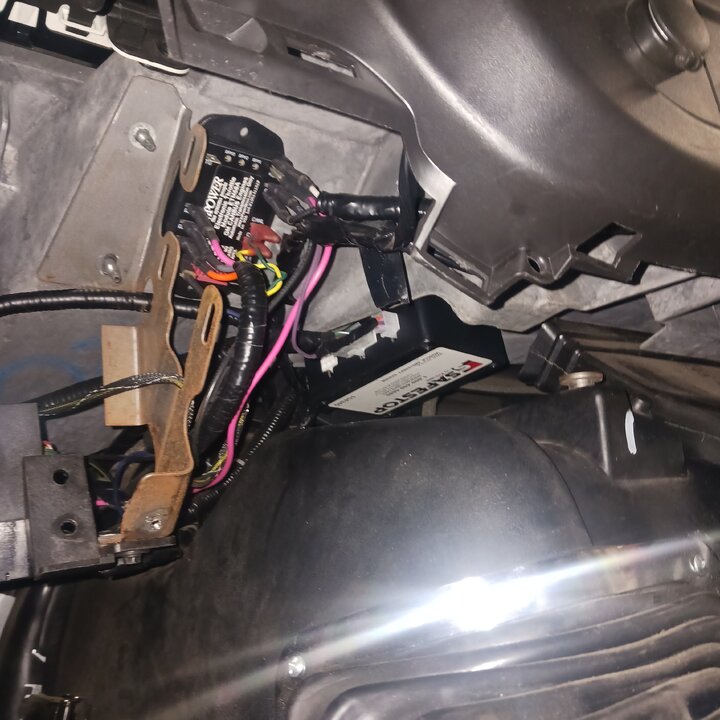

Well, looks like the previous owner just spliced in the electrical rather than getting the proper harness. My friend at Hydramaster just helped me realize that. He's ordering me the right harness and will talk me through installing it when it comes in. Things are looking up. Maybe..! 😄

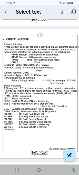

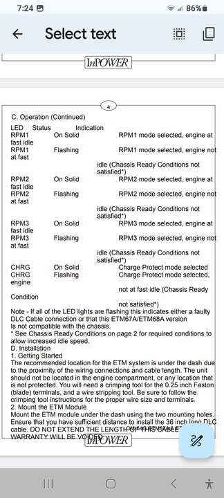

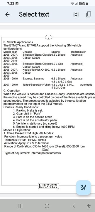

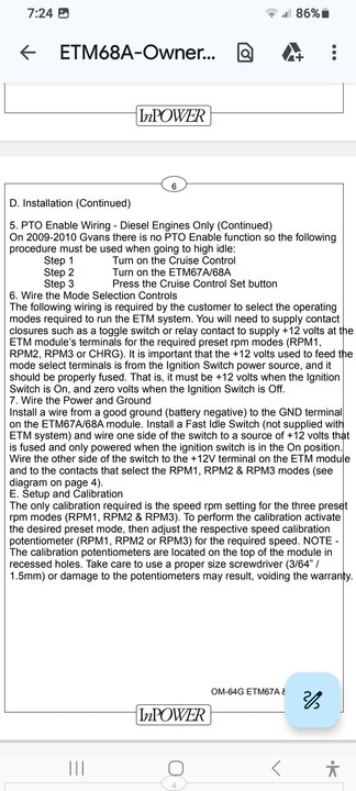

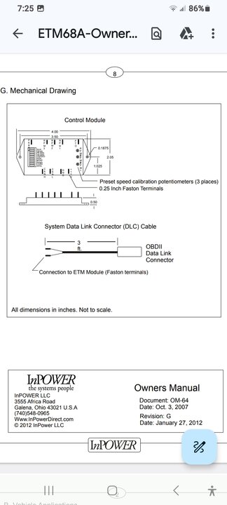

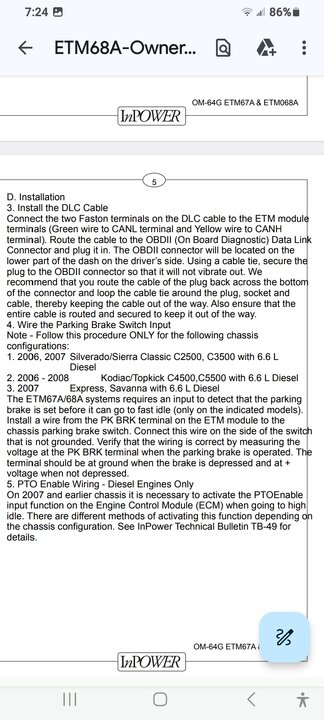

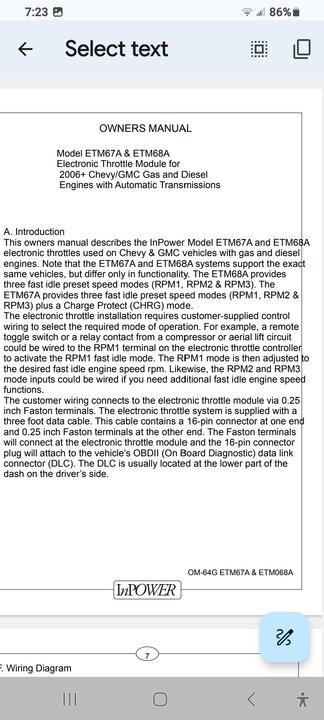

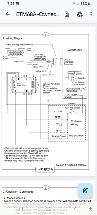

Heres the installation/ operation/ troubleshooting for that throttle controller hope it helps. I had to screen shot it. I have it as a pdf file and i don't know how to send it if you have any questions i built my machine from scratch and used this same throttle controller and im familiar with it
Screenshot_20250612_192343_Drive.jpg Screenshot_20250612_192357_Drive.jpg Screenshot_20250612_192416_Drive.jpg Screenshot_20250612_192432_Drive.jpg Screenshot_20250612_192443_Drive.jpg Screenshot_20250612_192456_Drive.jpg Screenshot_20250612_192516_Drive.jpg Screenshot_20250612_192534_Drive.jpg 20240204_153217.jpg Screenshot_20250612_193904_Gallery.jpg

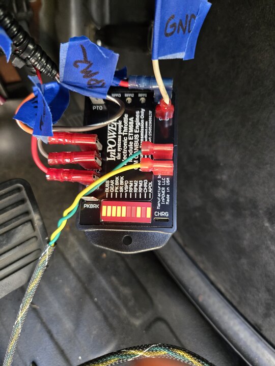

You have 3 leds not on in picture or are flashing and show as off. What are is the description marked for each light?

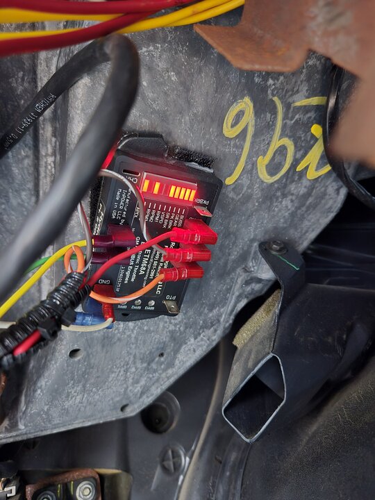

Thanks Dwain! The 7 led lights that are on, they flash on and off together in sync continuously when the machine is powered up. I just took a pic at a moment with them flashing on. The 3 lights that are not on at all, and do no flash on, are "rpm1", "rpm2", and "chrg".
The instruction manual you kindly posted pics of doesn't list my 2013 Chevy 2500 Express as a supported make/model...

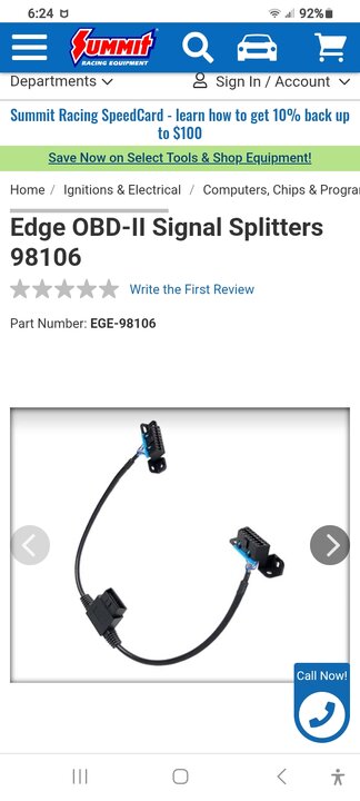

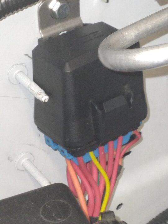

What do you make of the hack splice without the appropriate 16 pin harness?
Dwain Ray
Jul 22, 2020
851

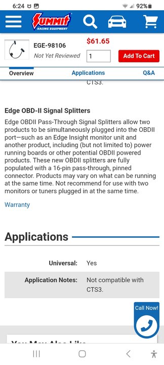

If spliced to the right post, it shouldn't be a problem the controller wiring harness from the factory comes with a obd2 plug on it and you plug it into the vans port. I didn't like that because inorder to diagnose using the port you had to first unplug the throttle controller. I used an obd2 splitter which does the same as tapping the back except its plug n play. You remove your vans obd2 wiring from dash and plug it into the splitter mount 1 end of the splitter to the dash and plug the throttle controller into the remaining port allowing me to use the obd2 port and throttle controller simultaneously but wiring to the back does the same. But because I was doing this to a new van i didn't want to deal with any potential warranty issues

If any of the lights are flashing on the throttle controller thats an indication of a problem the lights are supposed to be on solid are you aware that controller is connected to the emergency brake??? If the transmission is not in park and the emergency brake is not engaged the throttle controller will not work ( safty features)

Yes the emergency brake was engaged when I was testing it out. I was under the impression the clutch drive wouldn't even engage if the emergency brake isn't engaged...

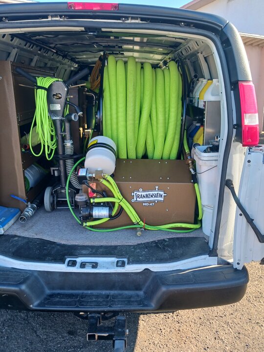

Im not sure of any of that im really not familiar with your machine. my machine is all custom built with off the shelf parts from 5 different manufacturers one of which is the same model throttle controller as you have i can clutch in and out without the emergency brake. My system has a master switch on the dash that powers up and shuts down everything machine,wastepump, waterpond lighting, everything

I fixed it. The throttle module was bad. I replaced it with a brand new one, plugged everything in and it works perfectly. I set the low, medium, and high speeds to 1300, 1400, and 1500 rpms. Now I need a new pressure regulator, it is stuck wide open. Is it worth cleaning them out or do they tend to be toast once they get stuck?

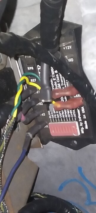

Glad you got it fixed. If you look at your new one when running youll see what i was talking about when i said som of your LEDs weren't lit or flashing. All LEDs on solid says good shape if off that system or the module is self is bad. As for your pressure regulator goes my advice is to throw it away and get a new one

Not exactly all LEDs are on solid. All of them except RPM 1, RPM2, and CHRG are on. And from what I understand this module doesn't come with a CHRG mode, and only 1 of the 3 RPM modes will be lit to indicate which one you have selected at the machine.
But the ones lit in this picture are on solid, not blinking. And the maching is idling correctly. Now I just need to find the right regulator to order. Maybe 2 I suppose...

Rpm 1 and rpm 2 and rpm3 will be on when that circuit is ingaged a im not sure about chrage circuit i think it has to have a wire connected to the controller for that. My understanding is that the charge circuit is for some installations where theres a large draw on the battery at idle. It senses voltage and raises rpm to charge when voltage drops below a preset limit. Not used on carpet cleaning equipment. By the way thank you for the update. So many ask for advice on fourms and you never hear from them. Your left not knowing weather or not you wasted your time responding or if they even got there problem solved or just gave up. Its refreshing and great to hear the final results

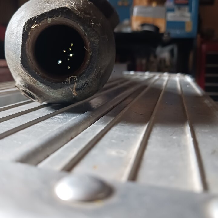

It's the long tube heat exchanger that I am trying to get off. There isn't much heat so I think that's the problem. Whether I need to get a new one or clean it out, I still need to figure out how to get it off. The bolts are just spinning in place and they go right into the waste reservoir. I suppose I could cut them and drill them out but I feel like I am missing something...

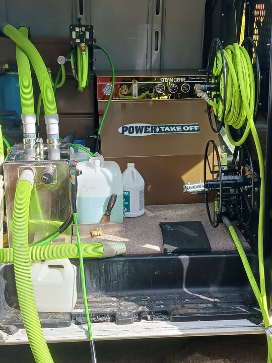

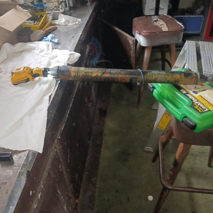

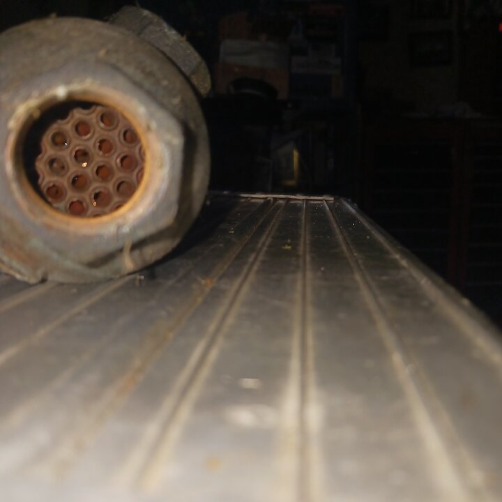

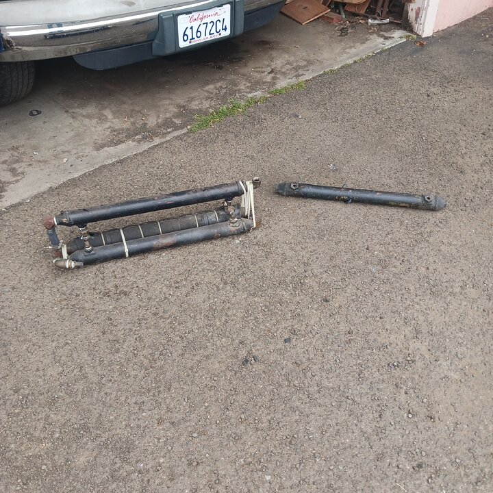

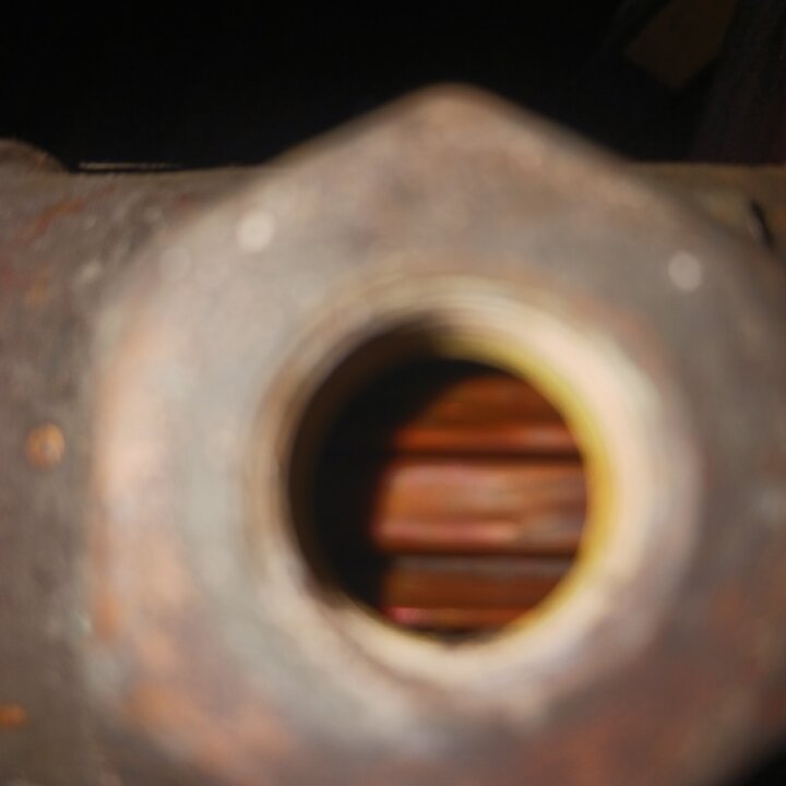

Steamgeni used the same tube and shell heat exchangers as hydramaster except there about 18" shorter and they bundled 3 in series heres a bad one look ing at the tubes from the soulition side(top) you can see they're crushed and by shining a flashlight thru the coolant side (end)you can see how little light and for thats matters coolant can get thru. You mentioned that your pressure regulator maxed out. If so that will crush these tubes. These heat exchangers new are only rated for 900 or so psi max. Another indicator of a collapsed tube and shell heat exchanger is that alot of times when tjey collapse high pressure leaks to low in other words your soulition at say 400+ psi will seep into your cooling system which is at 14 or so psi you this if slow enough will build pressure in your cooling system till the radiator cap releases the pressure and starts eighter over filling the Reservoir (if installed) and or dumping coolant mixed with soulition on to the driveway
20250623_134413.jpg 20250623_134547.jpg 20250623_134727.jpg 20250623_134844.jpg 20250623_134821.jpg
Dwain Ray
Jul 22, 2020
851
See my next comment for advice and troubleshooting
Dwain Ray
Jul 22, 2020
851
There probably bolts that go thru the wastetank. Maybe you can open up the wastetank and put a wrench or socket on the other end
