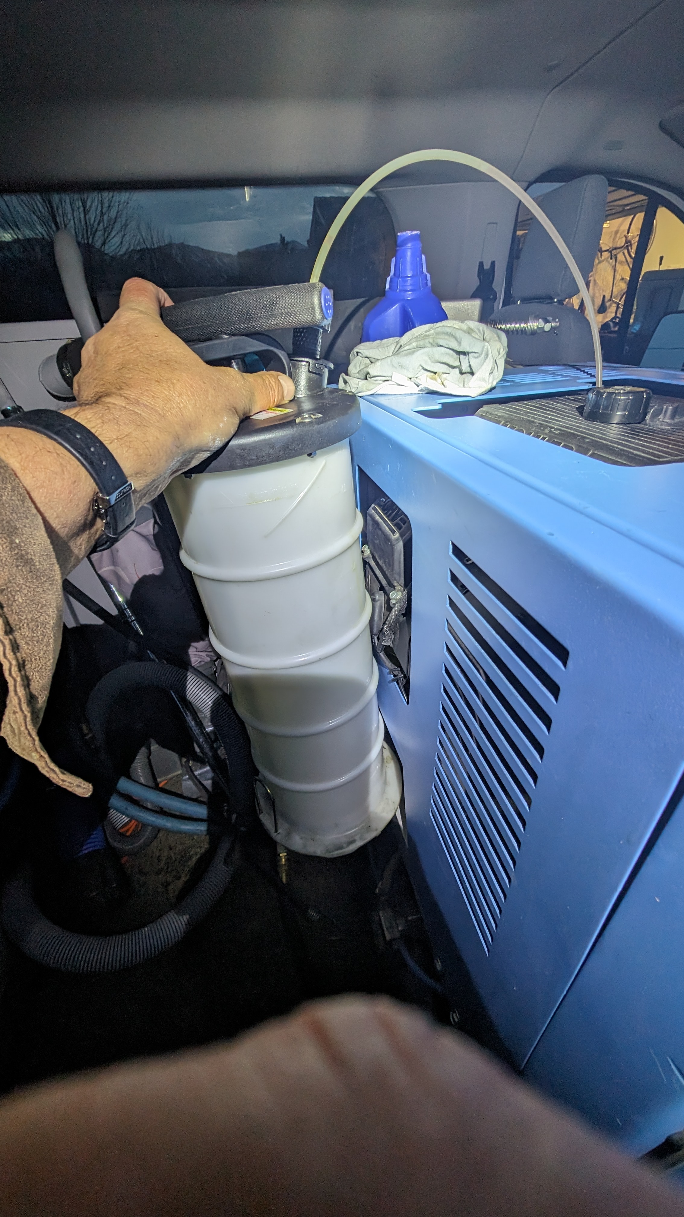

Took off bottom bolt to release and top to vent only to lose 6oz. Added back because I didn't want a 1/2 oil change.
What method does TM mechanics use to extract Blower Oil?
thanks in advance

This is a 2013 Legend GT #4 Sutorbilt blower.
The manual says both water pump and Vac Blower have a 14oz capacity.
Maybe that's why I'm right above 1/2mark on site glass using 6oz?
I'll call the JonDon mechanic I know Tuesday as this oil is vulnerable to overheating if too much.
We did use an air compressed tool to help remove as much as possible and I believe the TM mechanics would do no different. I'm not running this at load or on a job yet& If I do this over again to clear doubt I should probably park on a hill like I do when I change engine oil 🤔
