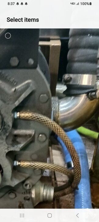

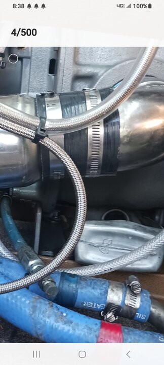

Catch all cups or trays for the weep holes?
Dwain Ray
Jul 22, 2020
849
Neighter, use 1/8mpt × 5/16 hb fittings to plumb um to an oil bottle under the blower for collection. Clear hose works as a sight guage while greasing. You can use just about any bottle for storage and put it anywhere. On frankinstien cutting the side out and placing it under the blower with the hoses going in thru where the cap was is the easiest spot to access and to monitor for me. 1400 hours and 14 blower greasings and only about ⅓ full . Still not full enough to empty. The way ive set this up, when the time comes i can eighter throw the whole container away and get another, or simply reach in with a old shop rag and scoop out a handful of the old grease and continue using the one i have
Screenshot_20251008_083723_Gallery.jpg Screenshot_20251008_083822_Gallery.jpg
Reactions: Mikey P
116,994
View attachment 132766 View attachment 132767
Ive done the same on some units
