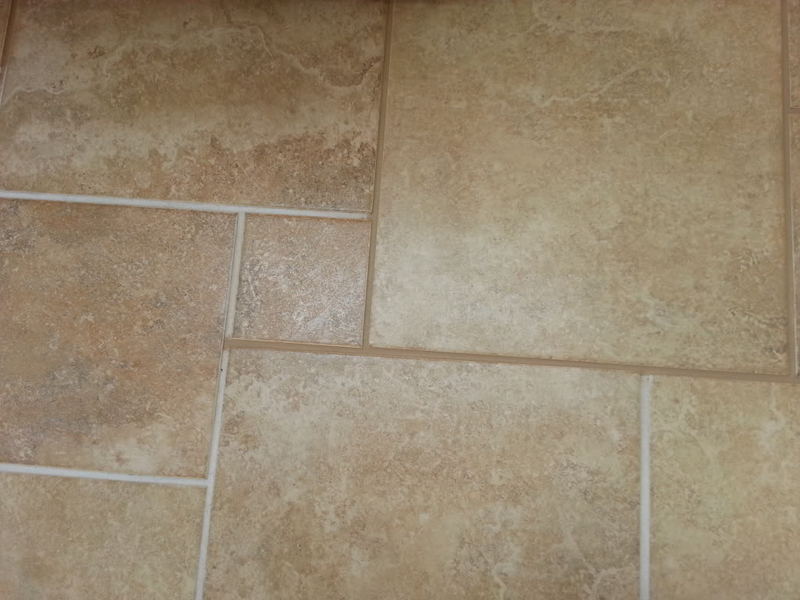

I have a large job to do that we colorsealed 2 years ago w/ grout perfect's malibu sand, and we are going in there to just clean it. The question is can I use Anvil @ 6oz per gallon on this floor or should I use a neutral product instead? I have "neutral" by this old grout spotter size bottles than needs to be diluted, so I just wanted make sure that if I do use Anvil (Jondon heavy duty grout cleaner), that it won't hurt/remove the colorsealer.
I'll be using a turbo hybrid w/ tm.
Thanks,
Bill

You shouldn't need anything more than a hot neutral cleaner.
If you have a CRB use that and rinse with a tile wand or a glided carpet wand at 400- 500 psi.
If you don't have a crb use a white or champagne pad under your 175
You could go higher psi and skip the scrubbing and use your Turbo but wouldn't you hate to find out you didn't get good adhesion with the colorseal NOW?

Yea that would suck if the CS were to come out.
I have 2 floors to clean in that home, one I know I can use the regular alky w/ the turbo, and this one I'll just use the neutral cleaner.
I'll just switch it to the gecko wand/carpet glided wand as you mentioned to be safe, deff don't want to do any re-color that's for sure.

I used to use Grout Perfect a lot. It's pretty easy to clean. Like Mikey said, hot water and a neutral cleaner. I would just run over it with a machine and soft brush, it really doesn't take much.
117,252
yep, dont waste time over cleaning as you apply the CS.
get the bulk off and let your 175 do the work later.
