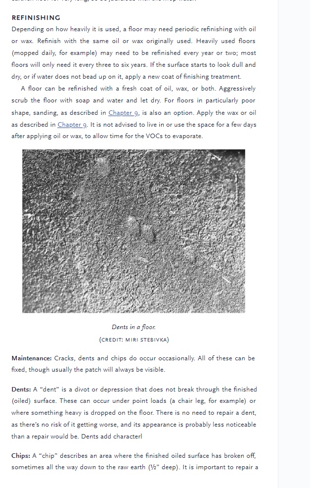

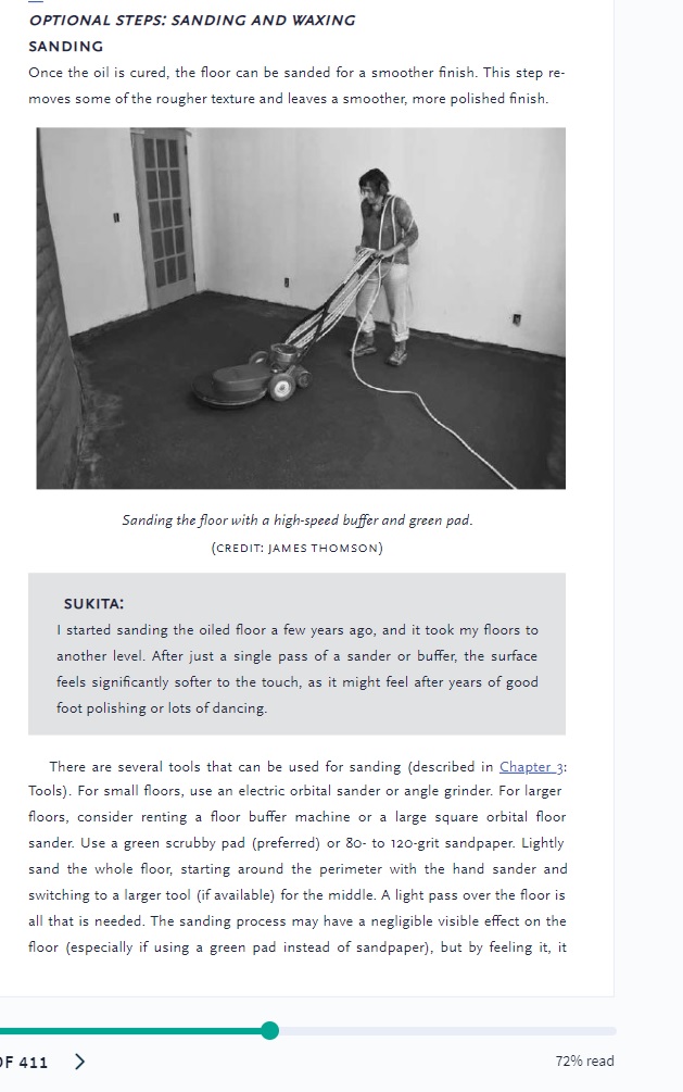

Hey Mike! This is *******, ***** ****'swife. My mom has a natural cob floor and wants to strip a layer of wax off it. She wants to sand it down smooth then reapply wax. It's cob so it's like concrete. What do your recommend?
I had never heard of this hippy dippy type floor, which is surprising haven't spent all those years in Santa Cruz.. There's actually quite a bit of info on how the build one but not how to strip old wax on without destroying it is there anybody here knows anything about cob floors?

Did you find anything that would relate to her question as far as stripping something off the floor without busting it all the pieces or emulsifying it?

The property i was in at Oregon was a cobhouse. My wife mom has that floor. She sand and reapply wax. She does it by hand because it offgrid and the solor power isnt enough to operat 175
DAT
Apr 3, 2017
6,487
Bill Cheryl
Correction, i believe she only used linseed oil

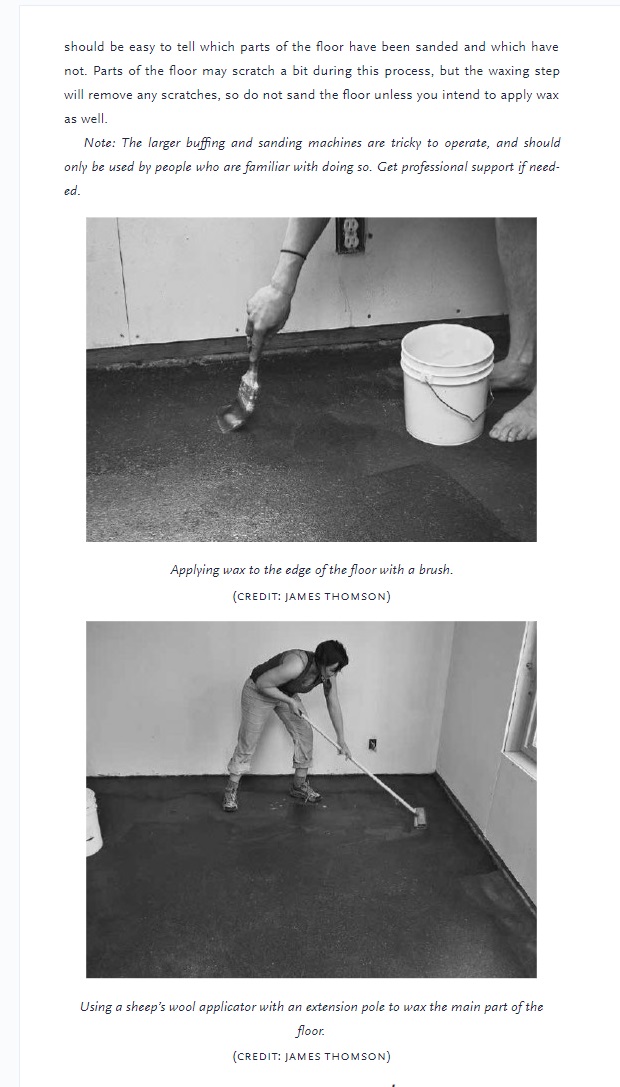

so it looks like
scrub with soap/water (maybe a little dlime)
re-oil (?) and let cure
sand with green pad or 80-120 grit sandpaper
Apply new wax coat
buff with a white pad
*I'd be curious if the "sand it down smooth" is to correct problems that are better corrected by other methods or even a complete redo or just to give a more polished texture
