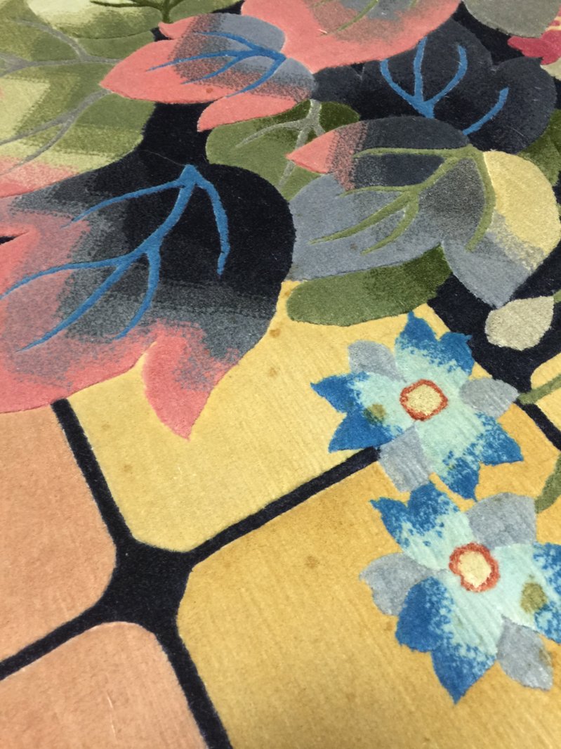

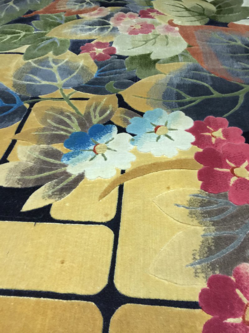

I have cleaned this silk rug with a natural fibre prey spray twice. I have also used a nutral spotter on these spots but no luck. What else could be done to remove these coffee drips?

Try using an eye dropper and test a little bit of an oxidizer. Start with 3% hydrogen peroxide and go up from there.
