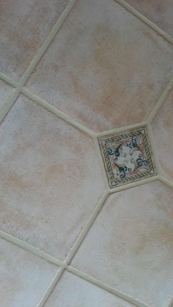

color seal awesomness.
117,251
now that we've done hundreds of Color Seal jobs they are finally starting to call back for a cleaning.
It salways a piece of cake, neutral ph prespray, light scrub in the heavy areas and a Ti Wand rinse..
Still looks "perfect"

Man that sound good Mikey. I find color sealing such a PITA. Can you please tell me exactly the products as well as the method and steps you do. And what is a fair price range. I have used This Old Grout in the past. I find the color seal just wipes out of most grout joints even after allowing the proper setup time. So then you wait to long and you have to scrub it off by hand do to the color on the edges or bevel. Seems some grout just won't even accept it either. I don't mean unsanded grout either. I'm just trying to find the best as well as easiest way and you seem to love it and have it fine tuned. Thanks

tog needs to dry for hours before you can wipe it off the tIle.
Grout Perfect can be wiped off in seconds..
Two to three bucks a foist depending in volume.
Call me some time for mire details

It is a great niche service Bill, i would watch the instructional videos or go to youtube. All about timing and using the chamois, takes some practice.
Most of our jobs are bathroom floors in the $250-$300 range, have not had a big one in a while.
Groutperfect and colorclad are good.

Man, thanks Mikey & Shane for the tips. We've done them but I have not enjoyed them like Mikey seems to so much. May e it's simply the product that we were using. I will take you up on the call sometime Mikey. Thanks guys.

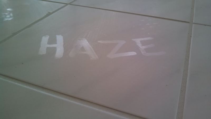

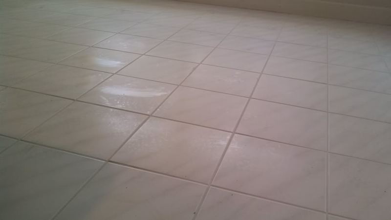

What's your clean up for haze? what are you using Mike just watched the video, got the salesman kit.
They had a oreck orbital cleaner with a white pad then clipped a terry towel to the bottom of it and buffed, what do You do?
I have a 13 inch hild. with a block and a carpet brush

Is that grout haze or sealer? Looks like a wet cloth takes it off.

I get the odd job now and then to clean grout haze. I pump spray pure white vinegar on the tile 10 min. dwell lightly agitate with a deck brush, then use cotton towels to remove then rinse. Don't know if this is a text book method but it works great for me.

White color seal haze left by Stainly steamless. It takes more than that. A white or tan pad then lightly moist cotton pad. They told the homeowner to mop it off themselves.

After color sealing, I spray MR Clean and buff with a tan pad. White pads work, but may not be aggressive enough. Hog's hair pads work really well, but you have to be careful. If you hit a dry spot or work it too much it can affect the glaze of the tile. I have had to refinish porcelain on more than one occasion.
If you have gnarly color seal to remove, use Acetone and a terry cloth towel. Or a white pad under a floor buffer.

we use a white pad with a 35 lb drive plate spritzing easy oxy or other neutral cleaners works great as well, except for those high groutlines that need touching up
