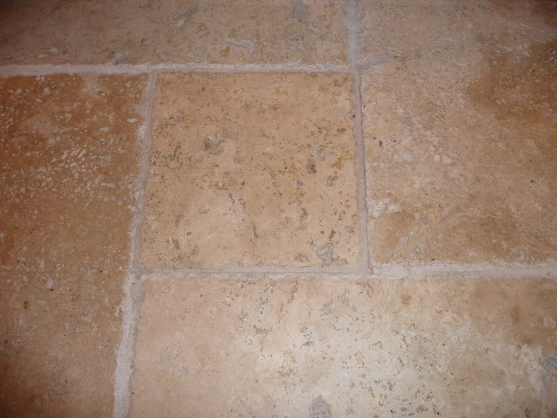

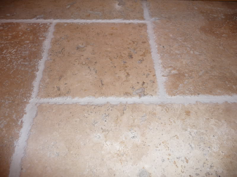

Colorsealing around Travertine for the 1st time
117,255
Amazing.
GP did not stick to the stone at all and made a HUGE difference.
Went way faster than ceramic tile too.
You guys in Arizona would be fools to not offer Color Sealing.

Isn't the side wall of the travertine less dense than the actual top of the stone? I've been told a few times by stoners to not CS travertine because it will eventually impreganate into the side walls of the stone or has happened in the past.

mike,
looks like alot on the tumbled edge, although there was probably sanded grout there too
makes grout line look wider
i'm sure your flash highlighted that colored grout, and it doesn't look as florescent as being there
try setting your camera to no flash, i have noticed flash sometimes will over expose colored grout lines
