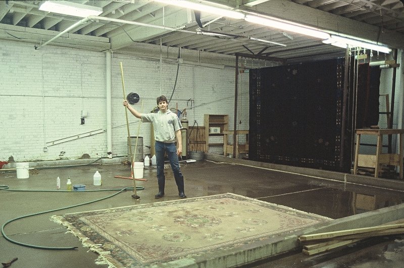

Looks like Tom just missed inserting that pic and there was already a drain in place

The picture tells that we had a mop sink already draining in the floor. It was removed. We poured concrete and slanted the floor to the drain by troweling it at about a 3 inch fall from front to back. Doesn't look that way to the eye. Remember gravity is free and accomplishes what is needed. No pump out required.

In the summer of 1984 we built a wash pit; note the hair style of the day and sophisticated hoist system on the drying rack. We did what people call a 'river wash' today; scrub by hand, squeegee a lot, vac, and run under water till fully rinsed. The results were good, but it was slow and a lot of work. It was the second one we built - the first was in '82 - and eventually we learned how to wash rugs.
