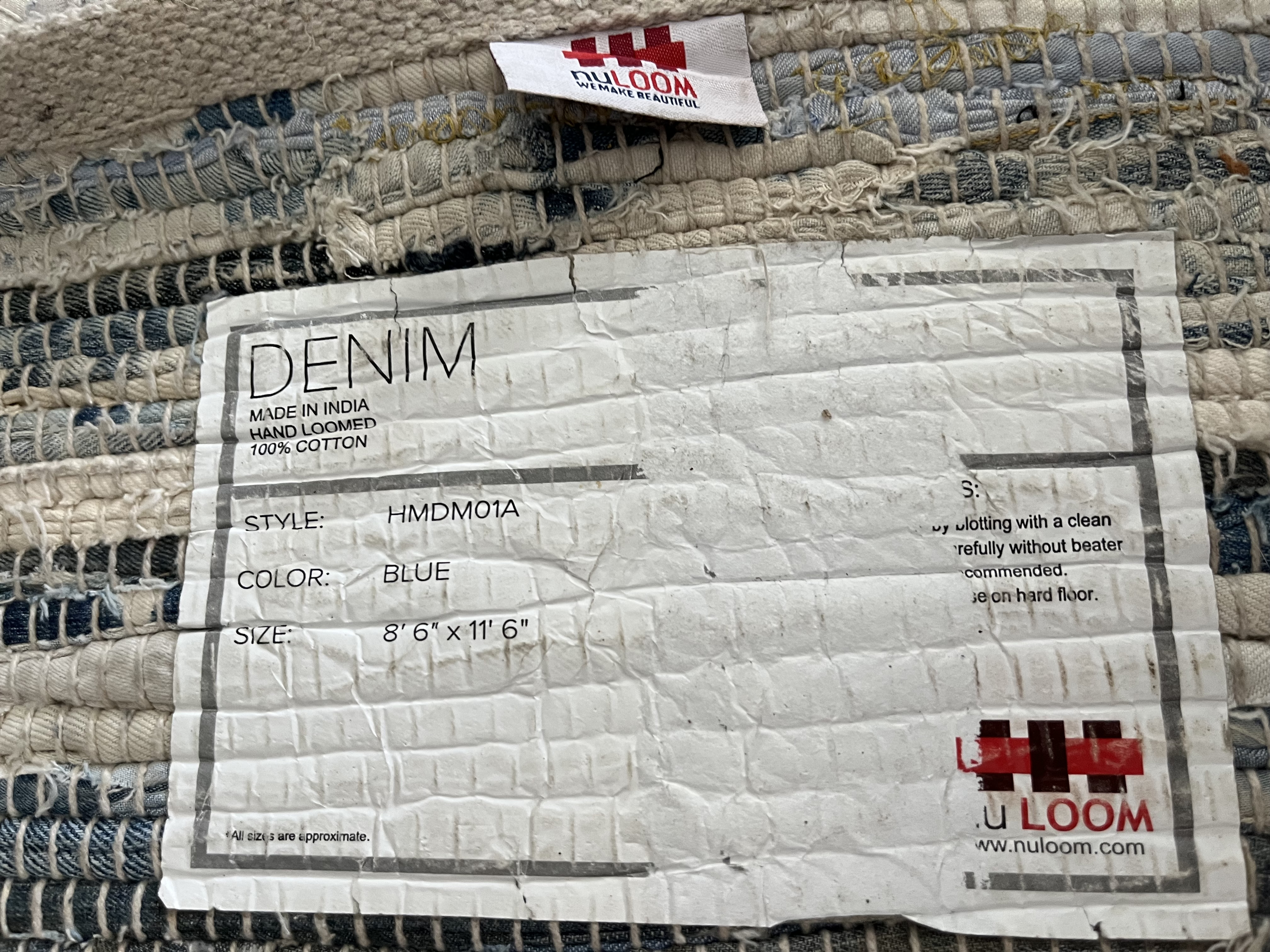

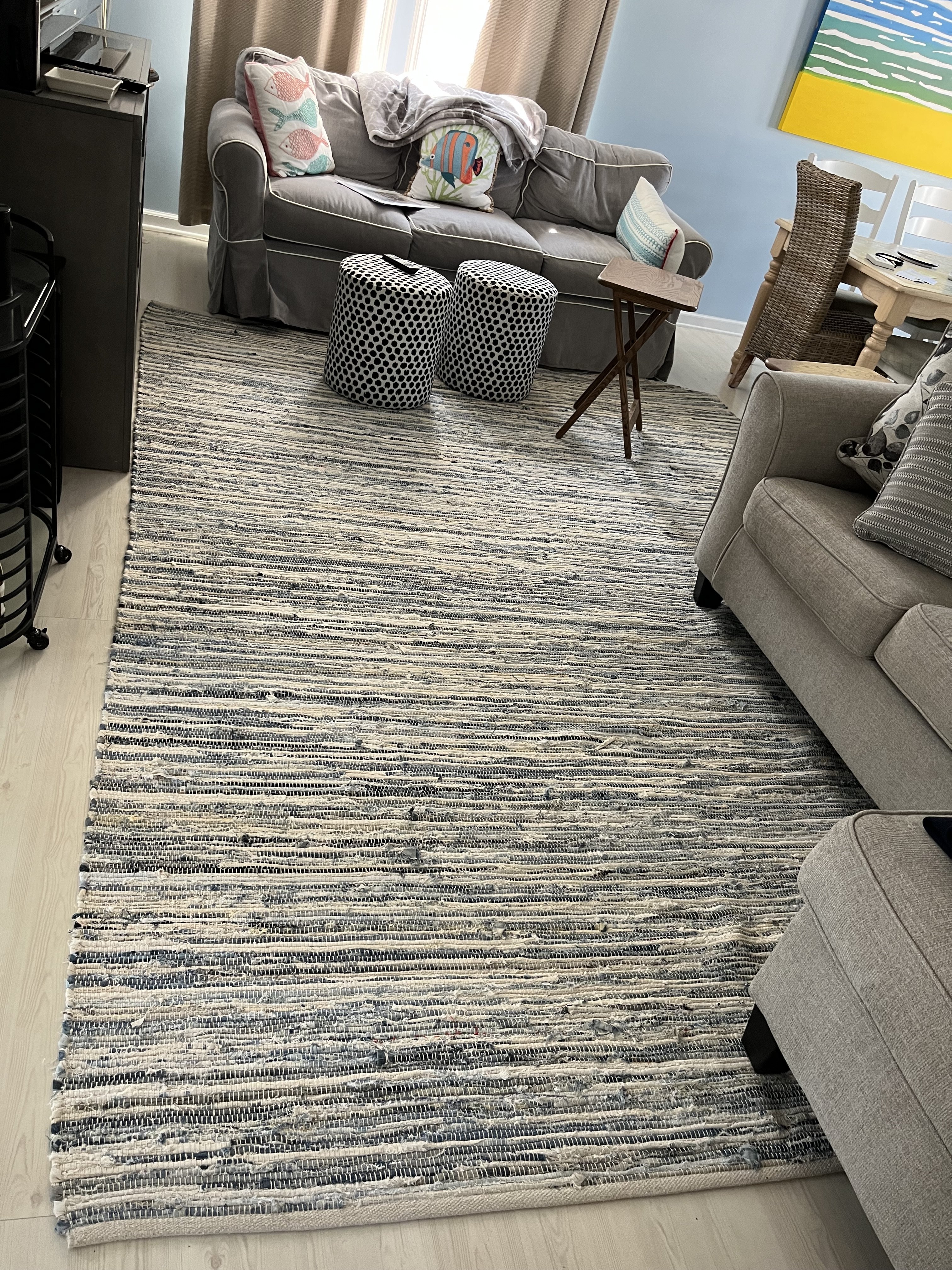

Got a pic of an area rug from a new potential customer.
Not used to doing this by picture, I usually like to see it in person, but incorporated this pic thing recently.
Would y0u schedule this for an in house cleaning? Im thinking $125, easy.
12,769
Browning is in your future if you HWE that with a wand
116,997
It would be highly entertaining if you cleaned THAT! with TOPSPOT...
This is one if those situations where 1.0 would say " if you have to ask, DON'T TOUCH IT"
3.0 says find a real rug shop and pay real close attention to the rug portion of our class in 2.5 weeks....

Cleaning in shop HWE is best bet, after letting customer know the colors may bleed a little.
Reactions: Mike J
Mar 29, 2008
9,738
Nate W.
Denim on upholstery or rugs is not the smartest thing to purchase.. You can clean it, but I wouldn't attempt on-location..
It will get lighter and possibly move the darker colors to the lighter colors..
Reactions: KevinL and Mike J

I replied with the risks mentioned, recommended rug washer, and not on site. Told her for $125 I would give it a cleaning after October, probably in the winter if she didnt care and just wanted to try knowing the risks. Pick up and drop off. Easier than digging clams.
Reactions: Jim Pemberton
KevinL
Jan 5, 2007
2,929
Kevin Leach
I don't pick up, wash and deliver anything for less than $150.
