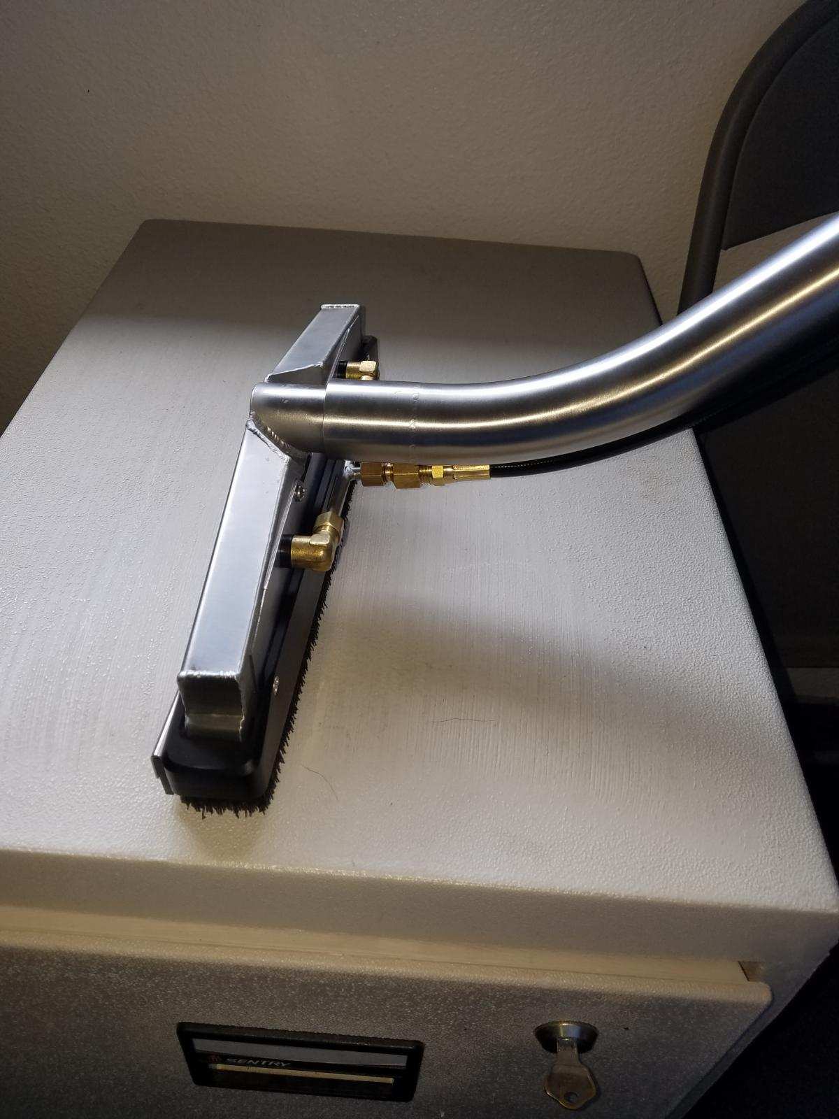

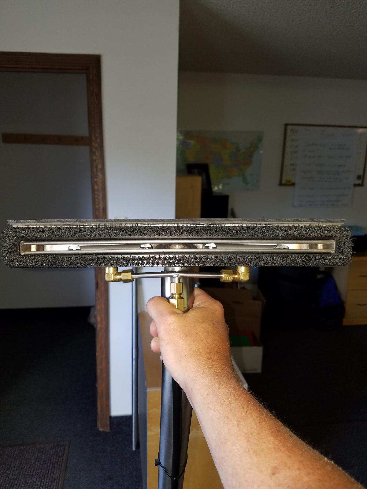

PMF called yesterday, they are sending me a new HS wand to test..
What I like:
12" head
Swivel
Narrow vacuum slot
Vacuum tube not blocked
Killer tufted brush ring
S bend
1.5 tube
Built in M'erica
Concerns:
Confused airflow due to internal jetting
Price

Doesn’t look like anything new. Curious about recovery, bristles look long. Is there some plastic or whatever covering the outside of bristles? I’d rather see six jets with the end jets angled towards the ends of the head. Also, I’d like to see cone jets on a hard surface wand versus fan jets. Why so boxy? Can’t PMF stamp out something more sleek? Maybe it will be awesome? Doubt it.

Not fond of internal jets. All the crap that is sucked up passes and clogs them. 😣
Narrow vacuum slot loads with debris quickly. *We do use ours mostly for sewage or debris cleanup on WDR. They get used often, one is on each truck.
1.5 barrel just makes a stoopid whip required where the ones we have are designed for 2 inch.

Please report on how well the tool recovers water. Which is really what I want to know.
  1. The previous wands could not recover water well. So, is this one an improvement?
  2. How durable is the brush head.
  3. Does it clog?
  4. A 2" would be nice, so it fits with the other tools and does not require a whip.
  5. Any other issues?
Would love to see a simple tile wand that actually works.

I like the fact that it's 12". It'll swivel between toilets and walls allot better than my 14"wp. I get a good swivel about 50% of the time with mine. I'm sure that 12" will fix that problem.
I'd like to see how the water recovery is between wood planks on hardwood, because I'm loving my dd. I'm halfway through my big wood job that I did and the customer was impressed and already paid me for the 1st half. I wasn't able to do the whole job because of weather. i didn't know what to do with furniture, so I'll finish it monday.
When you're done with testing, send over here (I'll pay shipping) for an east coast test.

6 jets, why not 18?
Cone jets have no impact compared to a T or V
Boxy?
We're not cleaned the salt flats, going for a land speed record
Sideways jets... Drunk much?

Whatever. That thing is a piece of 💩. And you know it.
