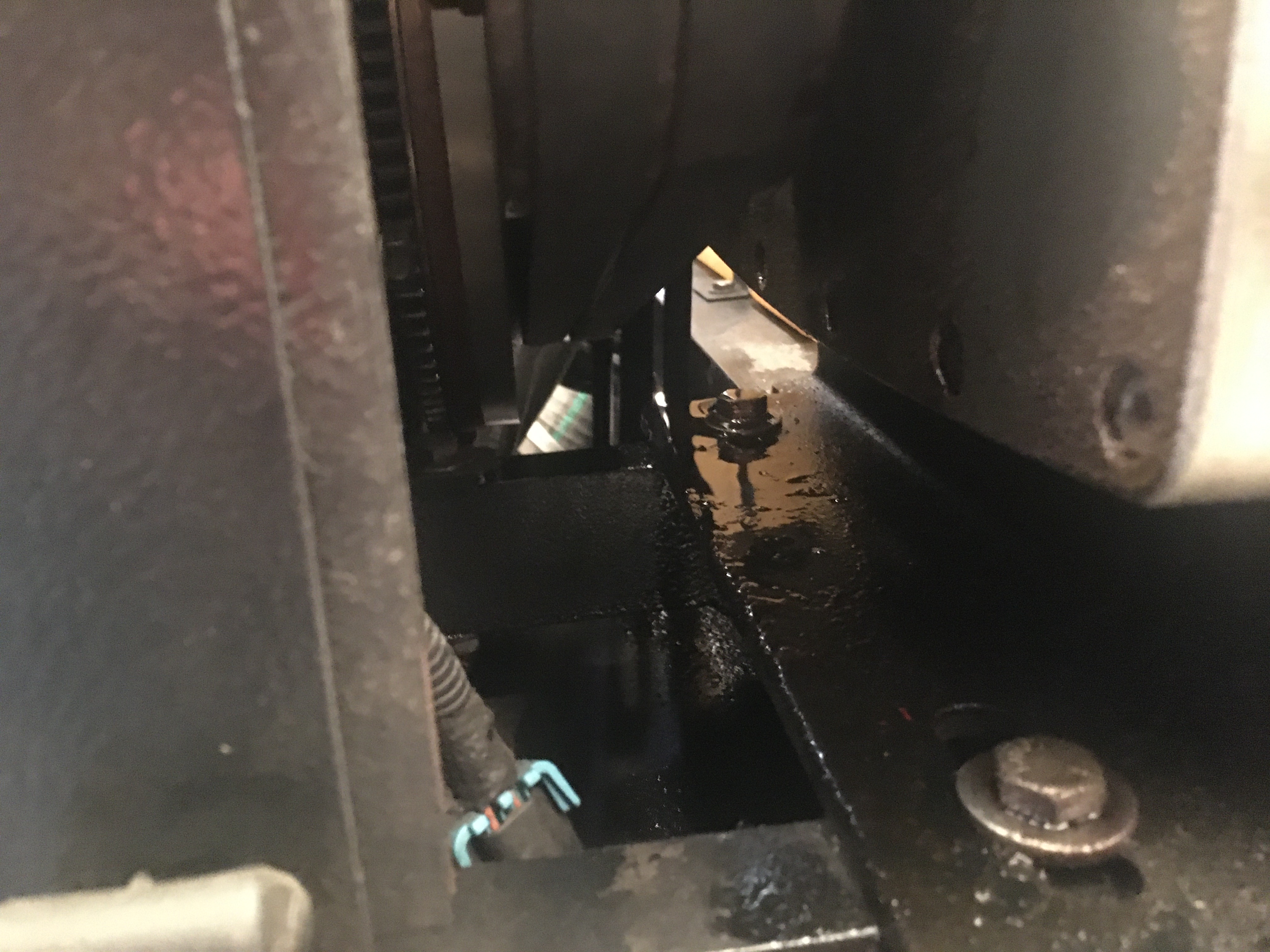

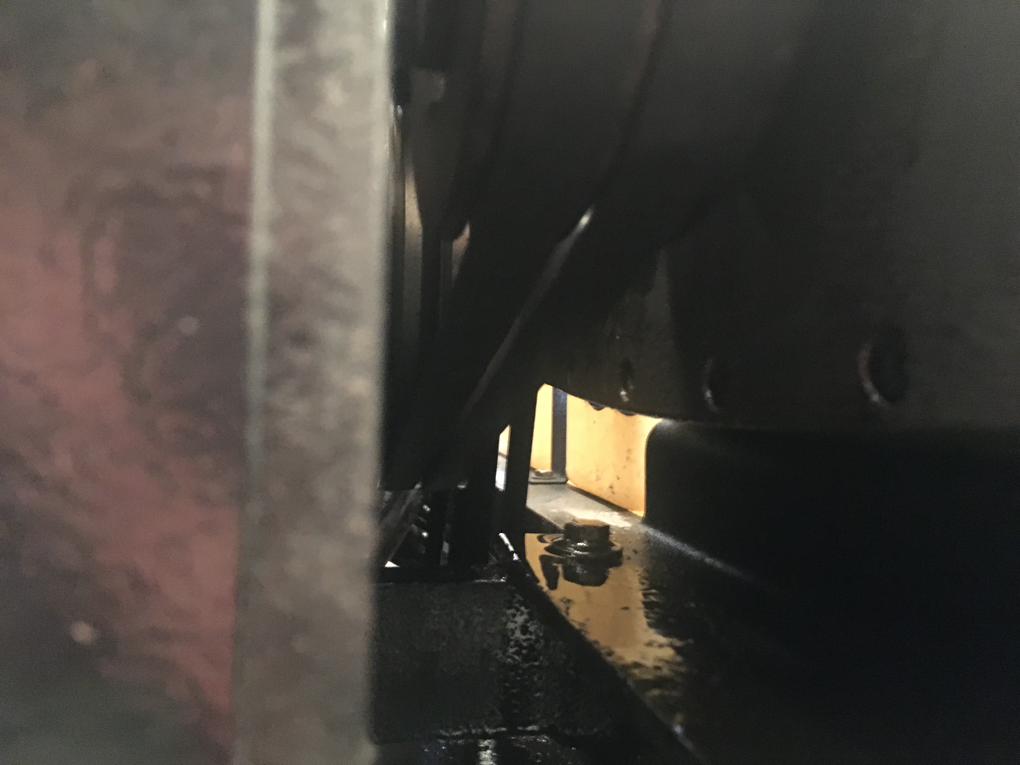

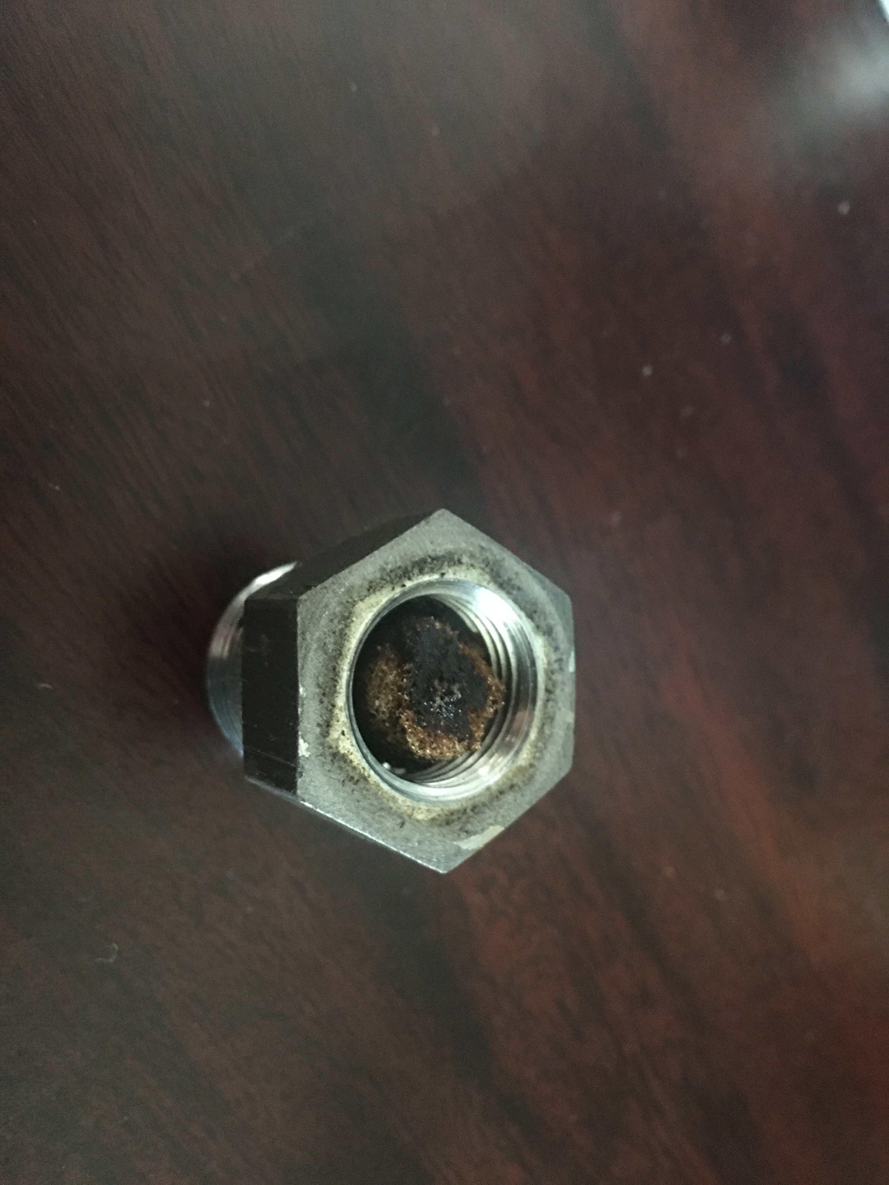

Two mechanics told me we shouldn’t need them. They cause our blowers to overheat like mine did today and blew an oil seal around the pulley shaft.
So I’ll be pulling out that foam I packed in there and see if it helps stay at a better maintained temp.

Are those blower mechanics? Are you sure you didn't overfill the blower oil? If it's factory designed, it shouldn't be causing any issues.

You need to see if others are having the same issue. Seems unlikely that the filter would cause that problem unless it was clogged.

Its there to allow air in and out with temp fluctuations, and hopefully stop oil from getting contaminated, but shouldnt be getting such a fluctuation that it's pressurising anything..

It's called a breathing stone or a vent... It allows the heat and pressure to excape from the blower... If it gets plugged.. Or you take it off.. The blower will run hotter and build back pressure and blow out the seals.... No matter what anyone tells you.. It's a must to have and keep clean.....

What did you put on there? Any pics? Sounds like it clogged up
Just pulled it off. It wasn’t clogged up. That’s the foam I put in there. When I blew air in the hole, I heard it go through

Something else to consider ... If your belts are to tight then you are putting to much pressure on the blower shaft and that will cause the seal to egg shape and blow out..
1/4”-1/2” of flex
