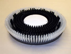

This will cut your per-spray cost by 50% and increase the quality of the job.
I'd love to, Les.
Problem is, not all of them will pay extra for a roto scrub.
So nuking it becomes more cost effective
