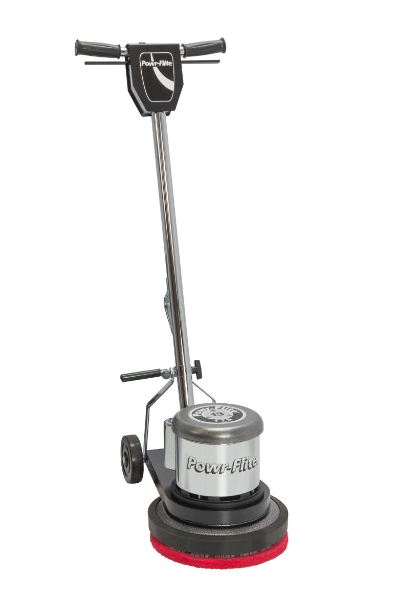

With this 13" turd, a loopy bonnet, some OMS and an auto dealership glue down..
the HWE only is a hard mindset to break...
Next came a CRB, a Cimex, 5 or so OPs and finally the WGCCM; the PHX

Yea 175 and bonnet. Joey Picket, Bob Bonwell both were pushing us to try it in the mid 80's.
It looked ok but didn't make sense when HWE was so easy.

I used one of Geurkink's old blue machines that needed to be kick started every time cuz it was so underpowered. How did he use that POS for so many years? Worked okay, though. Worked much better with a motor upgrade. Memories. Yeah, we constantly upgraded our low moisture system until we got the WGCCM--PHX!

Started with rotary foam shampoo. At times I used a 175 and bonnet with Deep Action from Hillyard chemicals. Worked great if you could tolerate the fumes.

I used a 13 inch 175 machine as well. Still have and use it often. did a lot of reading on the IICRC board, had my local distr. order me some bonnets those green stripe ones. Since they did not CONDONE other methods .and stock such blasphemous, ungodly stuff. !!! LOL!
Also , ordered some of those flat bonnets and juice from Argosheen!!
Was not satisfied at all , until, I ran across a used CCS machine here, and got with it a bunch of Glads.
Which to me was the game changer. ,, the bonnets. , not neccessarily the machine. though I still use it.
rotary bonnet early 90s with bonnet juices and lighter fluid (Argosheen)
JohnGee red Conquer early '00s
sCum 'n run encRap about the same time with rotary and VCT pads
