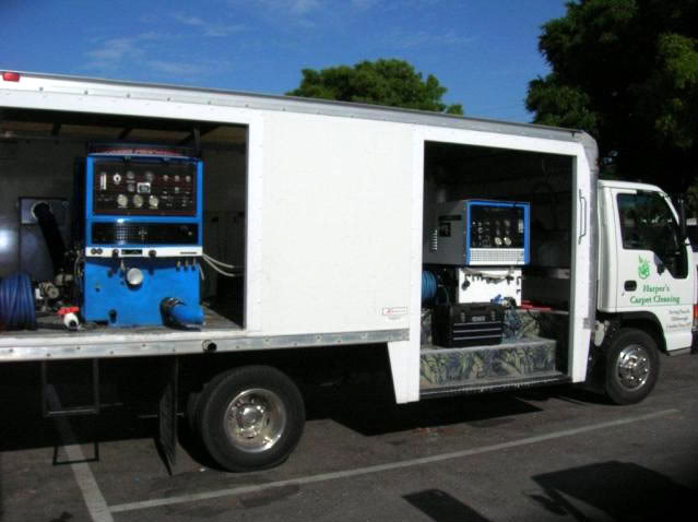

Here is a pic of our unit...
Ps. We are currently looking to add another dual TM..to our company...My son wants to build another unit using a Isuzu HD.."4 door truck"... :shock:
I would like to hear more about it, both about your current setup and possibly the future truck.

Probably the best testimonial to the concept of the set-up is.....my son "Joey" chooses
to only use this TRUCK..! He lets the other crew take the NEW Isuzu with the Everest HP.
The only "CON " that I can possibly think of is ..the extra weight & a little more fuel...!
Here is a Few of the .."PRO'S...
1. It is a "TRUE"...dual wand ...TM
2. Production TIMES..are scary
3. You can MATCH the equipment to the job..EVERYTIME
4. The Men never get tired.."3" guys are always giving each other breaks
5. Great quality control & customer service with an OWNER always on the job
6. One unit can be cleaning tile @ 1000 psi..while the other unit is cleaning upholstery
7. The time savings allows us the ability to add 2 or 3 extra jobs a day..And still be on time.
8. The HOURS on the units are units are literally CUT in 1/2.
9. The LABOR COST..actually go down due to the time savings of two units operating
10. If one unit has a mechanical failure...you are STILL able to finish the JOB.
I can go on & on...!!!!!
ps...With so many USED units on the market.."CHEAP" You can own 2 units for the price of
one NEW unit... !gotcha! You always have your "BACK-UP" truck with you... :idea: A backup
van sitting on the YARD is costing you $$$$$ everyday.. :x we all know the worst enemy of
any TM is to sit IDLE...They need to RUN...!!!!
pss..There are a LOT of great minds on this BOARD...If you feel there are any "CON'S" that
you can SEE, Please list them...!!! We can discuss your IDEAS... 8)

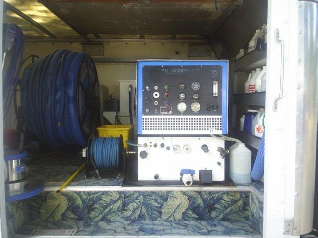

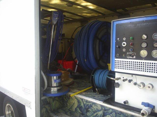

Both units have APO's, and independent Electric hose reels, and live hose reels..200 gal
freshy tank and a 35 gal metering tank for emergency water..

Ok Harper I see some 2.5 inch hose on those reels. How do you have them setup and what lengths?

Mr Harper- Do I see a gardenhose on the vachose reel? Do you guys store it up there and everytime you set up for the job you just pull the first set of vac hose down with the gardenhose?
This may be a good space saver for me to get rid of a garden hose reel....
Yes....
It eliminated an extra solution reel on the floor... !gotcha!

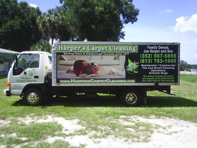

Harper,
Here's the picture in larger format you posted.
They sure look nice.
