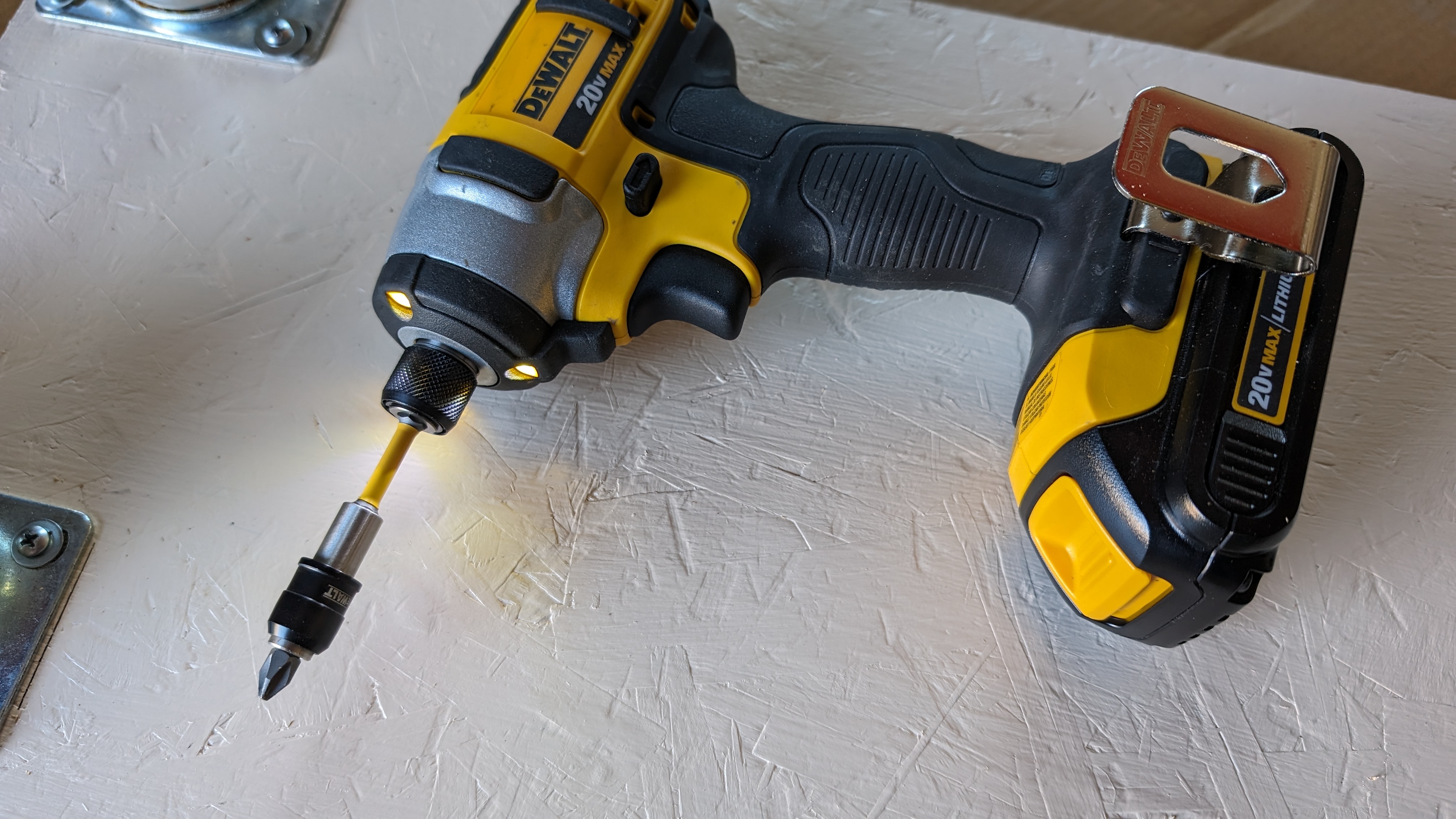

I guess I could still use a left handed screwdriver.... PXL_20231019_203146377.jpg
