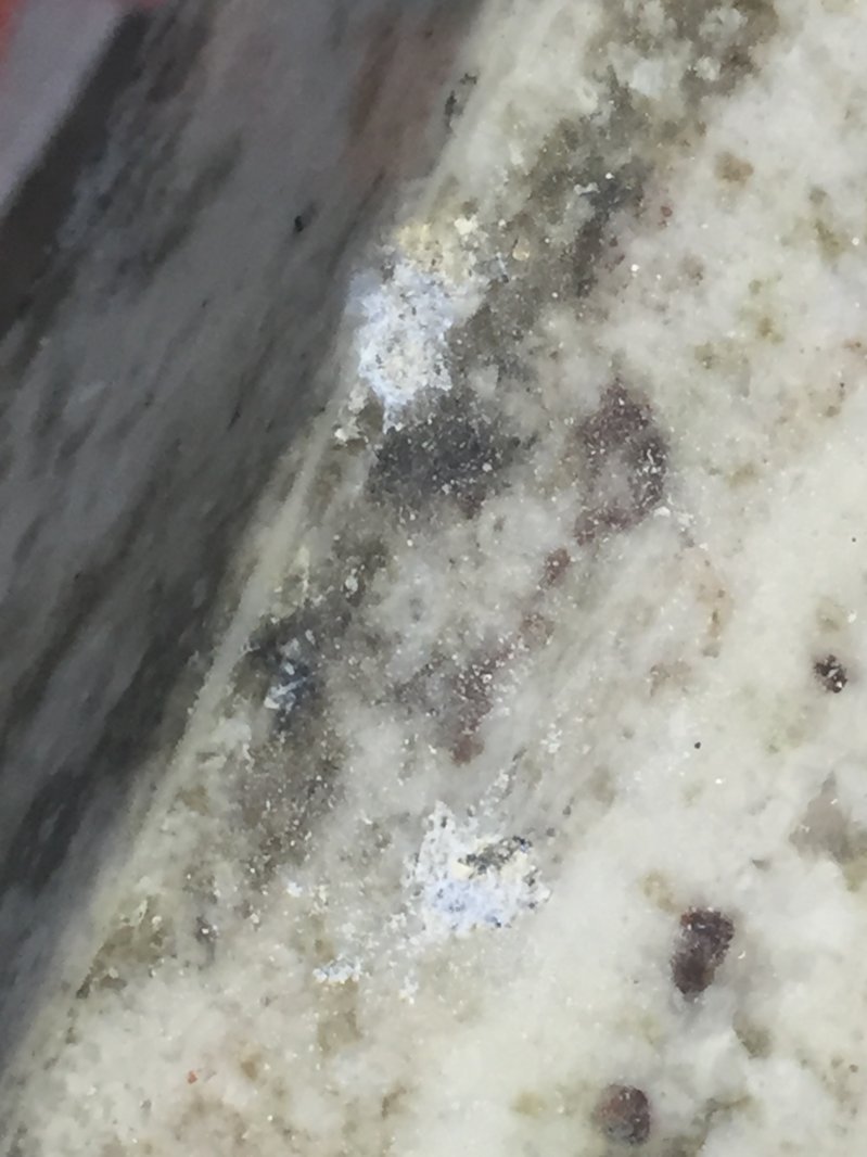

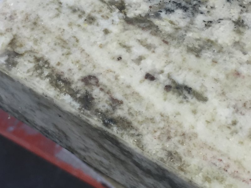

Here is FillaChip used on a granite top. Some shaved ape did the job, proving it is nearly Coastie..
I mean a monkey proof process.
