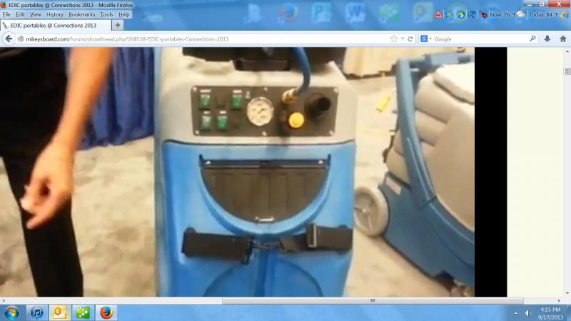

That machine looks to be setup backwards a large waste water opening and a small solution opening. It will make it difficult to pour into, I'd much rather have a large solution and a smaller waste opening. Plus the water water sits on top of the clean water? I would think that would make it top heavy when waste water is up top?

Hello Doc,
Thank you for the feedback. I took a few pictures on my phone so that you could more clearly see the openings (from the top) as the video makes it a bit hard to judge. The front opening (solution tank) is actually slightly larger than the waste water opening and can easily accommodate a standard 5 gallon bucket with no mess. The back port is quite large but that was by design, we wanted the operator to be able to easily access the float cage without having to struggle to get their hand in.
As far as the waste water sitting on top of the clean water; The front tank holds the clean water and the rear tank is for waste recovery. They are side by side but not on top of each other.

This is the unit that I feel could be a problem. I like the unit just if I were to purchase it I'd want one with a larger fill opening.
