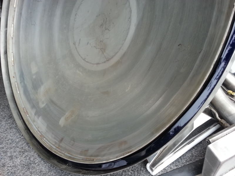

Waste tank lid.
That black gasket goes bad eventually. never hear of any end user being able to redo it themselves so all sorts of Fenstermakerish hillybilly seals have been created over the years.
AT has a refurb swap out program that I finally took advantage of.

Nice. I'll check mine out when I'm back from vacation

You fill that groove with black polyurethane and it will last forever.
Gene
