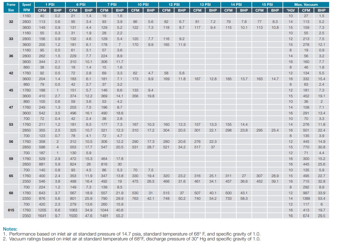

what hp engine would is best for #4, 5 or #6 blower? Why or why not?
I see tm’s built with 20hp and a bit higher hp engines with # 4 or sometimes higher blower and wonder if the blower is at all being utilized to its peak performance with a low/mid range hp engine.
Roots (see last 3 columns)
88245

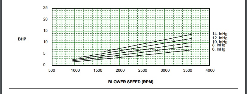

Roots 45 DSL up to 14" (the jump to 15" in the above chart may be misleading as to what is needed at the more standard 14")

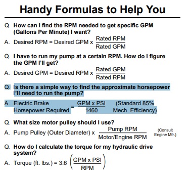

Cat cp pump
88246
Then add the pump, account for drive losses, exhaust plumbing (both), and the actual hp of the engine at any given rpm
