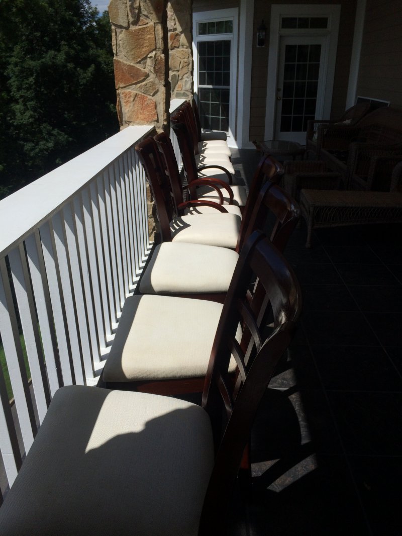

I knew that too much moisture would be an issue when cleaning these.

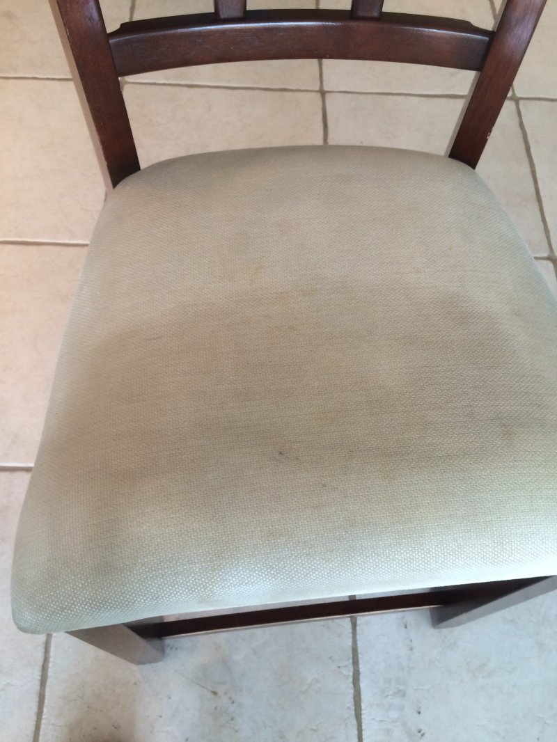

Four of them looked like someone had previously tried to use a Rug Doc on it......
Not all of it was what I'd call BAD as far as cleaning.
Dri Tools by any MFG come in SUPER handy in cases like these.........
Had Fun Cleaning these....
The 4 High Chairs had Obvious Browning from a previous cleaning attempt.
Thanks To Mike and You All...... I knew how to deal with it, and make it acceptable to the clients..
40Vol and Sunshine : )
