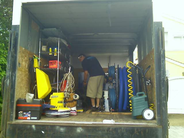

The V had to go in for new shock and a lube and tune so my new to me SW Legacy 2100 with only 58 hours got it's first work out.
Some notes:
Single wanding sucks. We got off @ seven and lost a small job when we would have completed them all and been done by 5pm w/ the V.
Non electric reels are for you guys who do two jobs a day.
The 3/8ths hose was easy to wand with and delivered tremendous heat to my 012 wand but rolling it up on a reel is for guys who do 2 jobs a day.
Vac and pressure reels in the back of the truck, four feet in should be against the law.
I think I'll ditch the pressure hose reels.
2.5 straight to the top of the tank ala' a GG elbow, creates plenty of suck for single wanding. Best I've ever experienced with a 45 blower.
My V does not get this hot even in single mode.
Vapor lock is fun.
I am wondering if I'll ever get use to that nasty heat and stench that blows all over me all day long.
I am wondering if my customers will ever get use to that nasty heat and stench that blows all over them all day long.
A truck mount with out a fresh tank is like a wife with out..
Why did SW not put a ball valve for the fresh Water QC?
Where is the hot water convenience hose?
I feel ashamed in a ratty unmarked truck.
Even this pos 1989 Ford with over 400,000 miles on it drives better than the UD.
But it has horrible blind spots and backing up is a game of Russian Roulette.
Check valved TI wands makes some crazy ass noises when blasting that kind of heat.
It's temperature gage is not accurate.
Inch and a half whips are for scrawny 98 pound Minnesotans.
None the less, it sure was nice to make $1500 while my V was out of commission

you realize you can unbolt those and slide them out???? :roll:

There not capri's, there called MANPRI's. I hear they are Very poplar in Europe, along with crocs. :| Nice Box truck except ya need to push those hose reels back 4 ft towards the back of the truck. Oh ya know that, NEVER MIND. :oops:
it just needs set up right, Ron.
Mike bought it from hOtEL mANager, not an efficient set up CCer.

Forget the MANPRI pants and focus on the snappy upscale T-Shirt!
117,265
Thats my helper ya idiots.
Those are Dickies work shorts.
He is just a short little fella so they look long.
