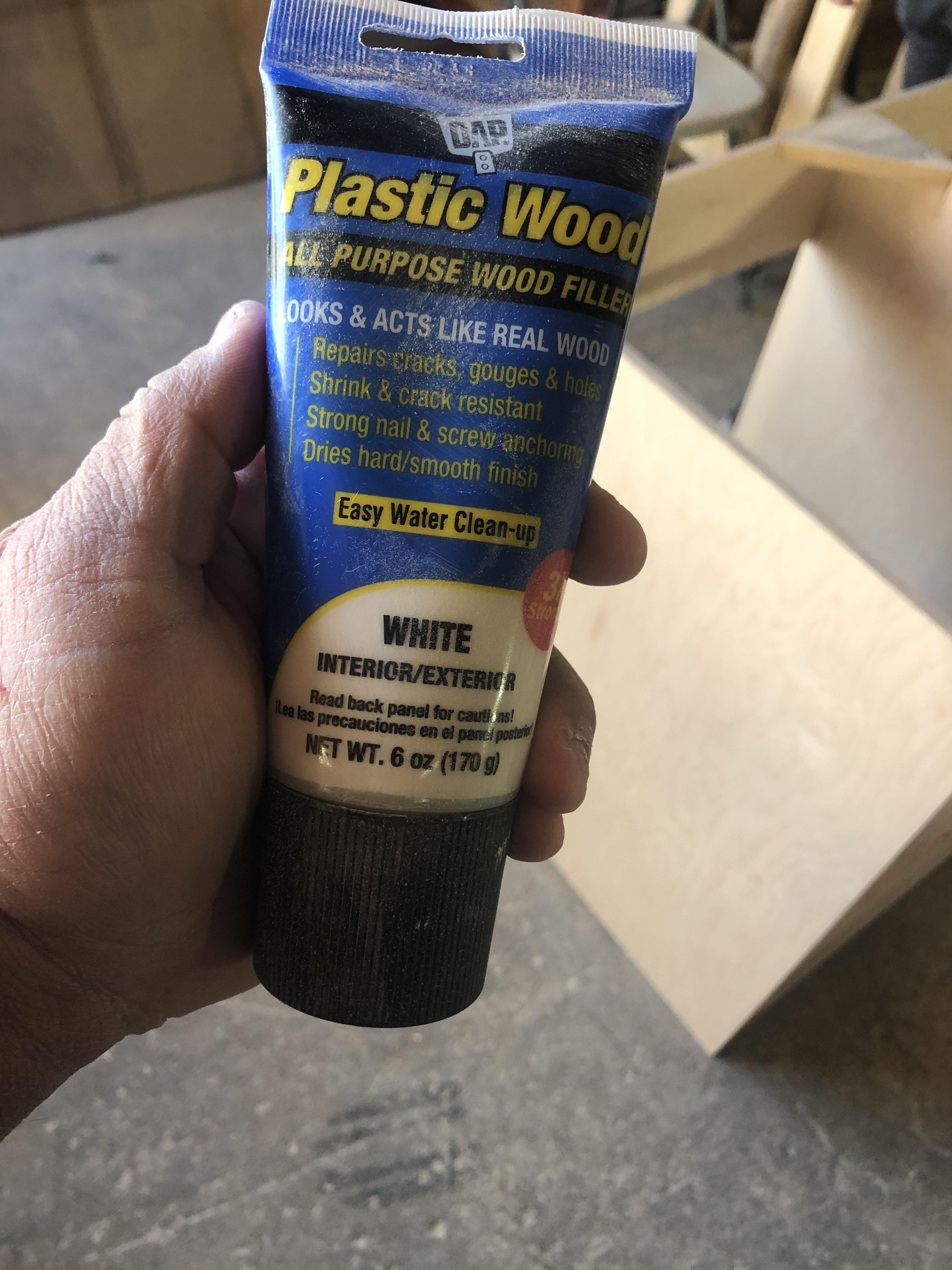

Wont shrink or crack, so they say
We use that on our cabinets as filler. Not designed for huge openings. You’ll need to sand it to get it even though. Let me find the one that might work better but this one gets hard and like Larry asked if it has a lot of movement it will crack. This stuff in the tube applies like a caulk and is easier to manipulate. Other stuff is like a hard clay
edit** we’re using this one one paint grade so white doesn’t matter. They do have other colors and I believe the natural one is stainable
