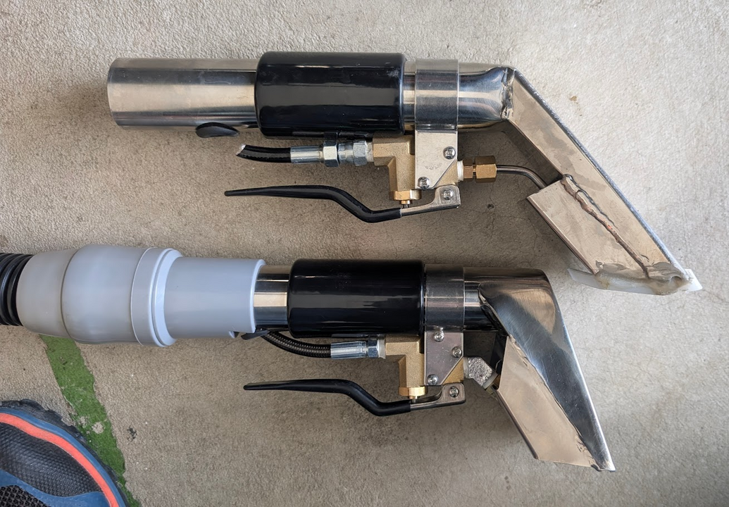

116,997
top was the first body I worked with, bottom is what everyone loves...
