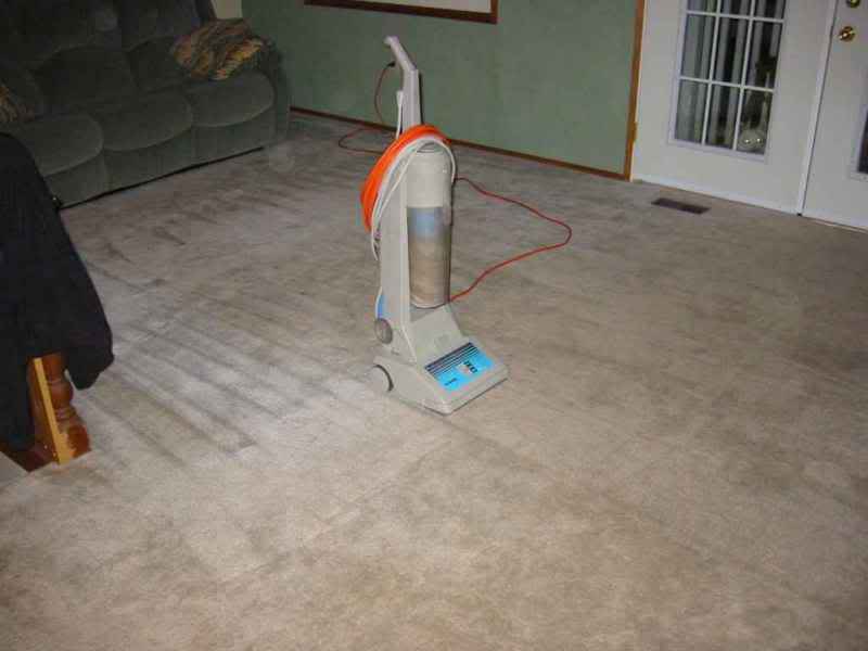

this was in a 3 year old wool wall to wall in a master bedroom about 1,000 Sq ft. on the second floor and they have a full time house keeper that vacuumes weekly and pre vac'd before we got there.
always pre-vac

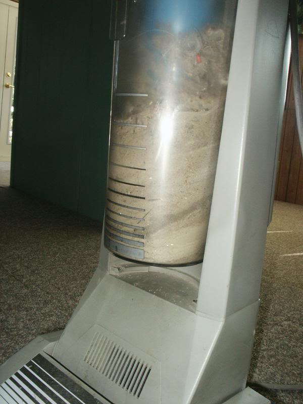

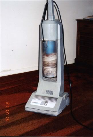

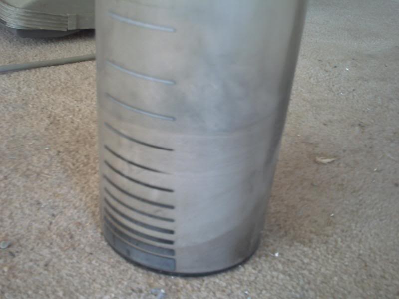

Prevacuumed by the home owner, 14 canisters removed from ONE living room, about 200sf

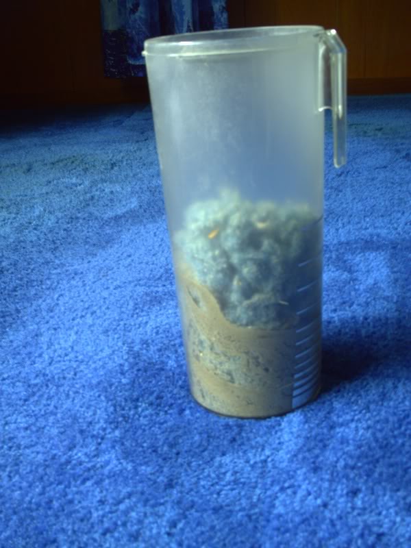

ONE bedroom and one hall, less than 200sf total
already prevacuumed by the owner

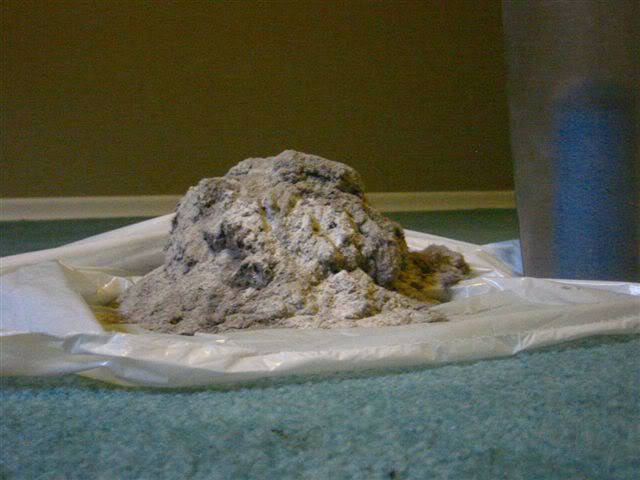

this living room, removed 3+ canisters of sand
various jobs, some prevac's, some not

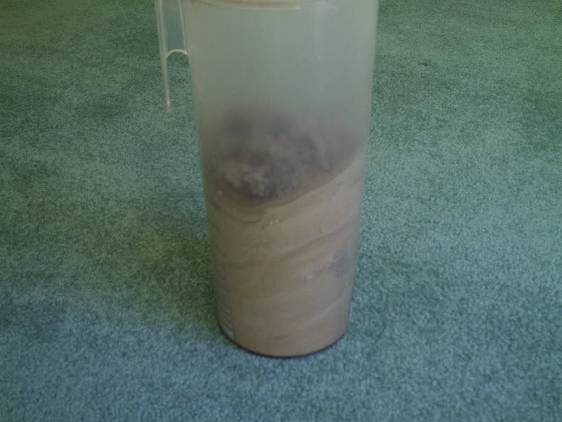

100sf bedroom, prevacuumed by homeowner
From my turtle video

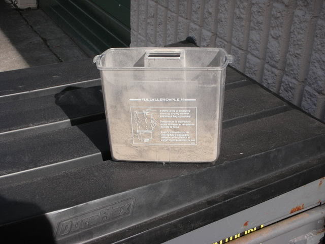

one a about 6 canisters, dirt and gyprock dust
steve said:
Yep. That pre-vac thing is so over-rated. It like 1970 ish . It's mainly for the people that don't know how to clean, or who have like one job a day.
FLYERMAN said:
Prevacuuming is basic brainwashing. If you won't clean a carpet without prevacuuming it then you're brainwashed. That is not alltogether a bad thing but it is a little extreme.
I never and I mean never prevac. I let the customer do it and give them the discount. They love me for it.
Ken Raddon.
CleanEvolve said:
It's pretty simple... If the carpets need to be vacuumed, you vacuum them... if they don't, then you don't vacuum them. This isn't rocket science.
Overrated?? Are you kidding me??
Jerry's pictures may be a little off but he's dead on. If you don't vacuum the carpet you are only guessing as to how clean you've got it. It may look clean, hell, the B&S cleaners can do that, but there could be enough soil in there to choke you're blower and you, the "professional" have no clue.

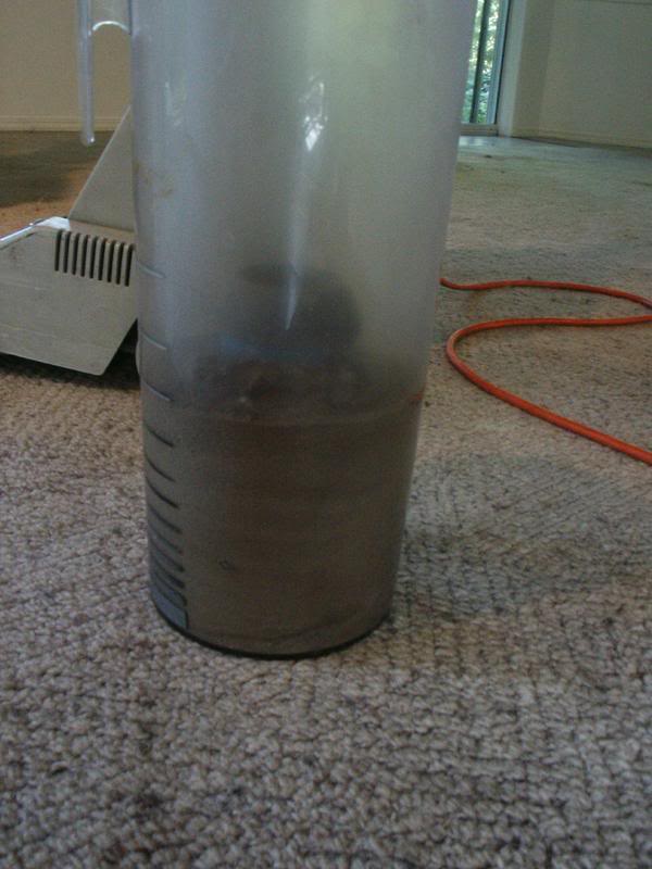

Look at this pic:
the bottom layer of soil, about 1/2-1" high came from a 6ft longx 3' wide area from the top of the stairs to the kitchen entrance. The thinner middle layer came in from 2 other bedrooms, the remainder came from the MasterBR.
House is less than a year old, homeowner vacuumed before I got there with a built in with an air turbine power head.
I've been surprised too many times. I never know whats IN the carpet from looking at it.
