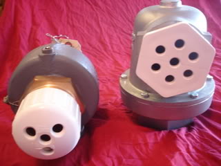

Back when I was trying to get our old slide in (with a 25hp engine) to drive a 47 blower at a decent lift level, I did just what Nick is talking about, by putting some tape over a few of teh relief holes on the spring relief.
Later, (and still to this day) on more powerful units we did this with the kunkle and bayco valves:
The drilled caps really dial the valves in, and quiet the actuation a bit in the process, as well as serve as a crude debris screen for foreign matter.
But to claim the free flow out performs a kunkle on a healthy system is just plain wishful thinking.
