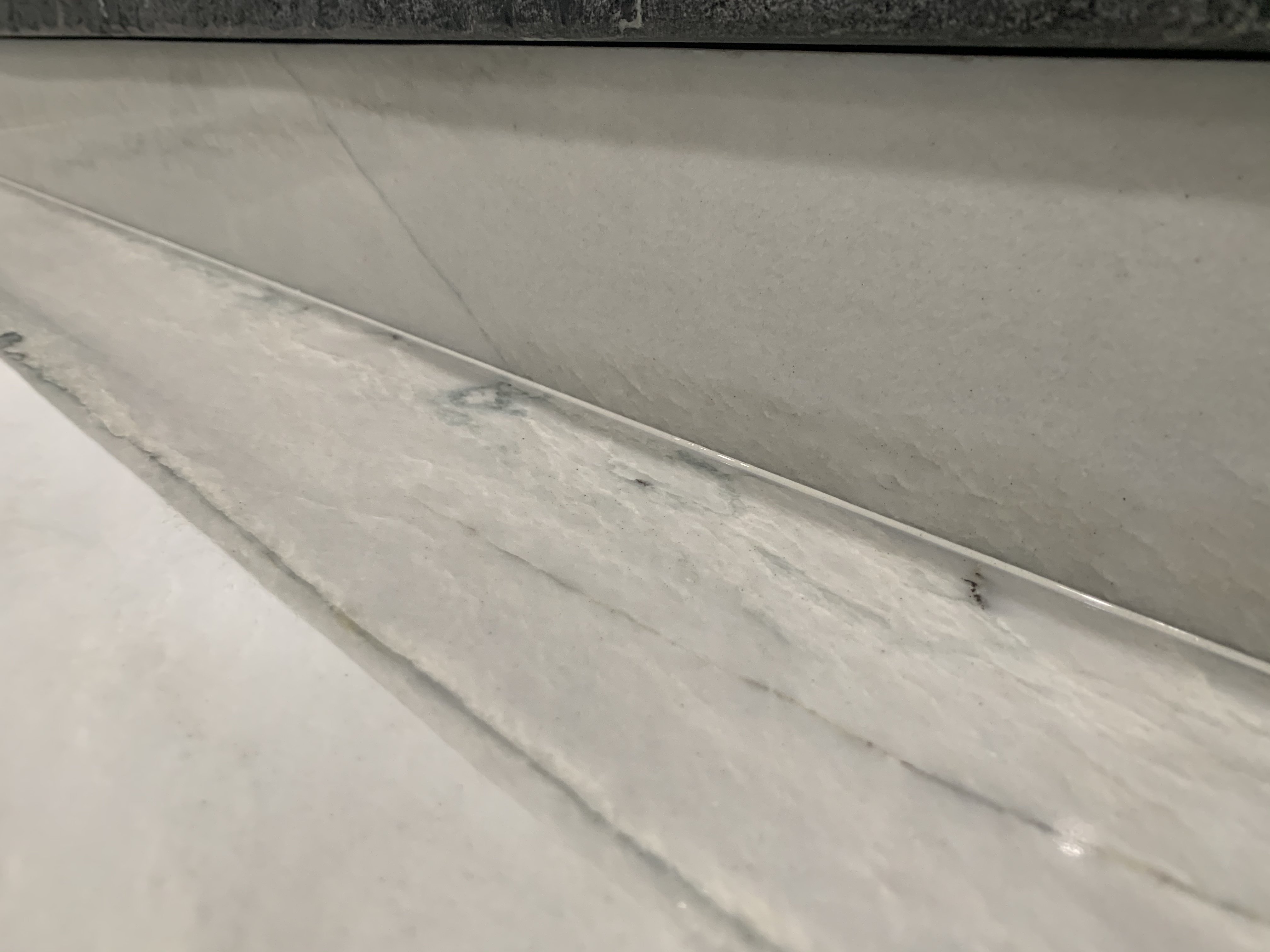

This granite was only 2 -3 yrs old and had a nice reflectivity, but the customer noticed that it would darken slightly after water sat on the edges around the sink.
When I inspected the stone and installation, I noticed that the backsplash grout had failed / separated, especially the backsplash area just behind the faucet.
This is an extremely important area to keep sealed water tight!
If water gets under the backsplash behind the sink faucet area, or at the sink seal itself, major damage can occur over time from what is called a “rod failure”.
Rod failure can and will cause the front sink edge or areas around the faucet sink edge to severely crack and actually fall apart !
However, that is a separate discussion for another time.....the key to stopping “ rod failure” is to keep the water from entering these sensitive areas.
This particular granite countertop needed a good cleaning, sealing, polishing, and re-seal the backsplash.
The customer was selling the home so they wanted to “brighten up” areas of the home for resale.
We would normally recommend using SGA to reseal the backsplash however, they were trying to keep the costs down so we used a “siliconized sanded grout caulking” instead.....we generally charge twice as much for SGA.
The granite re-conditioning consisted of a 5 step cleaning, sealing and polishing process.
I think the results speak for themselves and needless to say the customer was simply amazed and said....”It looks like new again”....actually it was better then new, but if the customer is happy, I’m happy too.
