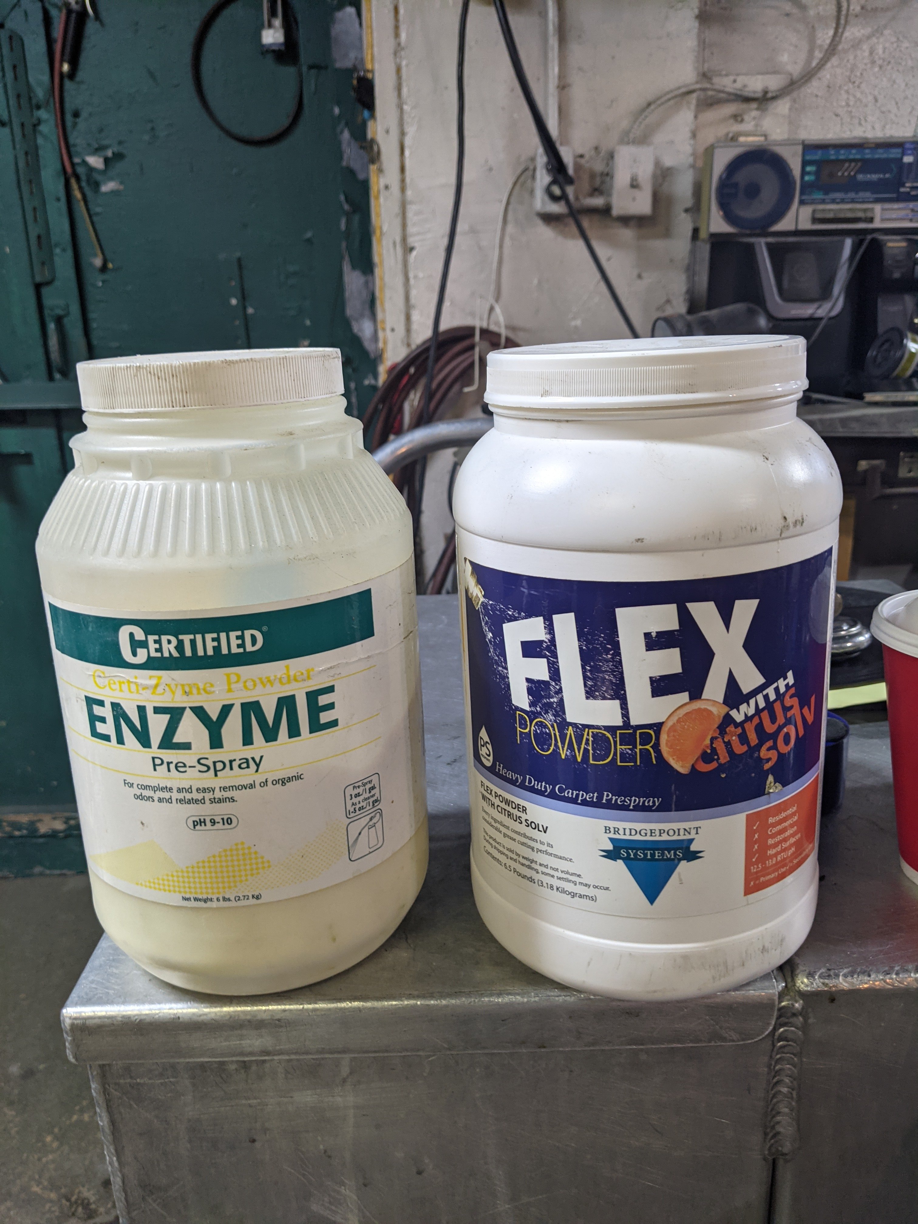

Bridgepoint has a product called Flex powder. Very strong and doesn't foam.
28,268
I would agree with that. I've used Enz All in the past. I don't do a lot of greasy restaurants any more.

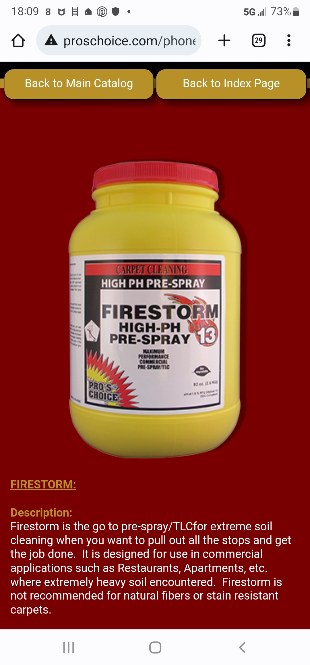

for grease I also recommend firestorm it is amazing. I have found that the heat is really the key and I wouldnt hesitate to use tsunami or a tile and grout cleaner for it.

Firestorm mixed a little heavy with the 175 and a aqua jiggle pad crushed it. Women that owns the resteraunt was amazed, two other cleaners have tried with no luck. Thanks for the good info......
