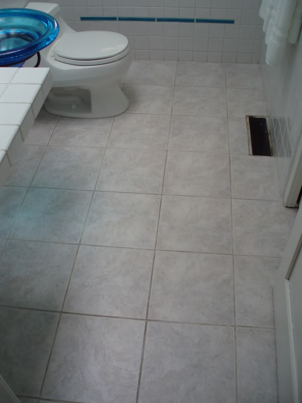

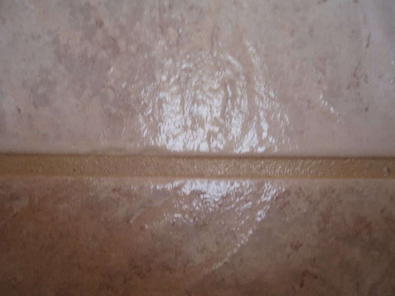

Can you tell this has been color sealed?
Not horrible but urine stained none the less.
B4
After

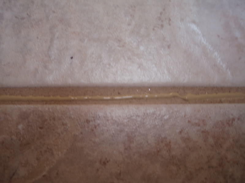

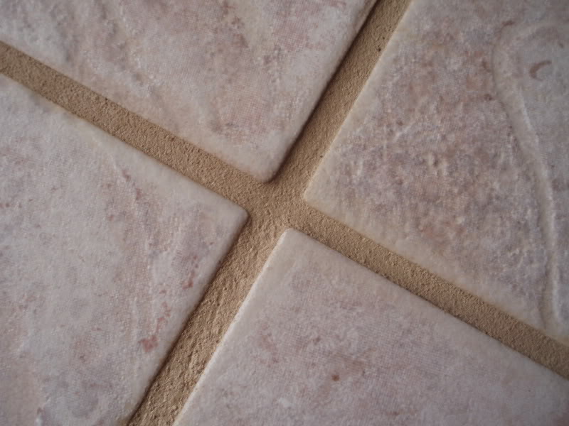

Apply a very thin line..

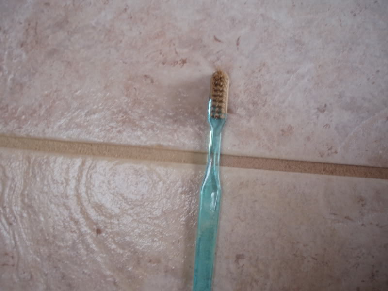

Scrub it in with a tooth brush..

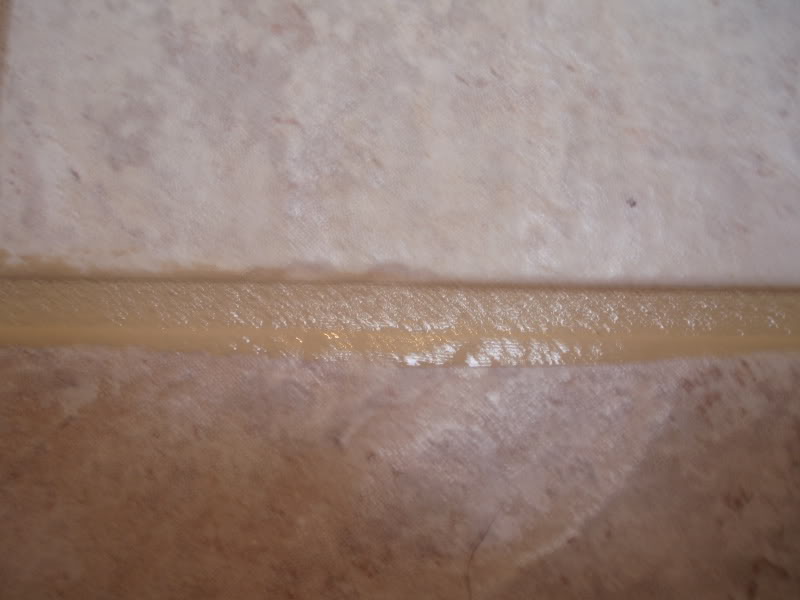

And wipe off!

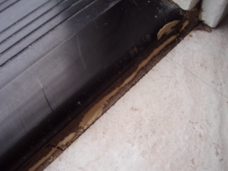

To the left is Color Sealed..

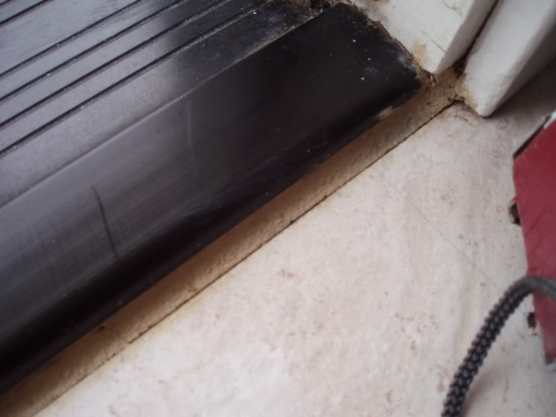

Nasty door jamb area full or Mop staining.
POW!
b4
after

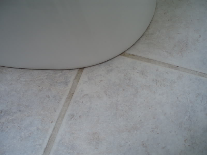

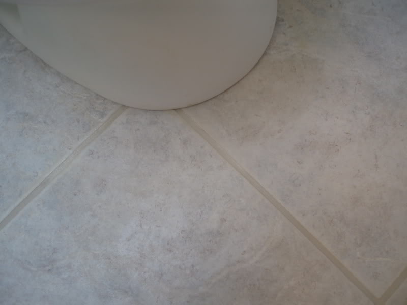

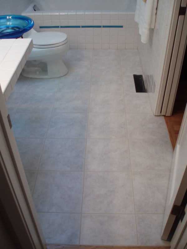

Here is a large job we just completed nearly 2000 sq feet I charged $5600 for two days work.
Before and After the darker line was cleaned it is red soil which will never come out color seal was the best option
So much furniture to move was giving me the sh...
The customer was so impressed with her floors she gave us a huge tip :wink:
